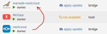

6 hours ago, reconstruction said:
I figure I can either do a MySQL and Apache/PHP docker or I can do an ubuntu server VM and run both on that.  Any suggestions there?  I'm a HTML/PHP newb, but will muddle through it over time (projects keep me sane!).... I have a few PHP buddies I can ping as time goes on - once the system is up and running.
I'm not sure what you're development level is at but starting at a simple level you should split your development into two parts.  Create a web server container and create a separate DB container.  A number of apps out there already use this approach (like NextCloud).

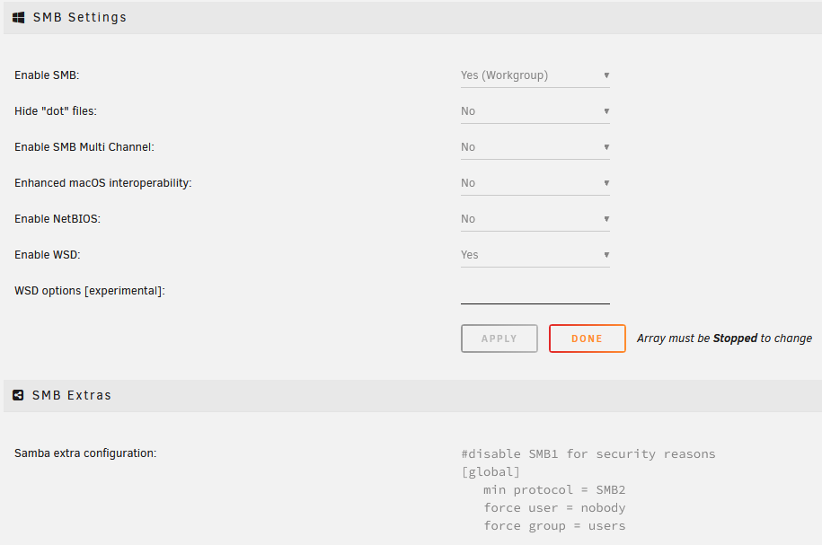

On 2/25/2023 at 12:04 PM, reconstruction said:
Created a mess of user accounts, a few shares/basic folder structure for everything.  Setup a Time Machine docker to keep my mac's happy - backed up very quick, that was nice.
I should've mentioned that the best thing to do when you're up and running is to plan out the shares and users BEFORE you create them.  Do this in Excel with users listed along the side and shares along the top then mark off which users need access to which share and what kind of access they need.  You might find a lot of duplication.  The more shares and users you have will mean more complication.  Also plan out why you need the shares and the users.  In my system I wanted somewhat open access to media (audio and video), more restricted access to family stuff, and a completely restricted "home" folder for each member in the family.  So, in the end, each user has their own share (private), there's a common share (private), and a media share (secure).
This is what my SMB settings look like:
I actually did that with pen and paper before I installed anything on the system. Figured out my file structure and user permissions.
i do wish there was a simple way to control sub folder permissions, but I can make things work as-is. Rather than have /ShareA/Folder1 and /Folder2…. I’m just dropping everything to the base level. More overall shares, but can still make it work.
