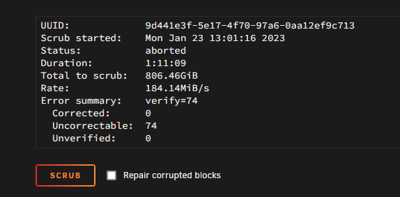

I followed the old procedure and scrubbed the drive, I instantly got 74 uncorrectable errors, but then none along the way (I attached a screenshot, it reads "aborted" but it went through, no idea). SMART valus seem fine, as it did in the past. I'm not sure if I can even find out what exactly the issue is.

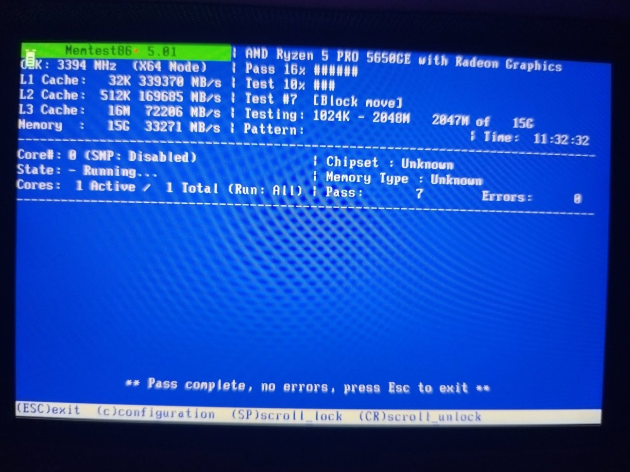

Good morning @philliphartmanjr
First, I attached a photo of the Memtest result. Looks not so bad for now :/
