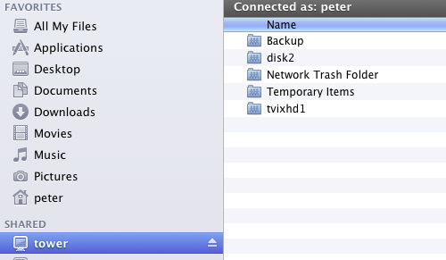

Yes in the log you have:
Jul 23 22:06:48 Warehouse13 afpd[19984]: AFP3.3 Login by nobody
This indicates guest access. When you click on the server in Finder, do you see a "connect as" button in the upper right of the window?  You can click on this to connect with your user name.

I cant see any AFP share in finder for "Tower", strange, I going to read previous post and see if someone else have this problem......  see picture attached.
My AFP share is named Timemachine and TimeMachine-LION
Any way, I going to make a  rebbot of Tower and see......
EDIT
Disabled SMB for the TimeMachine share so it's only are AFP on these, now it works.
