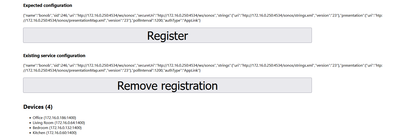

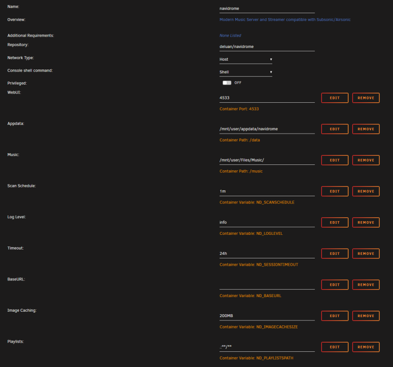

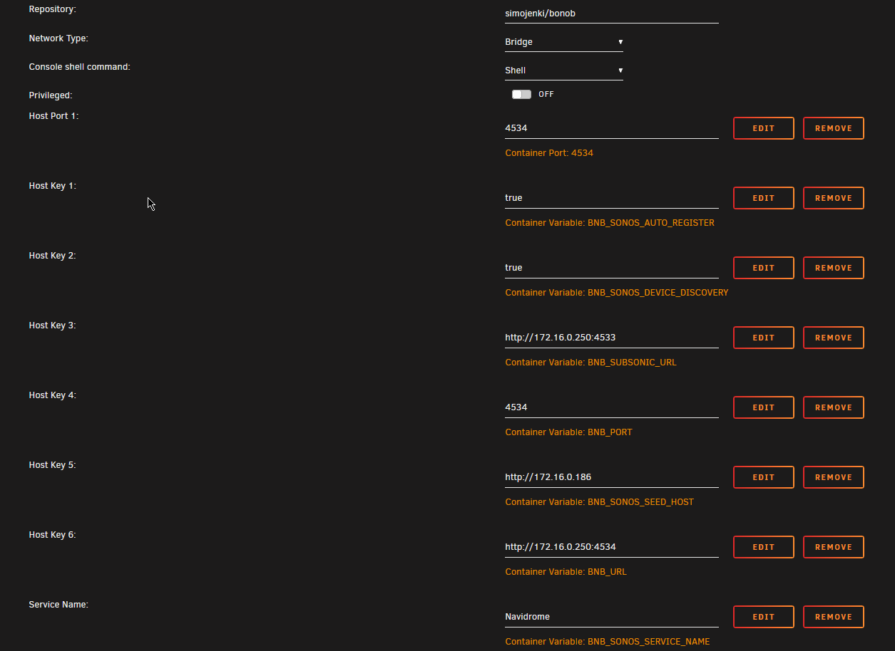

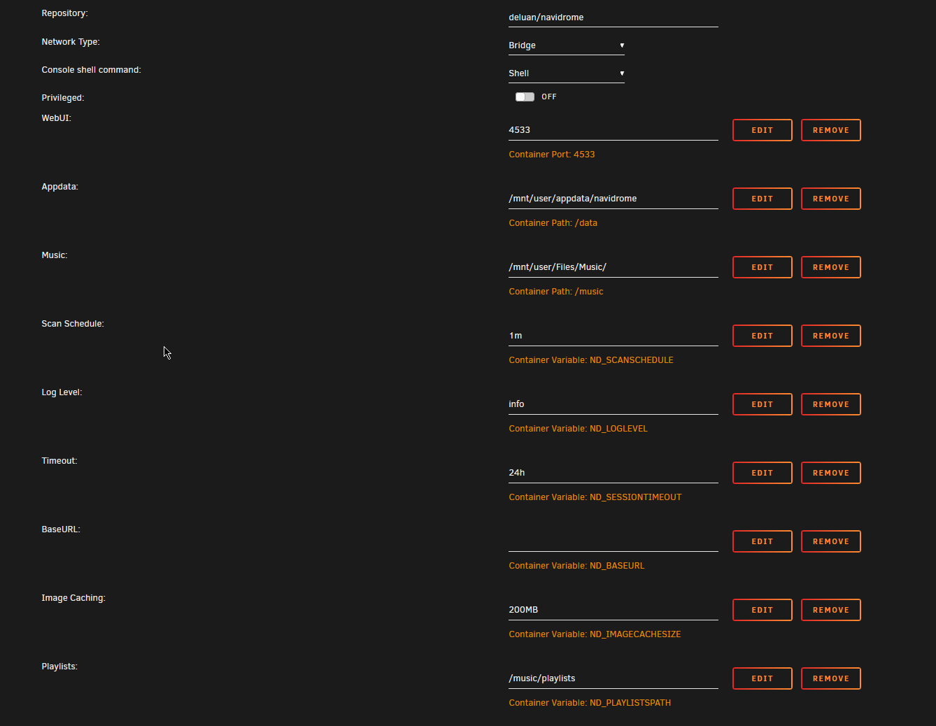

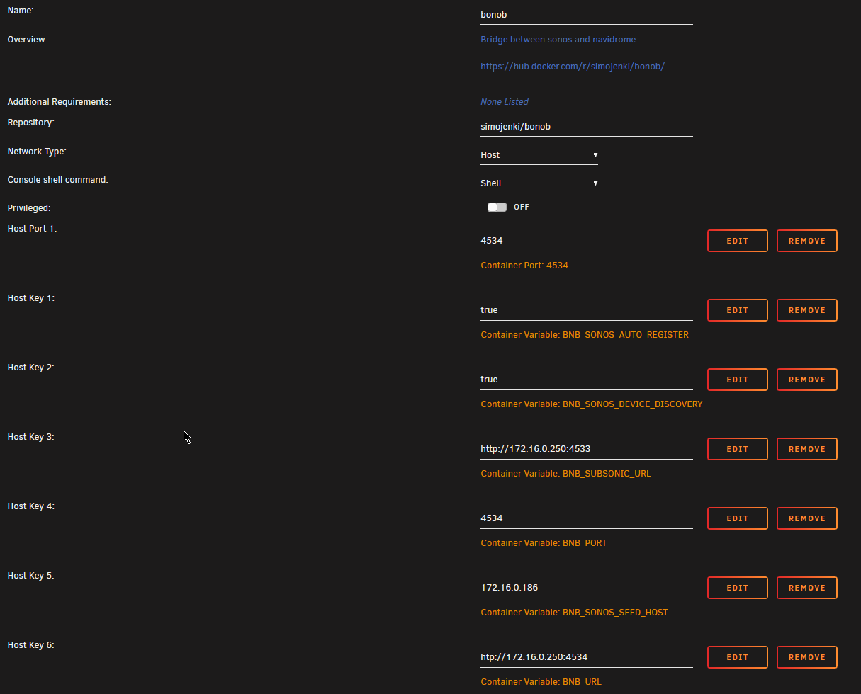

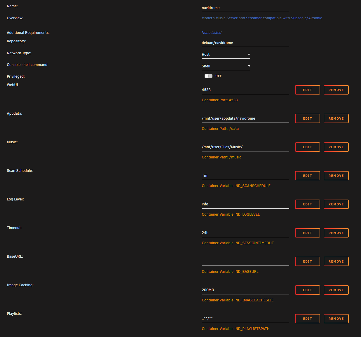

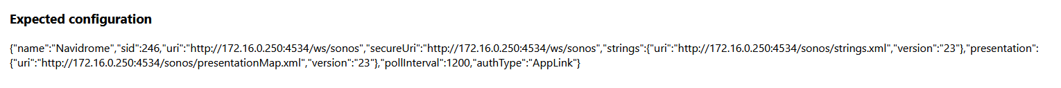

Hello! I'm trying to configure bobob to work with Navidrome and I'm not sure what the program is expecting. Here is the error when I pull up the web page:
My bobob config:
My Navidrome config:
Thanks!

It seems you are using your Docker network (class b - 172.16.x.x) in your config. Instead, use the IP of your Unraid instance / Navidrome instance (likely class c - 192.168.x.x) as BNB_SUBSONIC_URL (Key 3)  and the IP of one of your Sonos speakers as SEED_HOST (Key 5). Your BNB_URL (Key 6) should be your Unraid IP.
Thanks for the reply. The 172.16.x.x is class B but private and also the subnet for my LAN. Those are already set to my instance of unRAID. Also, no need to ever block out private IPs as they are not publicly routable.
Removing the http:// from the BNB_SONOS_SEED_HOST seems to have resolved it.
Edited by Keek Uras
I believe I have bonob set up correctly but I cannot connect to the service in Sonos. It tells me to "Check your network connection." Both the Sonos devices and unRAID are on the same LAN and the bonob service registered successfully. Both Navidrome & bobob are using host networking. I've tried bridge as well. Settings:
Any thoughts on what it might be?
