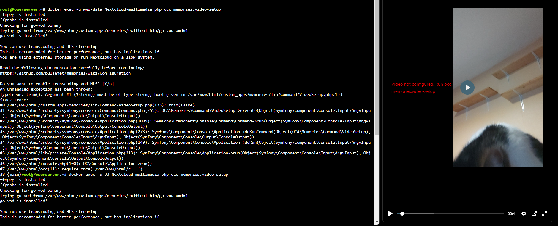

Good evening. I stumbled across an error.
Videos show me, that i have to run "occ memories:video-setup". When i execute it, the prompt for [Yes/No] ist skipped with nothing inserted automatically and runs into an error.
I attached a screenshot.
The Command i ran (from Unraid web-Shell): "docker exec -u 33 Nextcloud-multimedia php occ memories:video-setup"
If anyone knows how to handle this, i would be very thankful :)

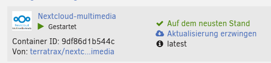

So I updated (thanks again) the container in unraid - but my nextcloud is still showing as needing to update? Unsure if there was something else I'm missing.
This dockerfile is based on nextcloud:stable-apache
as of writing this, nextcloud:stable-apache & production-apache tags are based on 25.0.5
Unraid isn't going to look at the dockerfile.  As long as the image is up to date it's happy.  Buy the docker updating in unraid is finicky. My guess is that this resolved on its own?
Right, but looks to me like your dockerfile is building from nextcloud:stable-apache and the stable-apache tag is Nextcloud version 25.0.5 right now.  (I'm assuming viviolay is referring to the update notice in the Nexcloud Dashboard, informing about version 26 & not the update notice on the Unraid Docker page)

Ah good point.  Yes 26 has not made it to stable yet and this image won't be 26 until it does.
If there's demand for 26 I can create another tag for it. Pretty easy work just let me know!

Oh yes, it did! I didn't realize because I ended up turning off the Nextcloud update reminder since it was annoying me at the time. I told myself I would come back to it later to figure out why it didn't update to 25.05. But then, after seeing your post - I checked again and realized it's now on 25.05. Not sure when it happened, but it's settled now :).
It is asking for 26 now, but I am happy with 25 right now re: apps and functionality. But am okay to upgrade whenever you think is best :)
Thanks again!

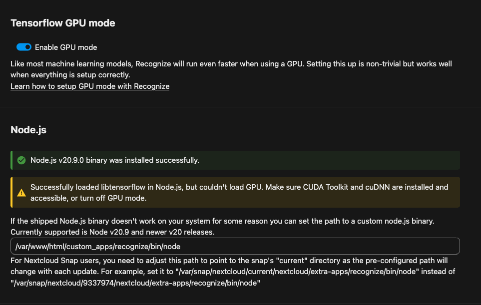

I think I have everything setup correctly minus HTTPS as I don't care with Nextcloud only available on internal and/or VPN.
I am stuck at facial recognition stuck at:
Faces scan started to work and saw the count going up. However, no faces found for either of 3 accounts. Any tips/tricks to offer?
