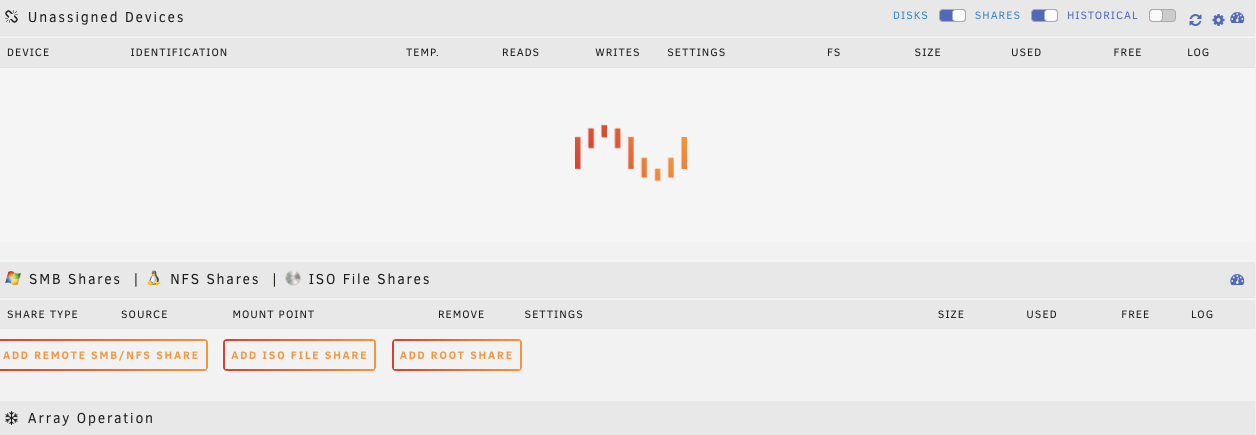

Hello everyone i don't have any dashboard on rc2 it's empty now edit : i just delete GPU stat plug in and everything is back
