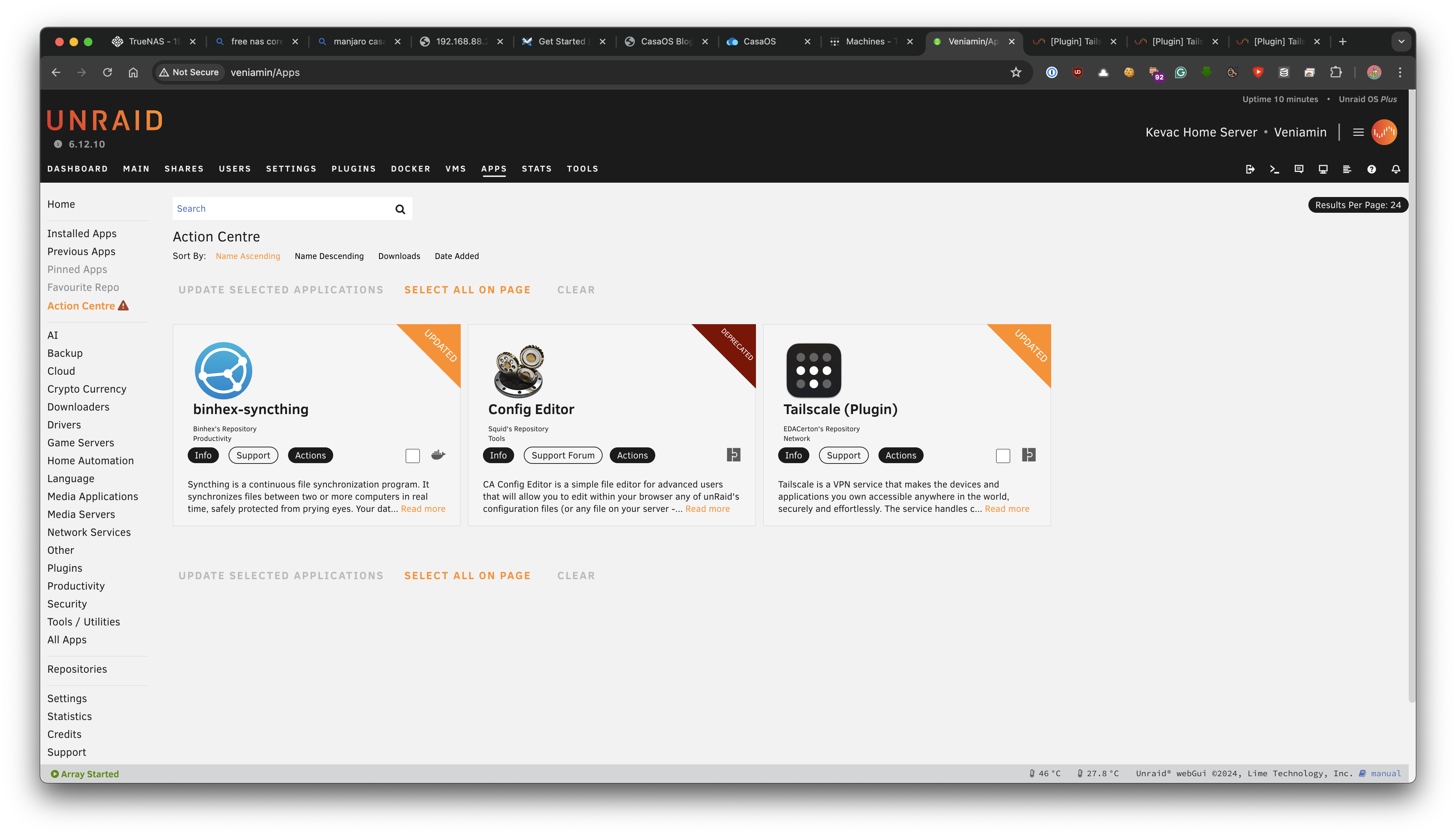

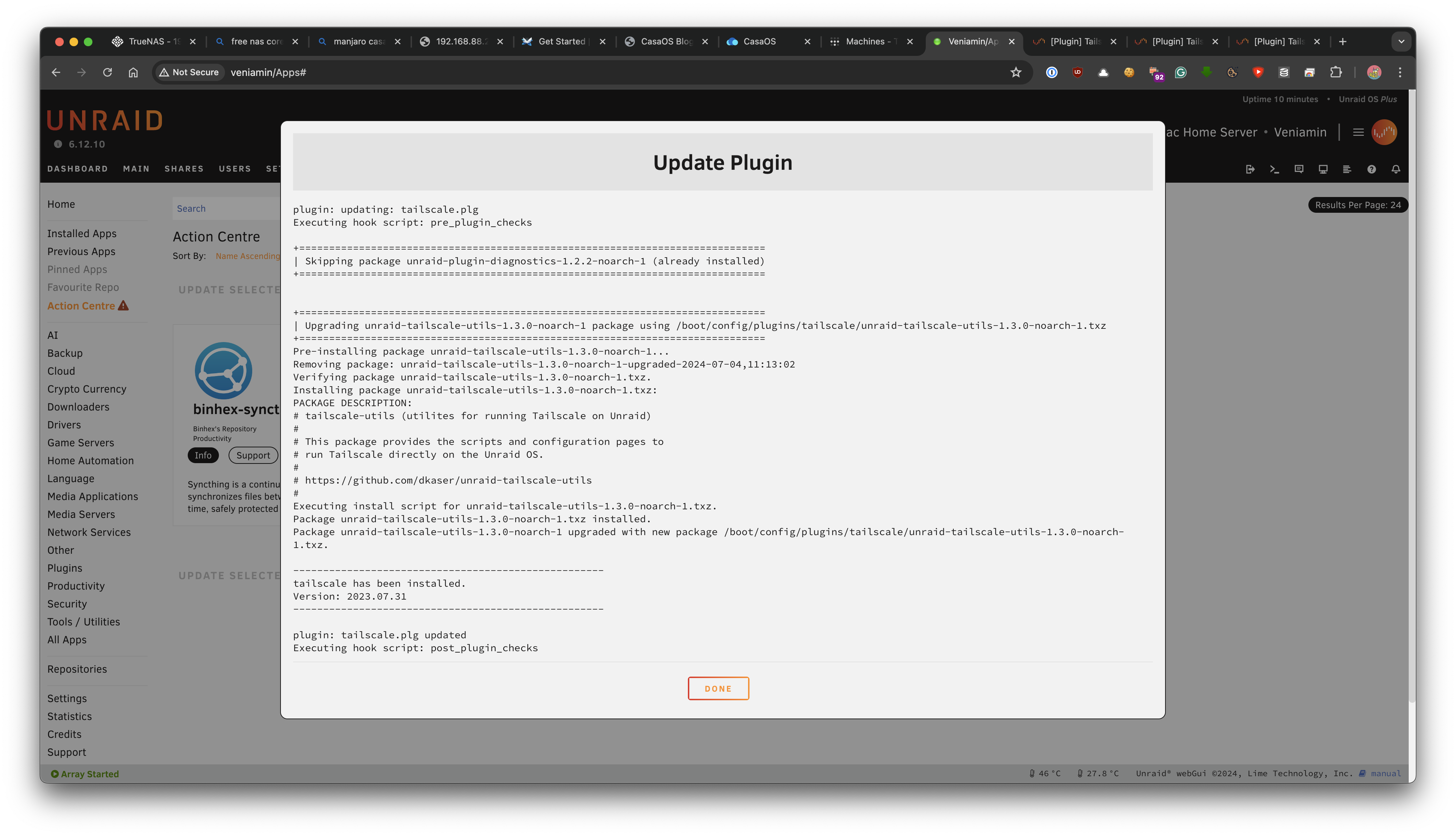

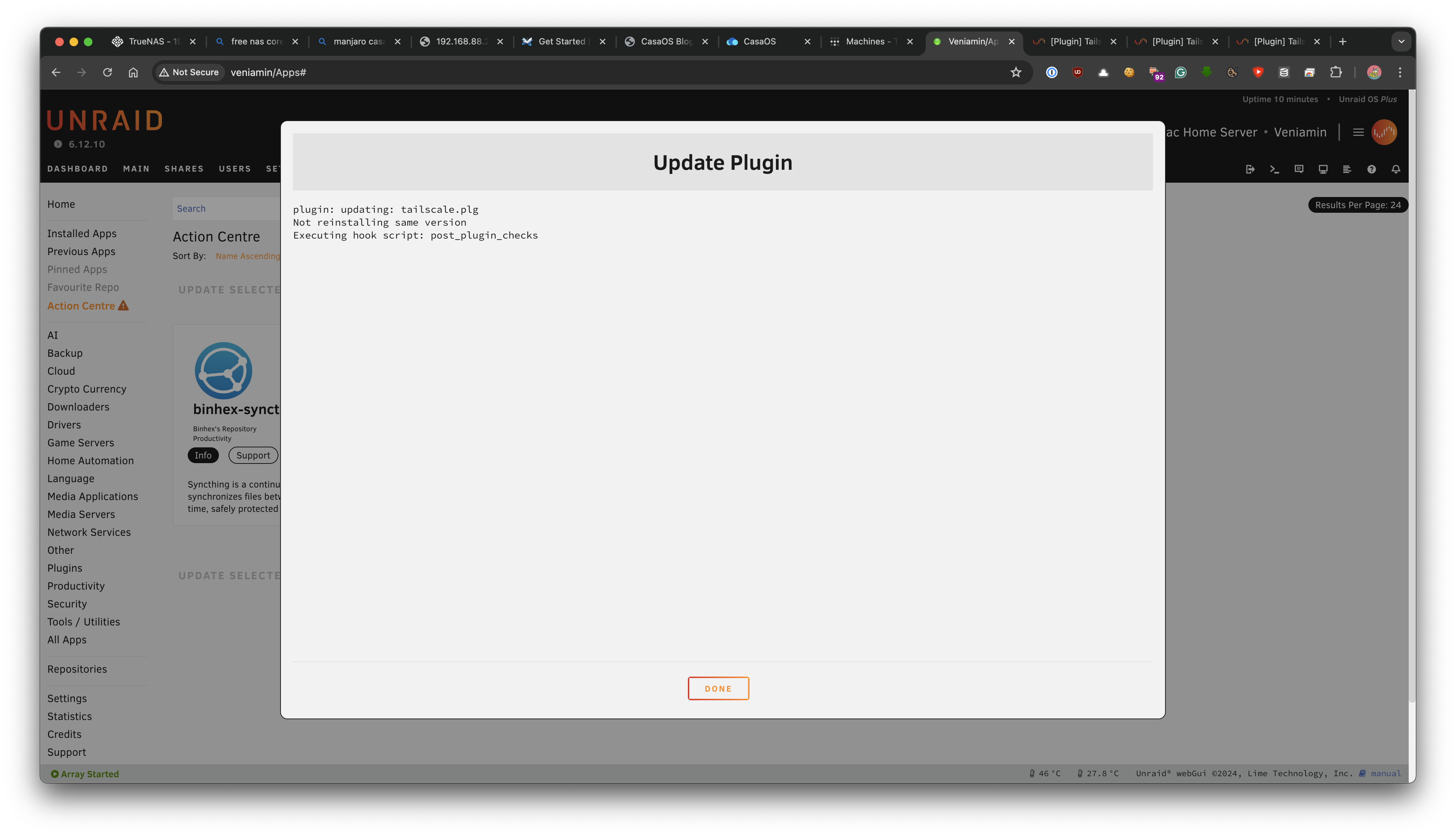

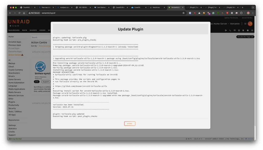

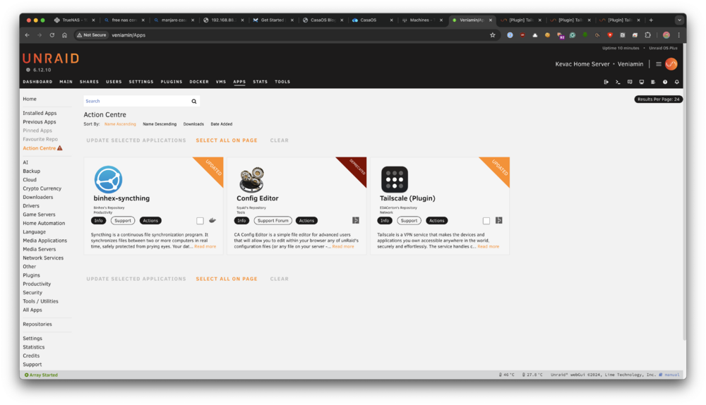

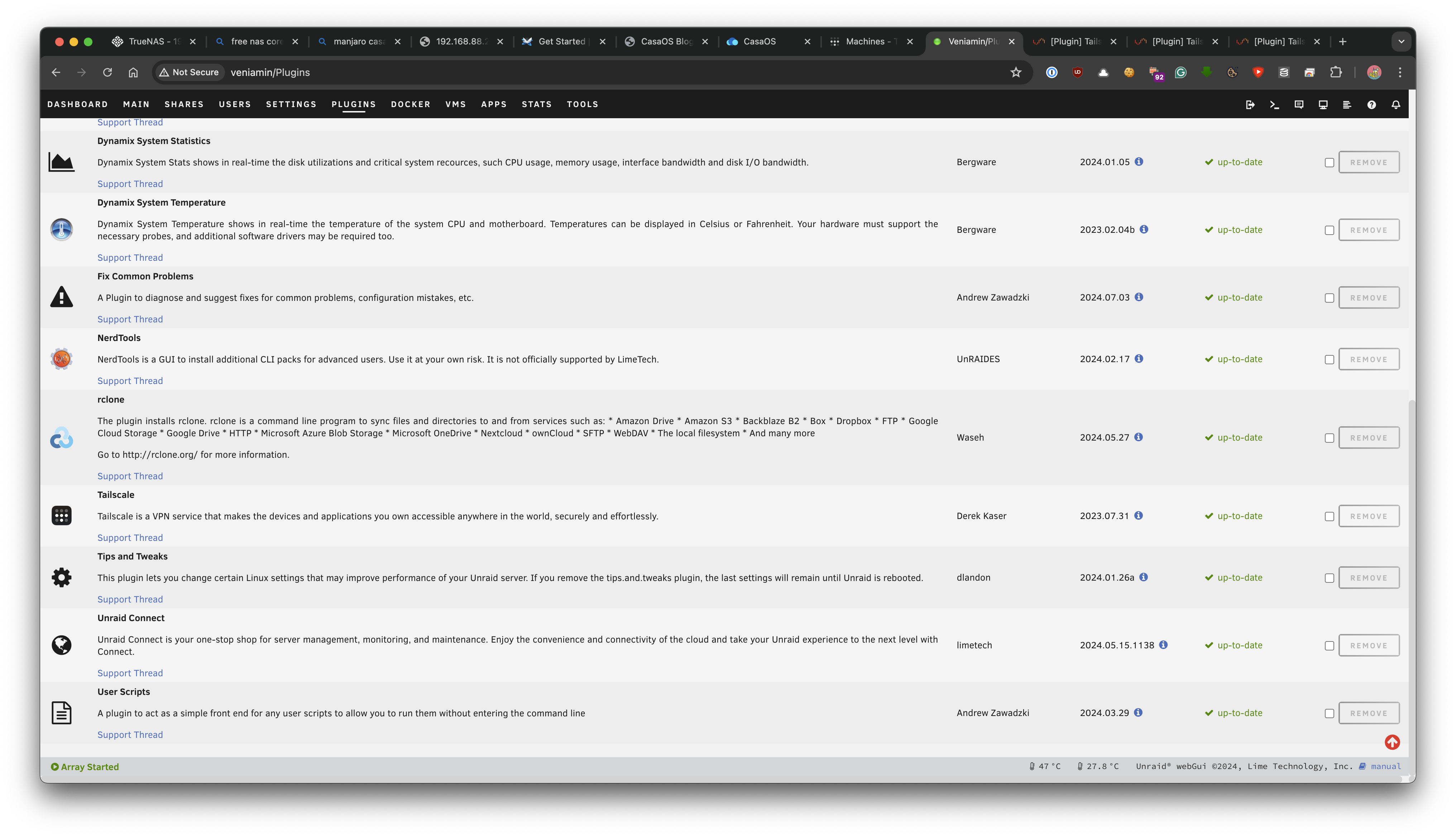

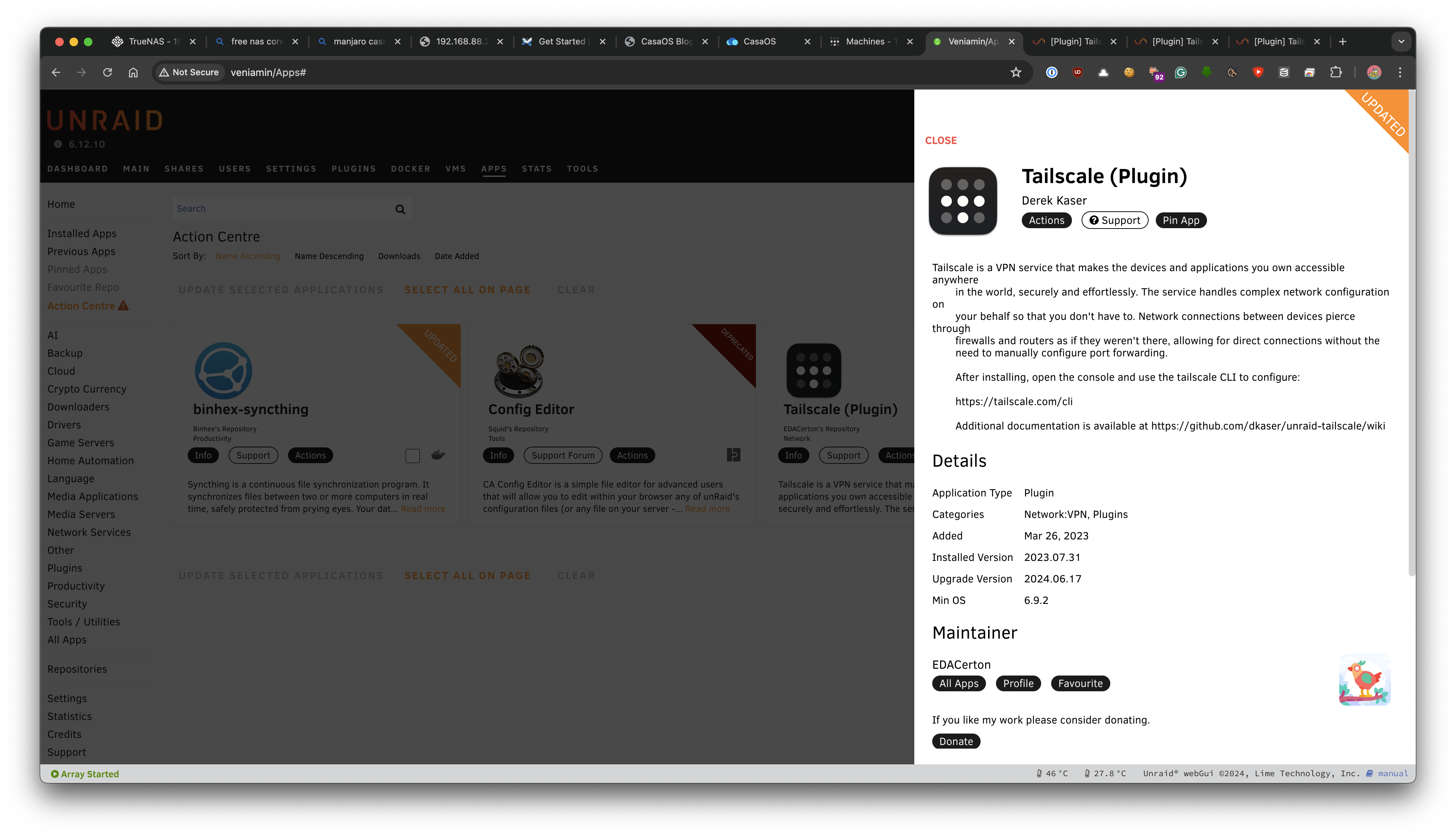

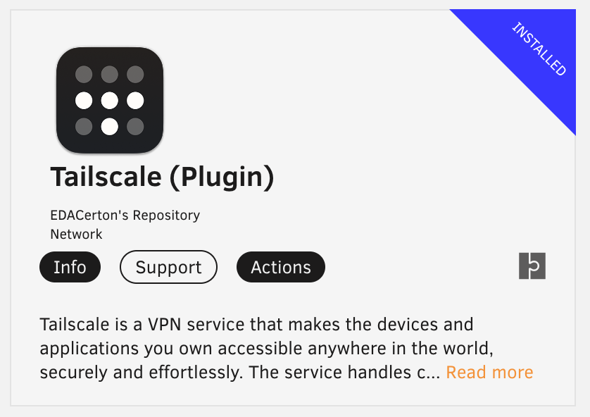

I am struggling to update this plugin.
The main "plugin" page shows no updates.
If you go to "Apps," search for the tailscale plugin, and open its page, it shows that there is a newer version. And in the "Action" dropdown, there is even an "Upgrade" button. But after I "Upgrade," nothing changes. It's still the old version, but it says that there is a newer one.
How do I fix this?
See some screenshots...

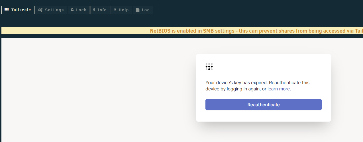

Tailscale literally suddenly stopped working. I was on my server GUI, started an array rebuild and then pressed F5 and suddenly I can't access it via tailscale magic DNS hostname. Direct IP still works.
When I go to Tailscale plugin I get this:
However nothing happens when I click "Reauthenticate" and in my Tailscale dashboard my server is set to never expire.
What's going on?
How do I fix this?
You seem to be stuck on a very old version of the plugin, and for some reason Unraid is "stuck" trying to install that version.
I would try going to "Plugins" -> "Install Plugin", and use this for the URL:
https://raw.githubusercontent.com/dkaser/unraid-tailscale/main/plugin/tailscale.plg
If that doesn't work, I would do the following:
  1. Open the CLI.
  2. Run the following command:
    rm /boot/config/plugins/tailscale.plg
  3. Reboot the server.
  4. Reinstall the plugin.
This will retain your Tailscale state, but will make Unraid "forget" about the plugin completely, which will hopefully clear out whatever is causing that old version to be cached.
What's going on?
Please post diagnostics from inside the Tailscale settings.

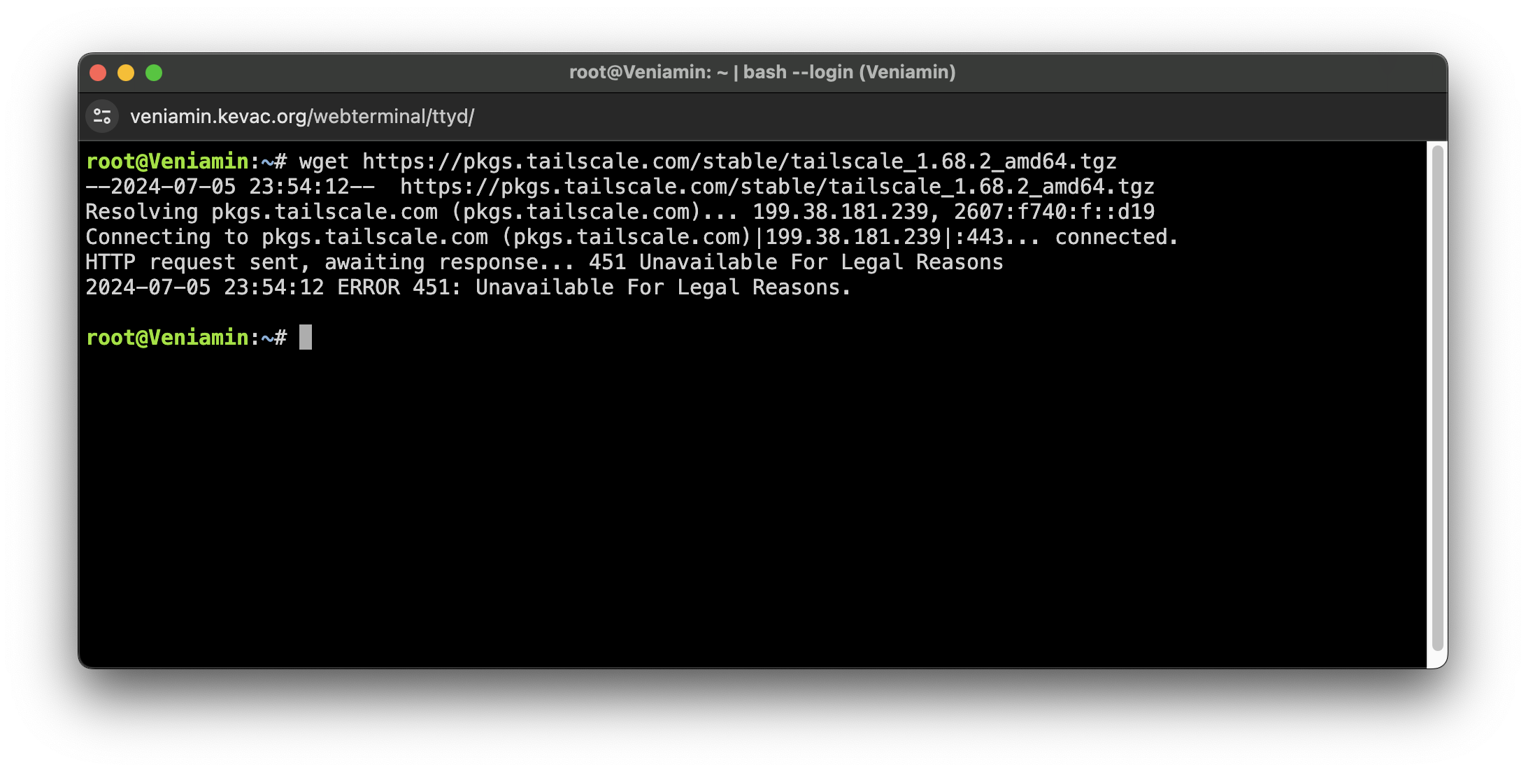

I thought I needed to remove the plugin and reinstall it. But because this server is not near me, and the only way I have access to it is through Tailscale, I needed a plan B.
I installed Cloudflare Tunnel, and after making sure that it worked, I removed the plugin and tried to reinstall it. It failed.
See the screenshot for the reason 🙂
This server is in Russia...

Okay I fixed it. The reason the button wasn't working was because no internet access. It should open a popup to tailscale dash but didn't and no error message.
Please consider this a bug report for that.
I also had expiry disabled so don't know why it expired. Another bug report for that please.
However, I still get this issue
It's not obvious where to approve this.
You have to approve it in the Tailscale admin console.
https://login.tailscale.com/
The expiration piece was probably just related to the server being unable to contact Tailscale; that seems to confuse the Tailscale client in some cases. Unfortunately, there's not much that I can do to resolve that part with the plugin -- I can only report back what the client tells me. :(
