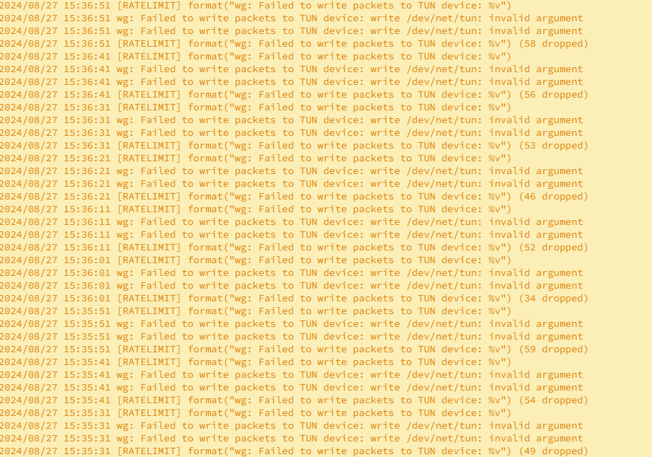

I have installed tailscale based on SpaceInvaderOne's video and it is working for the most part, I am able to access my server remotely.
However, when I try to transfer files to my shares via SMB (windows), only small files seem to be transferable. Larger files always fail.
Log errors seem to indicate something about a TUN device but I am new to unraid and linux so I have no clue what any of this even means. I tried to google it and found https://github.com/tailscale/tailscale/issues/13041 but I have no clue if this applies in my case... my knowledge is lacking
Any help would be appreciated
tailscale-diag-20240827-160149.zip
I agree with your guess -- that kernel bug seems to be the issue.
The bug was introduced in kernel version 6.1.103 (used by Unraid 6.12.12) and is still in the kernel in Unraid 6.12.13.
If you roll back to 6.12.11, you shouldn't run into this. The Unraid 7 betas are also running an unaffected kernel version.
Edited by EDACerton
Upgrading to Unraid 7 solved the issue. Thanks!
