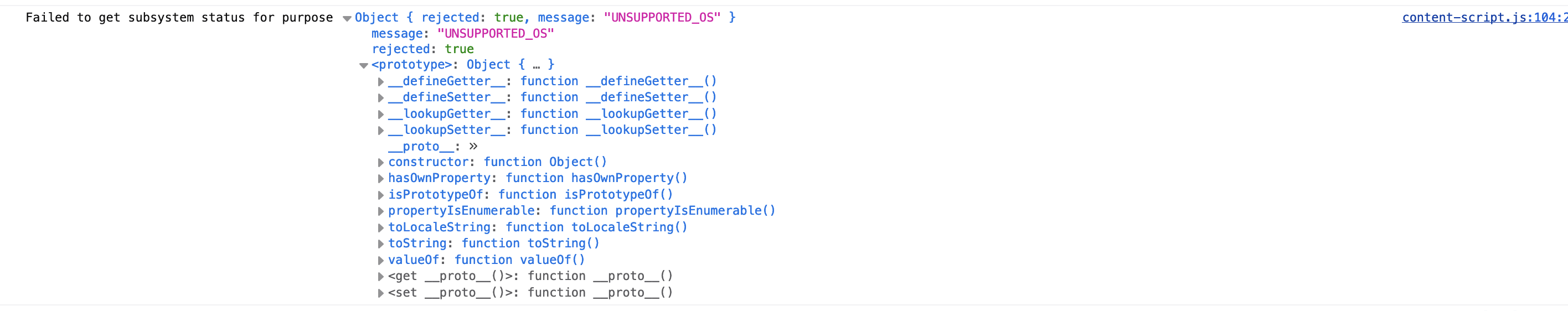

2 hours ago, Aldamir said:
I tested mobile (Android 14) with Firefox, on Macbook (maxOS 14.6.1 (23G93) with Firefox and Safari, on Linux Mint 22.
Also got the error in the attached image..
But i will probably just roll back to a stable unraid version :)
UPDATE: Well i downgraded to 6.12.13 and still have the issue, see the second image...
Thanks for any idea and help! :)
Interesting... it seems like you must be missing one of the Tailscale log files. I've never seen that happen before, congratulations on the find :D
I'm working on a fix now to make the interface handle that situation better. I should have it released to the preview channel later today.
Edit: 2024.09.22 is released and should fix this.
Edited by EDACerton
Thanks for the quick fix!!

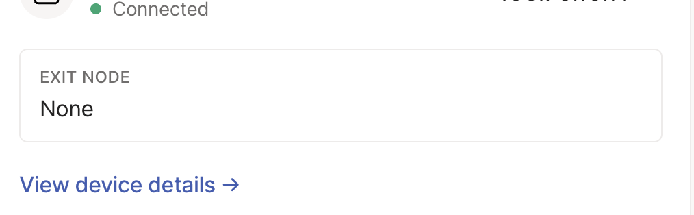

I've set up Tailscale well on Unraid (plugin) and a few other devices. First of all, big thank you, this is really great!
I'd like to use "exit node" to funnel Unraid traffic through another tailscale instance. I.e., not using Unraid as exit node, but the other way round. Is this feasible? I tried to do so under "unraid tailscale settings", but it says "none" and doesn't seem that I can change this setting?

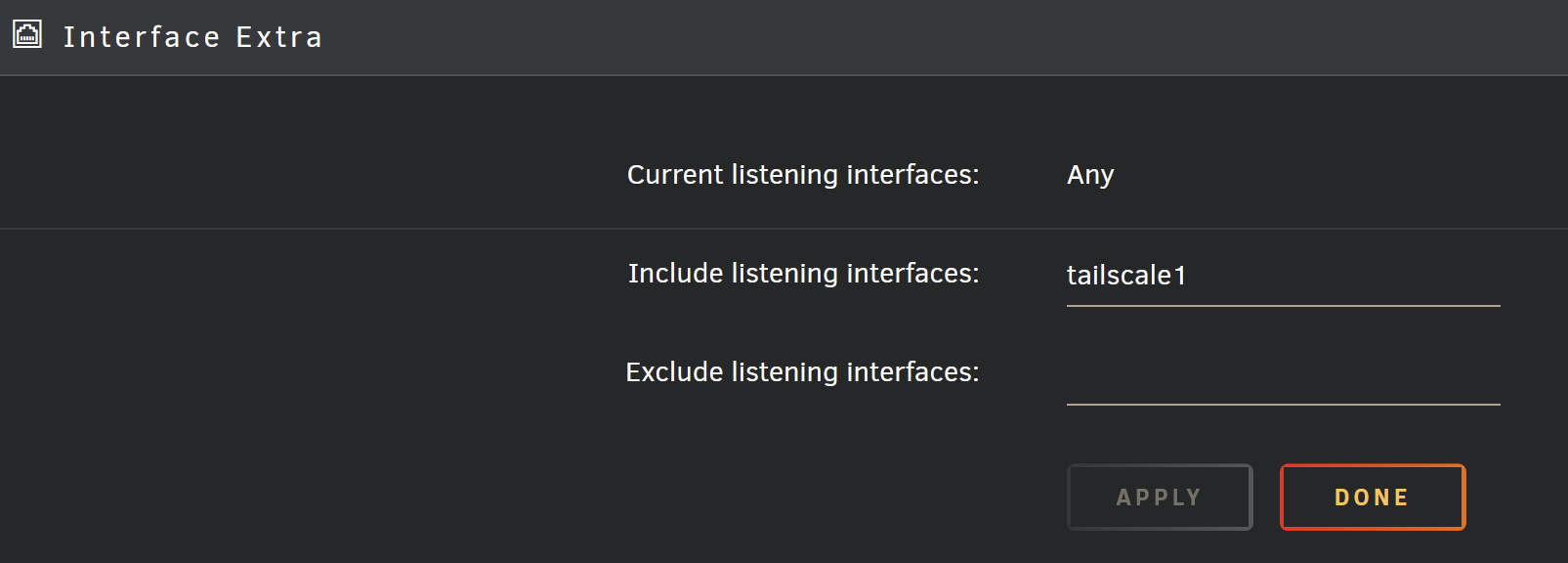

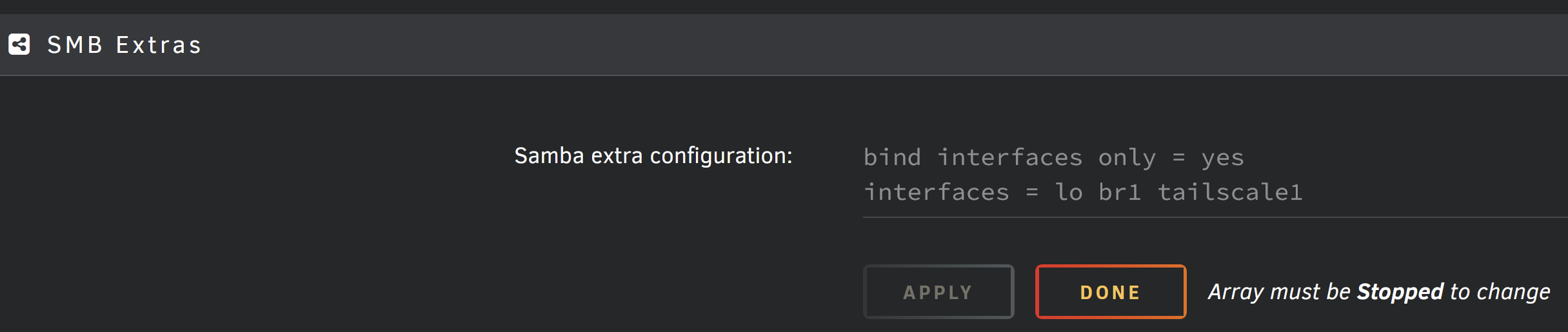

Hello all,
I am at my wits end. Cannot figure out why SMB does not work across tailscale. It works exactly as expected for GUI access and other services. I can access the interfaces of containers using the bridge interface just fine. SMB, however, refuses to establish connectivity across the tailscale1 interface. I am running Unraid 7.0.0-beta.2.
With that said, I am using the tailscale plugin. Tailscale is configured to pass Unraid services.
SMB is configured to use the tailscale1 interface.
image.png.2aae041d2537601ed43f0b22098f96c9.thumb.png.202b6223745ca9fc4f76f77466c7230e.png
And interface extra has tailscale1 listed as included.
image.png.fbb6604a7efb004b7172a3e301f7faf6.thumb.png.e08990002464d0bf05489c03bef5c22c.png
Note this screenshot. It may be the source of my issue: isn't 'current listening interfaces' supposed to list off? Like this?
image.thumb.png.8fc83e5006db183763ccdbf1
If so, why isn't mine?
Is there anything about my configuration that definitely shouldn't work?
lilnas-x-diagnostics-20240928-2156(1).zip
When you say "SMB", do you mean accessing your unraid shares over TS, or something else?
If accessing shares is what you're trying to do, then all I can offer is that I've done none of those additional configs, and I have no issue accessing all my shares remotely.  Have you tried with just the default config?
If you're trying to accomplish something else, I'm probably not going to be much help, sorry.

Thanks for the reply. Yes. I am trying to access my shares over tailscale using Samba Protocol or "SMB", as you would through a windows-mapped network drive. SMB is accessible over my LAN network with zero problems. But I cannot get it to talk over TS.
That should work "out of the box" without any of the extra stuff you posted about.  Have you tried with the default settings?  You didn't say.
All of the settings I detailed are things I added in attempt to get SMB working. So no, it did not work out of the box.
Without "tailscale1" listed in my interface extra area, GUI access, and any other bridged services is lost. Using this intuition, I added tailscale1 to the SMB interfaces section in attempt to get SMB passing over TS. Obvioulsy. That didn't help.
Edited by rjdipcord

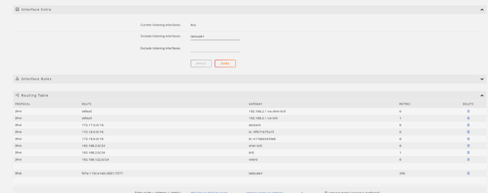

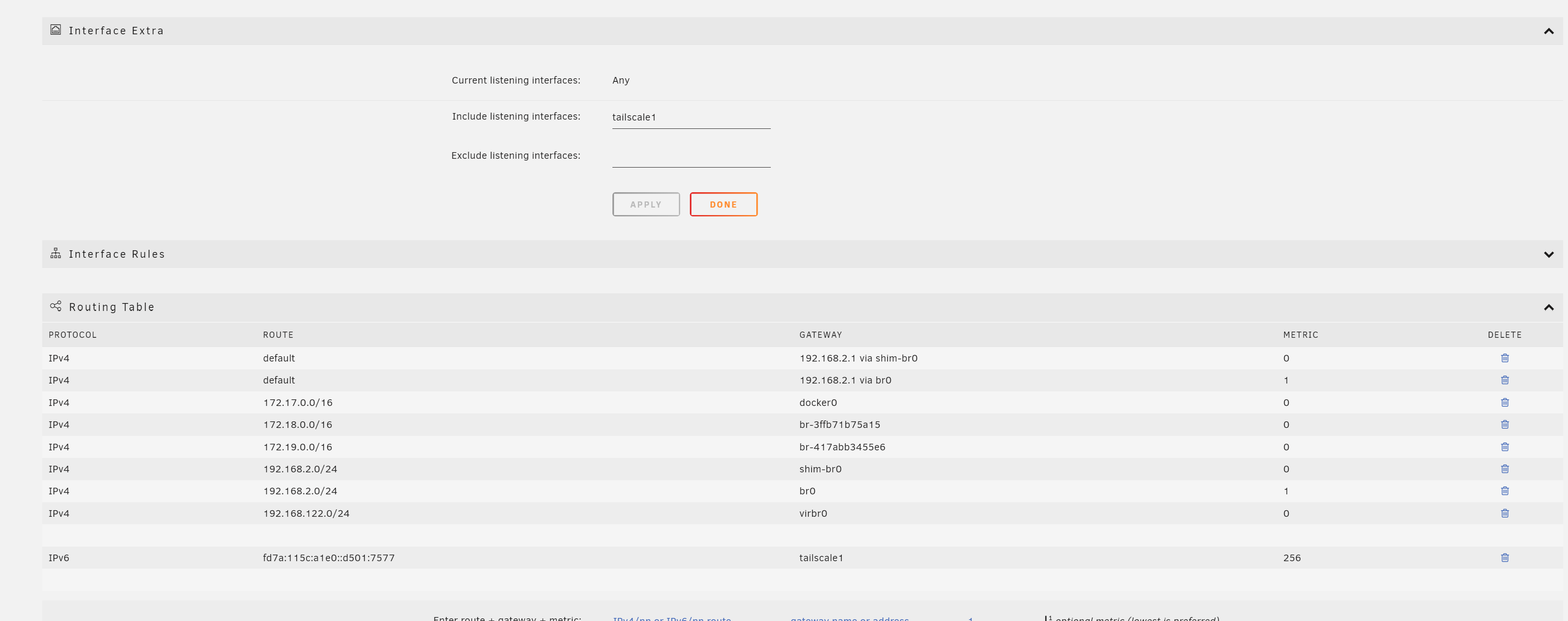

20 hours ago, rjdipcord said:
Hello all,
Please do this:
  1. Remove the Samba extra configuration.
  2. Restart Tailscale using the button in the Tailscale settings.
  3. Follow the instructions in the pinned post to generate Tailscale diagnostics using Plugin Diagnostics.
16 minutes ago, rjdipcord said:
Sorry, guess I could have been more clear.... get rid of everything in the Samba extra configuration. It should be blank.
(And it might be worth trying to connect after you do that... the Samba config has your Tailscale IP, I think it's those extra settings that are causing difficulty.)
