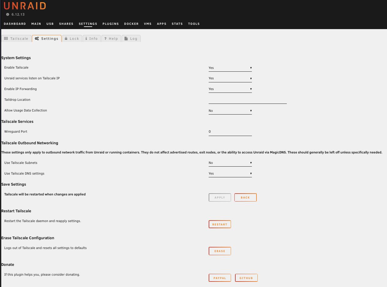

Hello, I have successfully installed and set up the Tailscale plugin, which allows me to remotely access my Unraid server and the individual Docker containers.
Since then, however, various Docker containers have been behaving strangely (network type: custom br0).
It looks like a connection to the internet is no longer possible.
Errors when the tailscale plugin is activated:
Jellyfish:
The plugin catalogue and meta data can no longer be loaded:
[2024-10-04 12:05:15.192 +02:00] [ERR] [17] MediaBrowser.Providers.Movies.MovieMetadataService: Error in "The Open Movie Database"
System.Net.Http.HttpRequestException: Resource temporarily unavailable (www.omdbapi.com:443)
 ---> System.Net.Sockets.SocketException (11): Resource temporarily unavailable
SABnzbdVPN:
Restart of the container no longer possible (see
If I deactivate the tailscale plugin in the settings, all containers work as desired again after I restart them.
Settings:
(it makes no difference whether DNS settings are activated/deactivated)
Does anyone know a way to solve this error?

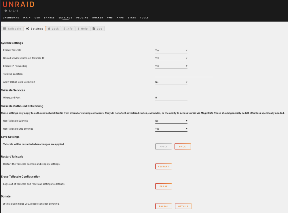

I have now been able to narrow down the problem somewhat.
I tested with a chromium container.
With network type “Bridge”, the connection to websites in this browser works perfectly, regardless of Tailscale.
If I set the container to “Custom: br0”, I can only call up websites in the browser if I first use
tailscale down
to close the connection to the tailscale network, then start the container.
I can then use
tailscale up
to re-establish the connection to Tailscale without affecting already running/functioning containers.
Unfortunately, all containers with custom network br0 are actually affected.
If I reboot them while connected to the Tailscale network, the containers do not get a connection to the internet.
Does anyone have an idea how I can further analyze the problem?

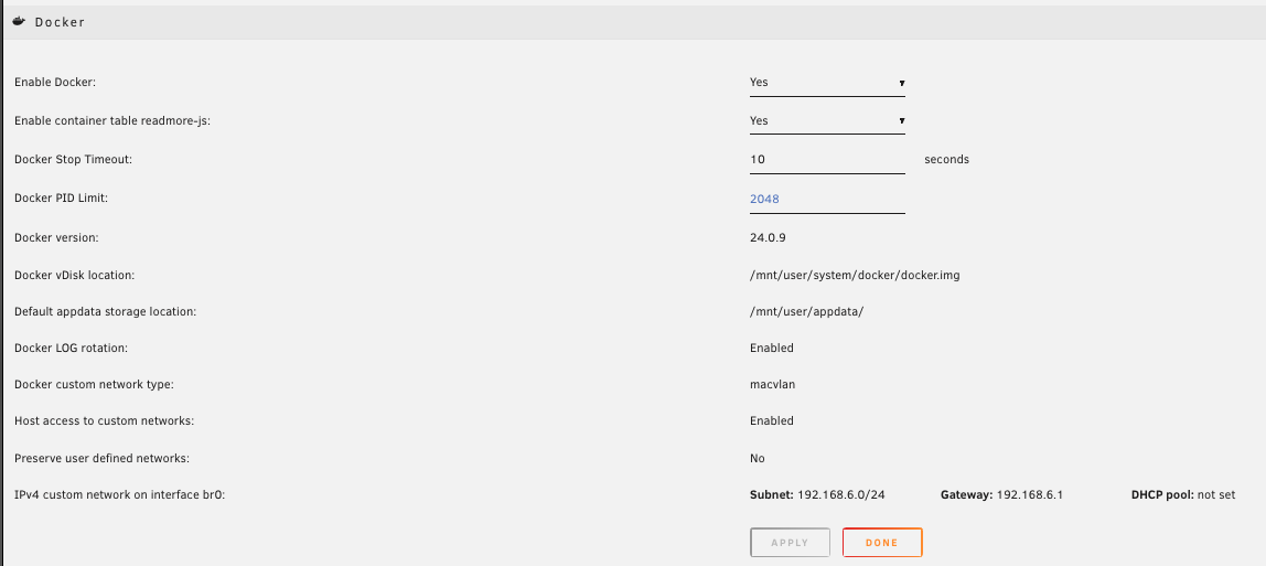

On 10/5/2024 at 1:13 AM, Espressomatic said:
My docker networking for br0 is MACvlan and I'm running Unraid 7.0.0.beta3 (just updated from bet2 which I'd been running since June).
Thank you very much for your answer. My Docker network was still running with the network type “ipvlan” until just now.
I changed it to “macvlan”, but unfortunately this did not bring any improvement.

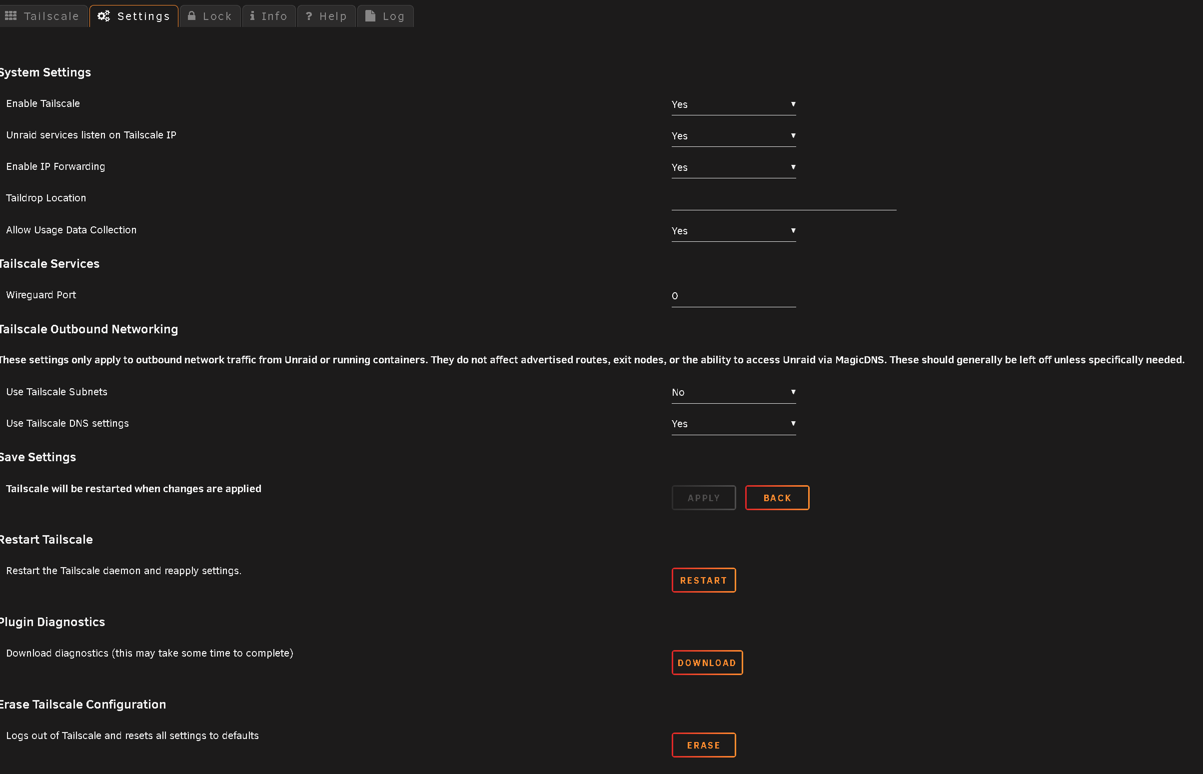

I am at a loss. I have tried every setting, both enabled and disabled to try and access my tailscale IP to enter my WebGUI but it does not work. Not only does that fail but I also can't access any docker containers using their ports. Any help would be greatly appreciated.
I have made sure to have these settings below:
I have also enabled the exit node and set subnets for the approved IP range of: 192.168.1.0/24
Attached is the diagnostics. Any help is appreciated folks.
Tower-tailscale-diag-20241006-093528.zip
