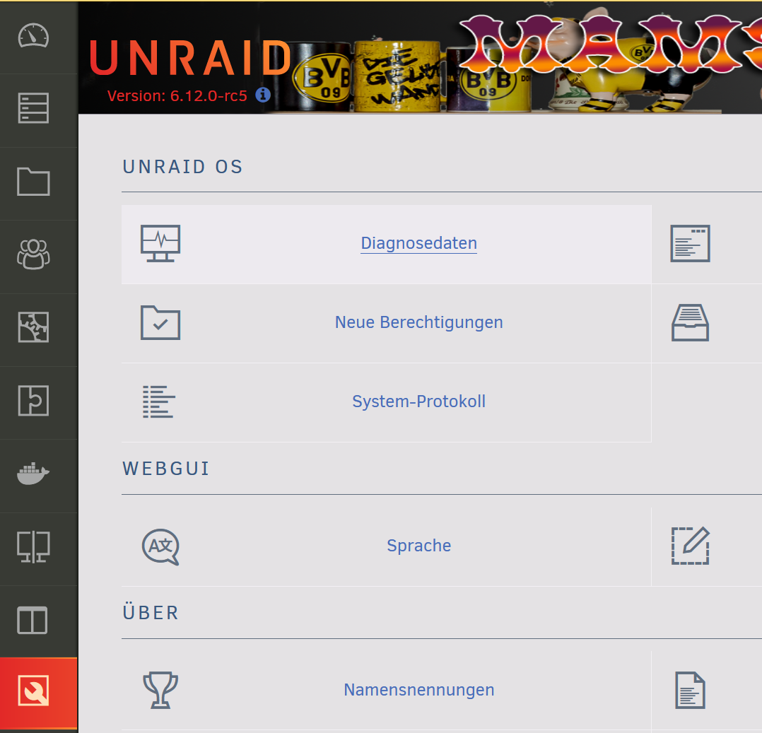

Simple.
with the unraid gui select "tools" from the side and "diagnostics" from the main menu
There you will find an button to generate and download the diagnostic zip file.
Create and save one whilst you have 1000Mbs, then wait until the line slows down and create another zip. Upload both of them here.
