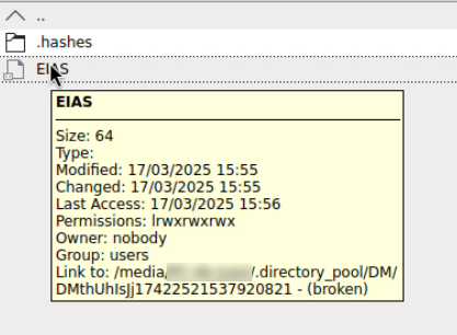

March 18, 20251 yr On 11/7/2024 at 4:56 PM, lsaranto said: Anyone here know what the 'Create symbolically linked views for each user on the clients after file backups' setting does? There are several questions about it in the Urbackup forum, but no answers. I can see "Creating user views..." in the log after a backup, but how can I access it? In theory, while doing an incremental file backup it replaces any unchanged folder holding more than ten items inside with a symlink to the original in previous backups. See: https://www.urbackup.org/administration_manual.html#x1-750008.6 I'm having a severe problem with it and my Windows PC's backups, though. UrBackup's GUI shows them and their contents, and I can restore them or their items with no issues. BUT: Unraid's built-in file browser doesn't show them inside the share where the backup is stored (a RAID-Z one). The share, mounted on in my PC via SMB doesn't show them either. Kommander shows the symlinks but says they are broken. Via Bash, I can ls in that directory and see the symlink: "EIAS@". Doing ls -l EIAS gives me: lrwxrwxrwx 1 nobody users 64 Mar 17 23:55 EIAS -> /media/MY-PC-NAME/.directory_pool/DM/DMthUhIsJj17422521537920821 which seems valid. I've tried a few SMB recipes to make symlinks accessible, unsuccessfully. That Unraid's own file browser doesn't see them feels even more concerning. Does this happen to anybody else? Should we disable this default setting when dealing with backups of Windows data (doing so gives me the normal, expected behavior)? Or is it a ZFS issue? I'm on Unraid 7.0.1. Edited March 18, 20251 yr by MetricTonto More precise context data
