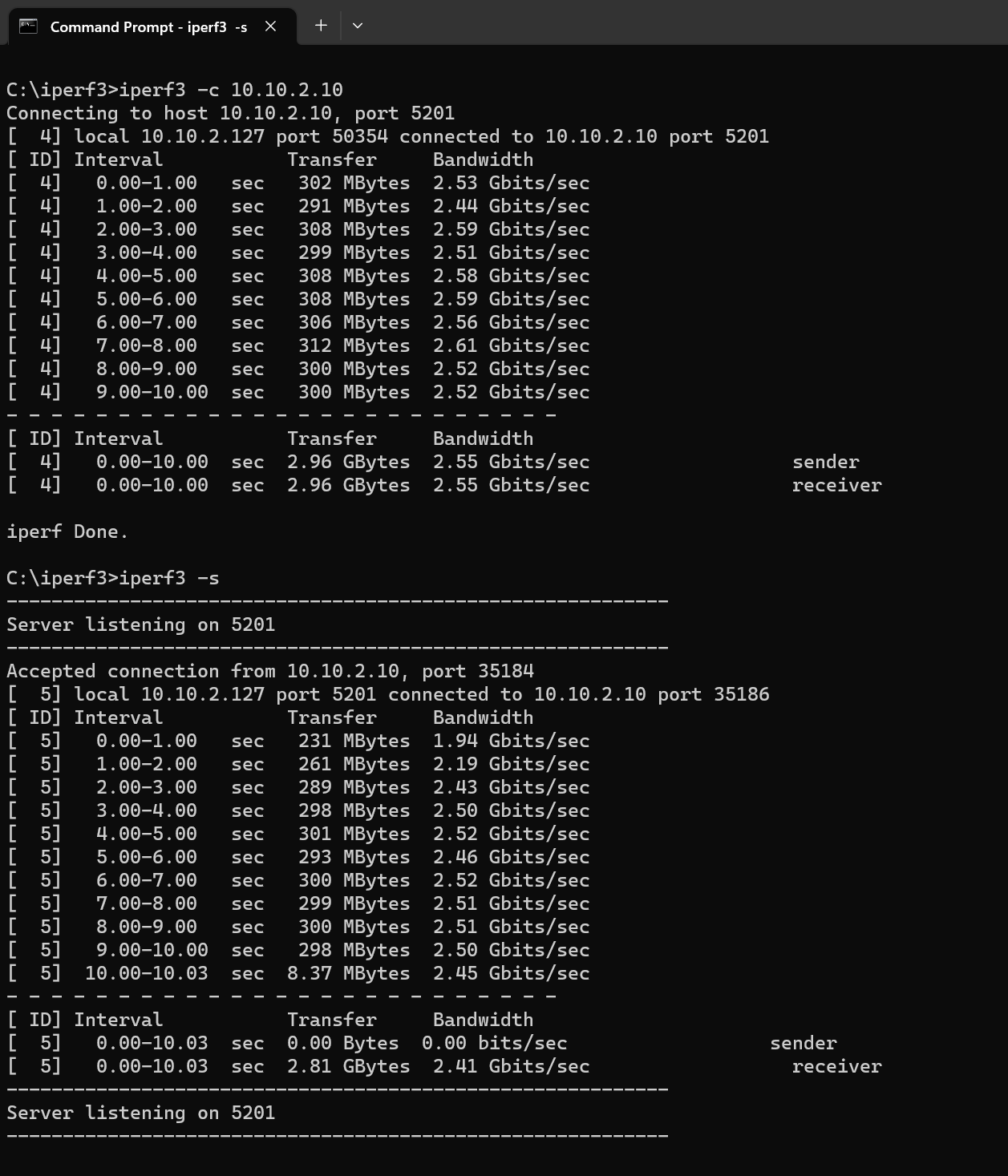

I did iperf and notice that both site transfer only cap at 2.5Gbe and I'm wonder why and how to resolve this issue?

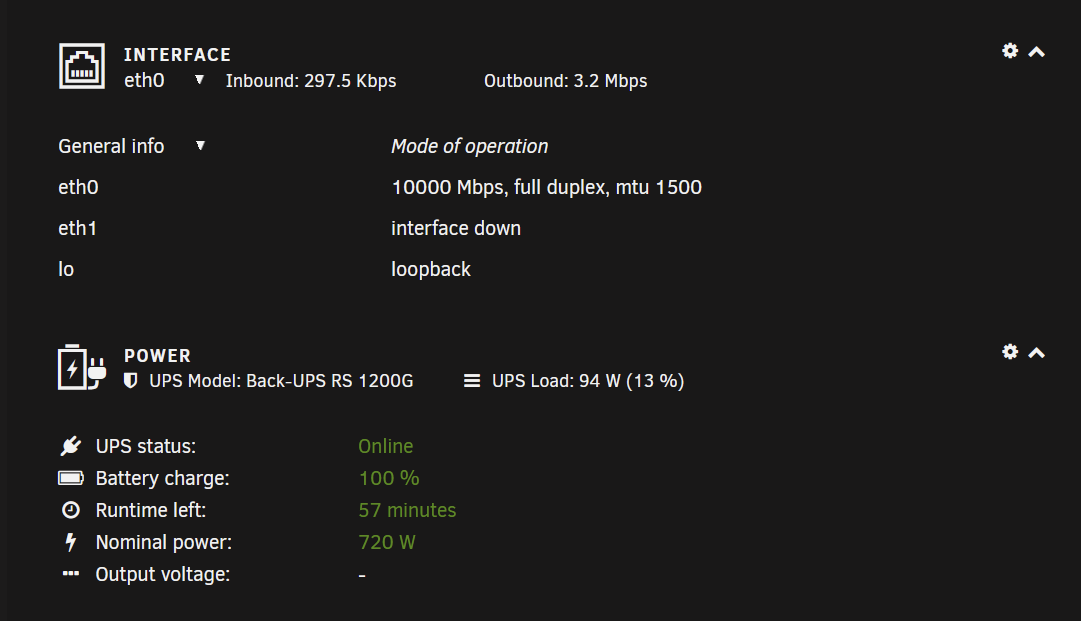

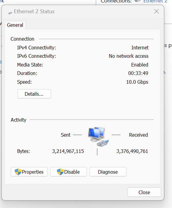

Under unraid i can see the Lan connection is 10Gbe same with my Windows 11 Lan connection show 10Gbe.
image.thumb.png.0dfc6526279aa95ad0c69e3af10af0a1.pngimage.png.5c5491a688fadc74edda897f6c715d41.pngimage.thumb.png.c5d38fa13cf6508c99b6779cb8b6f61b.png

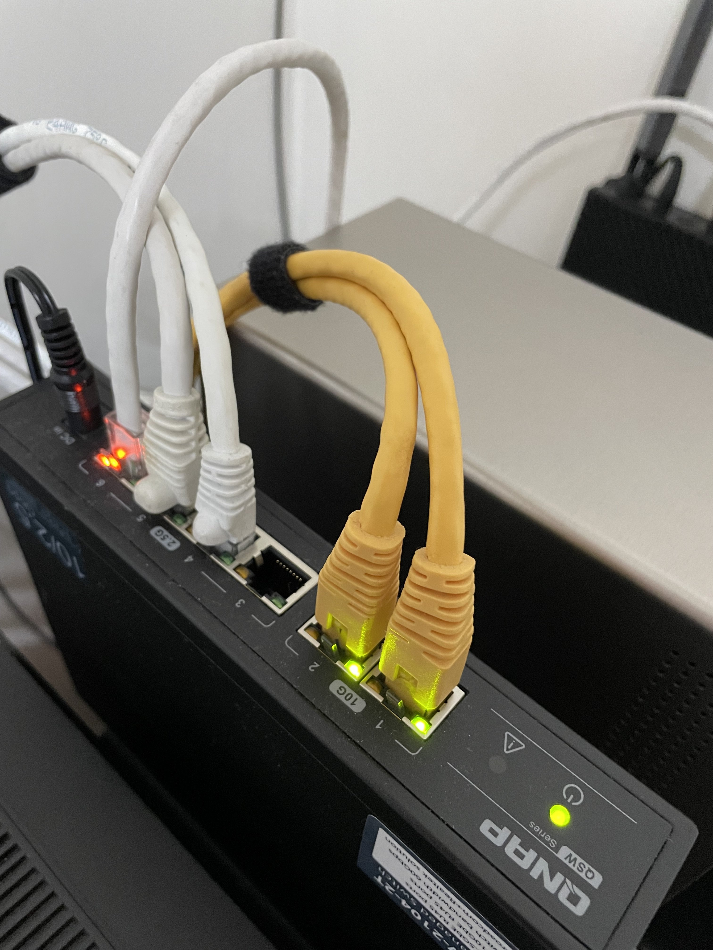

can we affirm that both machines are plugged into the 2 10G ports of the switch (port #1 and #2) ? ? ?
The others are 2,5G only, so if one of them is in a "wrong" port (#3 to #6) it will result in 2,5g speed everywhere.

Yes both Unraid and my Workstation is connected to the 10gbit port. Picture attach.

ok, I just wanted to make sure... 😁

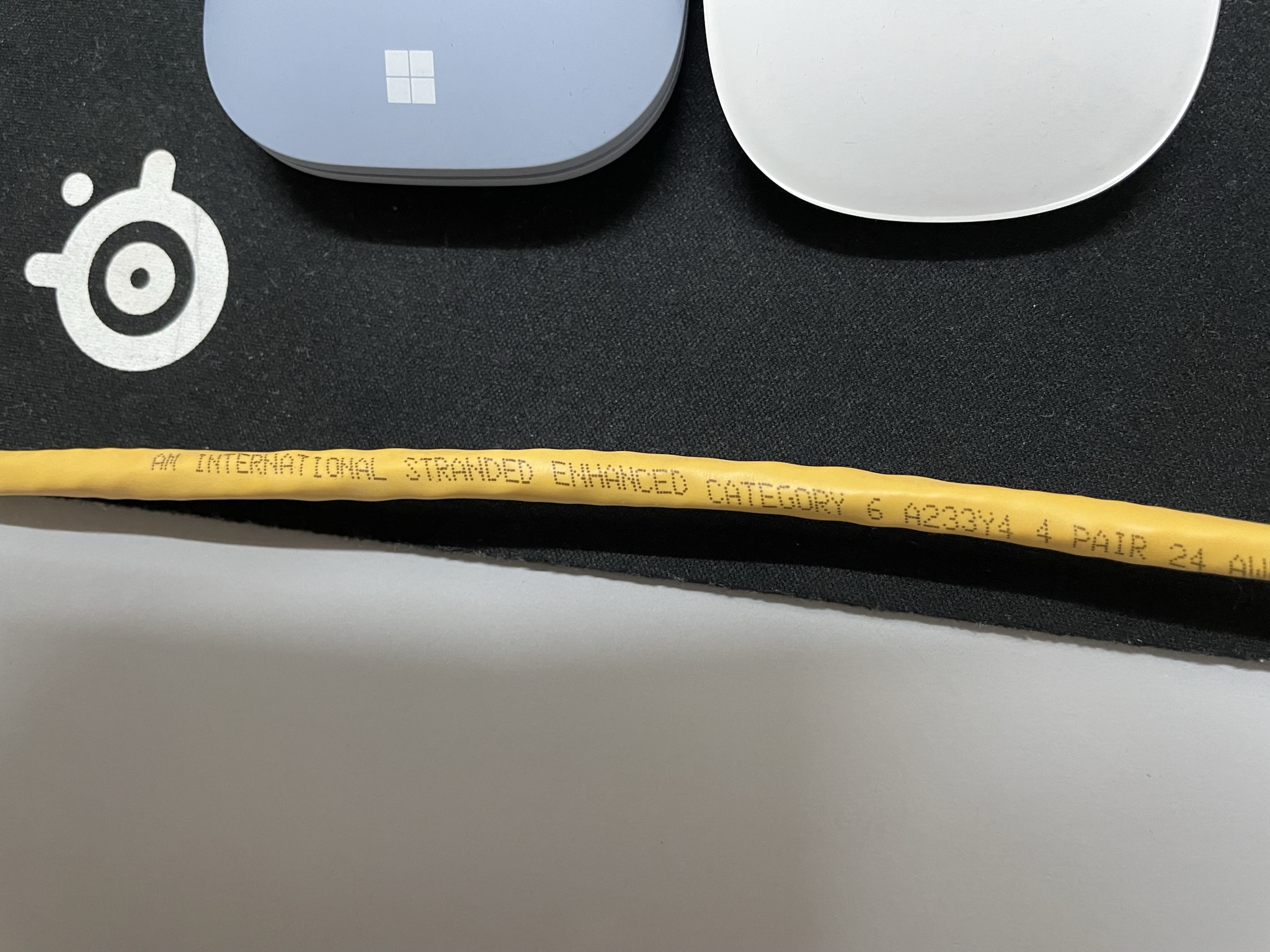

But, are you sure, your cables are correct? those look very cheap to me the one in #6 is even unshielded!
"real" 10G cables look different...
If you run some traffic between those two 10g ports do any other lights flash on the switch? perhaps something funny with the routing forcing traffic to flow through a 2.5g connection? is your local traffic going from 10gbe to switch, then 2.5gbe to router and back, then 10gbe to the other end?
If you disconnect every other device (and any secondary NICS) and just run server to windows through that switch does it still cap out at 2.5?
Cables shouldn't be an issue, you can run 10GBaseT over UTP CAT6 if the distances aren't too long, and 2.5gbe over UTP Cat5e is just fine for short hops too, and those sorts of issues arent going to cut your throughput that far, a badly grounded FTP cable can cause more problems than that.
one more cable hint: try to pull the cable locked into the switch back and forth gently. If they move, they are wrong!
"real" Cat6 plugs are minimal longer than the old ones (even if you put them side by side, its hard to tell the difference), they are really fixed whereas "wrong" plugs can still be moved.
The problem is, that until a year ago or so, NO cable was really good enough for 10G. The cable type itself was ok, but the plugs on both ends were not. They have sold the stuff as "cat 7 raw cable" (or even cat8 sometimes).
10G on Twisted Pair is no child's play... I gave up and switched to fibre, no problems since then...

Those are AM Cat6E cable.

Both the 10Gbe port are connect to my Win11 Workstation and Unraid. The other 2 white cable are going to my Qnap NAS qhich is power down at meantime and the last port are going to my Telco Router so as now there is only 2 10Gbe connection are active only.
When i try to copy file from my windows 11 workstation to Unraid only both the 10Gbe port are blinking.

That's what i have AM cat6E 0.5M cable which I'm using or the Krone Cat6E cable which is 2M in length.
yeah, you did not get my message. Of course these are suitable cables, but that does not mean a thing. Could even be Cat 7 or Cat 8. Does not mean a thing too (ok, its relevant too but only 50% of the problem)
The problems are the plugs on both ends. Before 2022 there were no cat6 plugs available, so they took real cables and attached bad plugs and sold it as "patch cable (raw cable)".
If you bought one of these you should read it as "does not work properly".
(sadly there is nothing written on the plugs, thats why I added the trick with moving the plug whilest it is attached, If if moves, you should consider to throw away that cable)
Btw, price is also no real way to tell. I've bought dozends of different brands before I realized that the rather cheap "Amazon basics, nylon covered" worked flawlessly.

C:\iperf3>iperf3 -c 10.10.2.10
Connecting to host 10.10.2.10, port 5201
[  4] local 10.10.2.127 port 56119 connected to 10.10.2.10 port 5201
[ ID] Interval           Transfer     Bandwidth
[  4]   0.00-1.00   sec   372 MBytes  3.12 Gbits/sec
[  4]   1.00-2.00   sec   378 MBytes  3.17 Gbits/sec
[  4]   2.00-3.00   sec   367 MBytes  3.08 Gbits/sec
[  4]   3.00-4.00   sec   384 MBytes  3.22 Gbits/sec
[  4]   4.00-5.00   sec   391 MBytes  3.28 Gbits/sec
[  4]   5.00-6.00   sec   402 MBytes  3.38 Gbits/sec
[  4]   6.00-7.00   sec   375 MBytes  3.14 Gbits/sec
[  4]   7.00-8.00   sec   386 MBytes  3.24 Gbits/sec
[  4]   8.00-9.00   sec   381 MBytes  3.20 Gbits/sec
[  4]   9.00-10.00  sec   382 MBytes  3.21 Gbits/sec
[  4]   0.00-10.00  sec  3.73 GBytes  3.20 Gbits/sec                  sender
[  4]   0.00-10.00  sec  3.73 GBytes  3.20 Gbits/sec                  receiver
iperf Done.

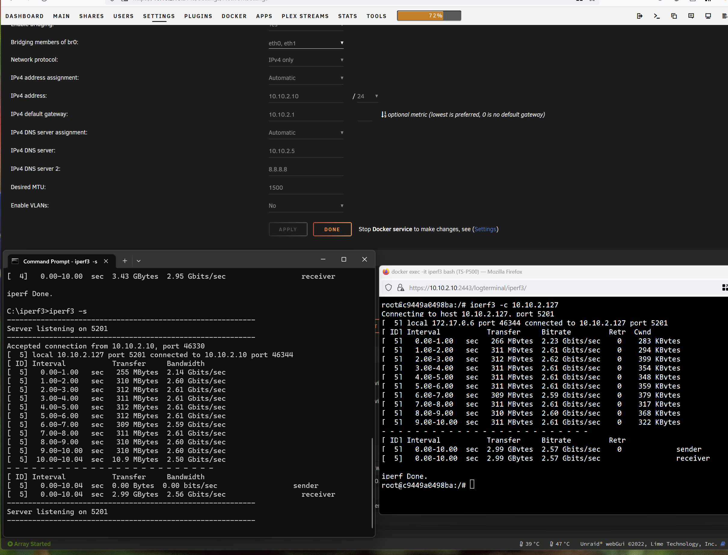

root@c9449a0498ba:/# iperf3 -c 10.10.2.127
Connecting to host 10.10.2.127, port 5201
[  5] local 172.17.0.6 port 58088 connected to 10.10.2.127 port 5201
[ ID] Interval           Transfer     Bitrate         Retr  Cwnd
[  5]   0.00-1.00   sec   293 MBytes  2.46 Gbits/sec    0    342 KBytes
[  5]   1.00-2.00   sec   290 MBytes  2.43 Gbits/sec    0    325 KBytes
[  5]   2.00-3.00   sec   302 MBytes  2.54 Gbits/sec    0    354 KBytes
[  5]   3.00-4.00   sec   319 MBytes  2.67 Gbits/sec    0    354 KBytes
[  5]   4.00-5.00   sec   319 MBytes  2.67 Gbits/sec    0    342 KBytes
[  5]   5.00-6.00   sec   324 MBytes  2.72 Gbits/sec    0    339 KBytes
[  5]   6.00-7.00   sec   321 MBytes  2.69 Gbits/sec    0    337 KBytes
[  5]   7.00-8.00   sec   325 MBytes  2.73 Gbits/sec    0    334 KBytes
[  5]   8.00-9.00   sec   296 MBytes  2.49 Gbits/sec    0    334 KBytes
[  5]   9.00-10.00  sec   324 MBytes  2.72 Gbits/sec    0    334 KBytes
[  5]   0.00-10.00  sec  3.04 GBytes  2.61 Gbits/sec    0             sender
[  5]   0.00-10.00  sec  3.04 GBytes  2.61 Gbits/sec                  receiver
iperf Done.

still dont understand why you are running iperf in a docker without host mode???
the additional overhead for NATting and rerouting the packets will surely slow down the connection (but it should not be that much)
AAAAH! I just see one more potential point of failure!!! You are using eth0 and eth1 as a single bridge. You should be aware that this bridge only can transport at the speed of the slowest interface. So, if your eth1 is just 2,5G, you know where it comes from...

I'm connecting Back to Back actually no more goes through the 10Gbe switch.
Now iperf3 for unraid is in docker now. no more under Nerdtools.
Both eth0 and eth1 are 10Gbe its the same card X540-2T comes with 2 10Gbe Ether port.
