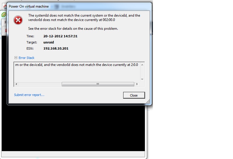

Went ahead, 2 M1015s and 1 ARC1200 in passtrough.
Booting unraid resulted in an error, like shown.
What have I done wrong? Can it be fixed? What does 002:00:0 mean?
I think it was my fault. Yes, sure it was.
Must the 2 M1015 and ARC1200 first be added as SCSI0,SCSI1 and SCSI2 and PCI device 0, PCI device 1 and PCI device 2 or vice versa. I'm afraid I did something wrong there. There is a lot to learn here!! But that's part of the fun. Or is there no need to add SCSI devices and are the PCI devices enough?
I went the plop-way for now. The box boots just fine, now. I removed the PCI devices and added them again.
unraid started with array started. Gonna play around a bit now.
