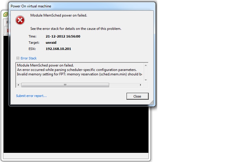

I tried to up the memory to 4 GB but it wont let me. I get an error like in the attachment.
The motherboard holds 16 GB memory, and no other VMs are running.
What can be wrong?

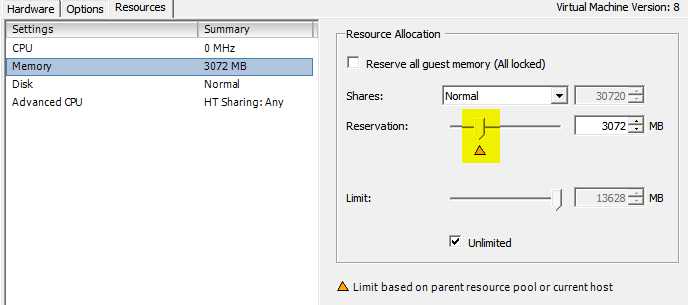

That means you need to go to the memory reservations and up the memory used to 4GB.  This happens automatically when first setup but after that you have to change it yourself.  If you are not using passthrough it doesn't happen.  Basically make the slider and the orange arrow match see graphic below.
Thanks, that worked.

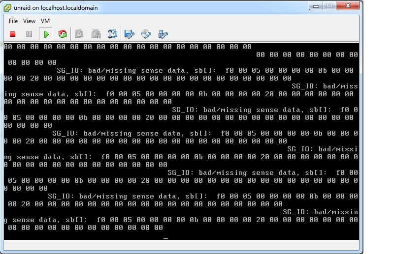

I noticed some strange lines on the consol screen on unraid in Vspere, see the attachment please.
Do you know what it is?
I believe but am not positive that it is related to unRAID trying to get temperature data from a simulated drive.  Based on your other thread that I responded to I would say this is on your parity and cache drives since they are not real drives but composed on your ARC1200 controller.
I don't see it in a telnet session, only in Vsperes unraid console, weird. As long as it doesn't disrupt anything it's ok by me.
