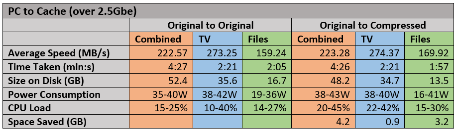

Okay so I did some initial basic testing to get an idea of which route I would like to take but ideally would like to do more rigorous and quantitative testing soon.
Using one sample data set, I tested 3 primary behaviours:
  1. PC to Cache (over 2.5Gbe smb)
  2. Cache to PC (over 2.5Gbe smb)
  3. Cache to Array
The data set was 52.4 GB consisting of some tv series taken directly from Jellyfin with metadata (35.6 GB) as well as a variety of personal documents (word, pdf, programming, CAD files, etc : 16.7 GB). For simplicity I will call the 35.6GB portion “TV” and the 16.7 GP portion “Files”. I only performed each test once, logging time taken and average transfer speed, while manually observing CPU load and power consumption.
RESULTS:
In each case the compression resulted in slightly faster transfer speeds, but it should be noted in this case, the primary bottleneck for transfer speed was not the read or write speeds and instead the network so it is expected they should be similar. I observed that power consumption was similar perhaps +3W in general with compression turned on.

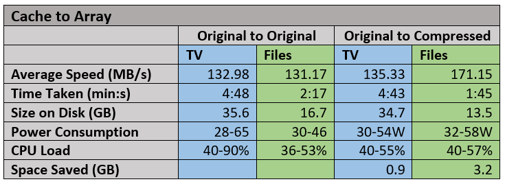

The results of compression start to show here where compression allows for faster transfer time onto the array for data that can be compressed. Interestingly I observed the CPU load with compression turned off to fluctuate a lot more and reached much higher loads and watts than previously seen in any test. Not sure if this is just a coincidence as I ran the test once, this was also only for part of the test where it then returned to expected figures. Again, in general compression turned on may only be increasing loads by ~3W.
I have ordered an m.2 enclosure so I can perform these tests again but with a faster connection. I would also like to properly log CPU load and power consumption for a quantitative comparison, so will investigate ways to do this.
In general, it would appear enabling compression is beneficial for both space savings and transfer speed (except for reads off cache, will need to investigate this) for a little bit of extra CPU load and power consumption. I’d recommend having compression turned on for anyone running zfs on their cache and array in new unraid.
