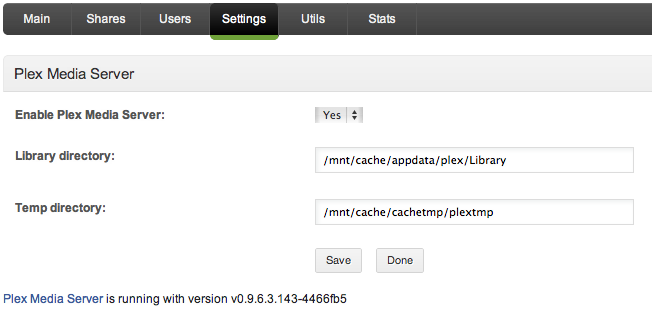

I have Plex pretty much working but if I reboot the unraid server, Plex forgets where I set my movies, tv shows, etc. directories for the library in the media manager.  Can someone tell me how to make this survive reboot?
where do you keep your Library?
this has to be on cache or on a protected disk. (user/disk share)
According to the settings ---> Plex Media Server page, it is as follows:
/mnt/users/plugin_data/pms/library
/mnt/users/plugin_data/pms/tmp
But when I look at /etc/rc.d/rc.plexmediaserver, it shows this at the top:
DEFAULT_PLEX_MEDIA_SERVER_HOME="/usr/local/plexmediaserver"
DEFAULT_PLEX_MEDIA_SERVER_APPLICATION_SUPPORT_DIR="/tmp/Library"
So which file does it look at when the server boots?  I am confused.
on both, these
(DEFAULT_PLEX_MEDIA_SERVER_HOME="/usr/local/plexmediaserver"
DEFAULT_PLEX_MEDIA_SERVER_APPLICATION_SUPPORT_DIR="/tmp/Library")  are only used if no /boot/config/plugins/plexmediaserver/plex_settings.cfg is present.
