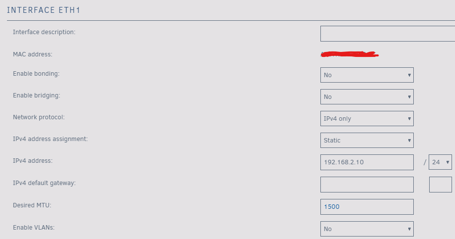

Pls simple assign static IP and Subnet to eth1 ( gateway in blank ), for example if router network in 192.168.1.1 with 255.255.255.0 then set eth1 in 192.168.2.X with 255.255.255.0 and windows machine in 192.168.2.Y 255.255.255.0 ( also gateway in blank ) should solve your problem.
The pc and server are directly connected hence the local link IP address range.
They are set as static on both sides, the settings all come over fine on the update.

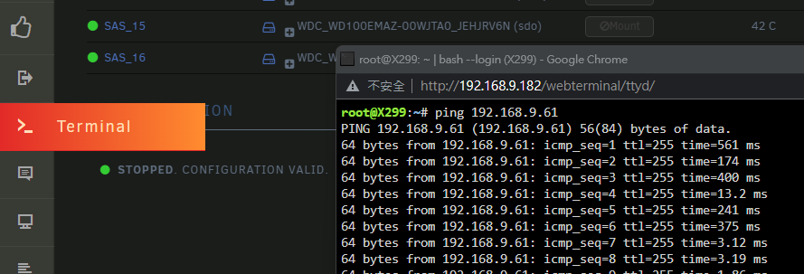

For Unraid, open web terminal then ping Windows IP
169.254.117.248 is eth1 IP, you need ping Windows IP.
BTW, just simple test, as mention before, pls assign a static IP & subnet at Unraud eth1 and Windows
At least it should work with 6.12.1

So if I set eth1 as static I get the warning "Interface Ethernet Port 1 is down. Check cable!"
Ping still works though.
When you change network settings, interface will up and down, and you need waiting Windows side link up too.
If you " lsof | grep 169.254 " haven't found service listening on that, you must set static IP.
