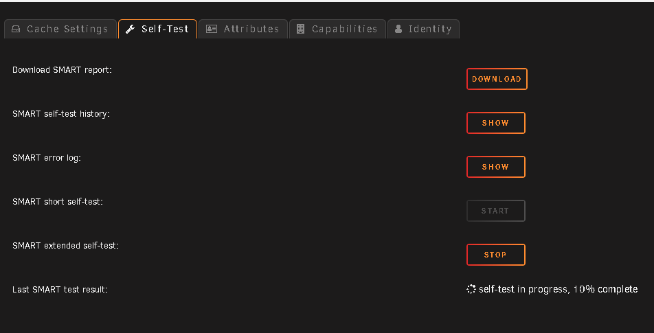

Unfortunately the short test is nowhere near a through test of the drive.
The long test will live up to its name taking hours per TB.  Also progress only updates at 10% intervals.
Damn should I stop the data rebuild and run the test?
You can do both at the same time, since that disk is not in the array.

Ah! Thank you for clearing that up! Starting the Extended test now =D

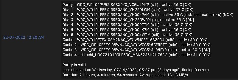

Did you replace the cables for that disk? It was still showing issues in the last diags
Yes, replaced I the cable. I've actually replaced them 3 times. But still the crc errors persist so I'm gonna assume it's the HBA which I plan to eventual replace. But since the only reputable HBA vendor I know is in the US and I'm in the PH I'll have to be patient and buy 2 NVMes as a replacement cache when I can afford it and retire this HBA.

New HDD is throwing errors again. I'm starting a SMART extended self-test, then I'll post the diag after. Not sure why it's throwing errors again. I really hope it's not a dud.

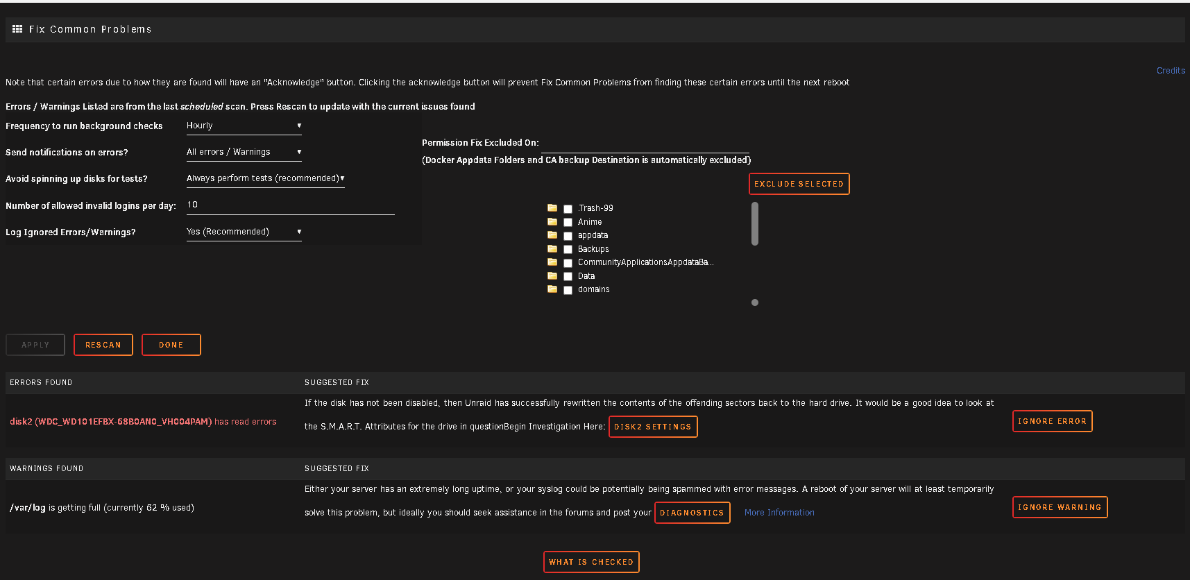

Apparently my Fix Common Problems is now complaining about it.
Followed the Fix Common Problems advice and rebooted.

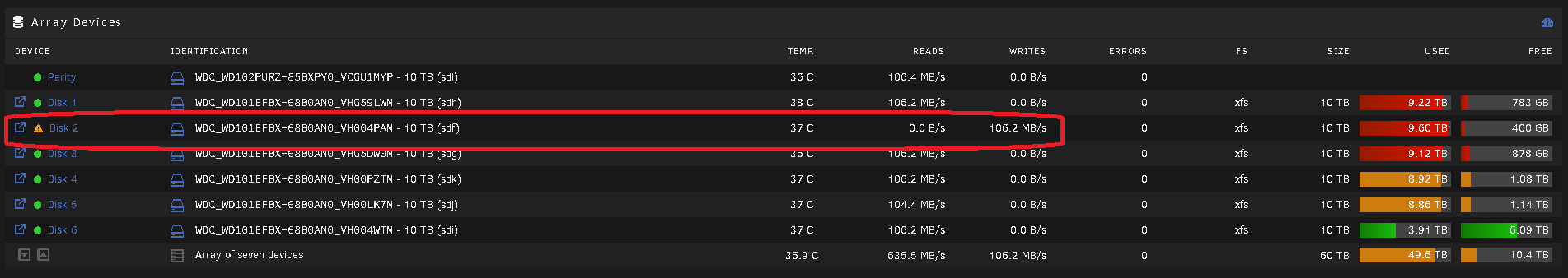

Are you rebuilding disk2?
Yes, I'm trying to follow the steps your all taught me
1.) first I replaced the SATA cable. (DONE)
2.) Afterwards I disabled spindown, (DONE)
3.) placed it into maintenance mode and (DONE)
4.) ran and extended smart test. (DONE)
5.) Then I ran an xfs repair (DONE)
6.) and now I'm currently rebuilding now. (IN PROGRESS)

59 minutes ago, Nanuk_ said:
(IN PROGRESS)
Then that error (disk invalid) is normal, it will change to OK if/when it finishes rebuilding.

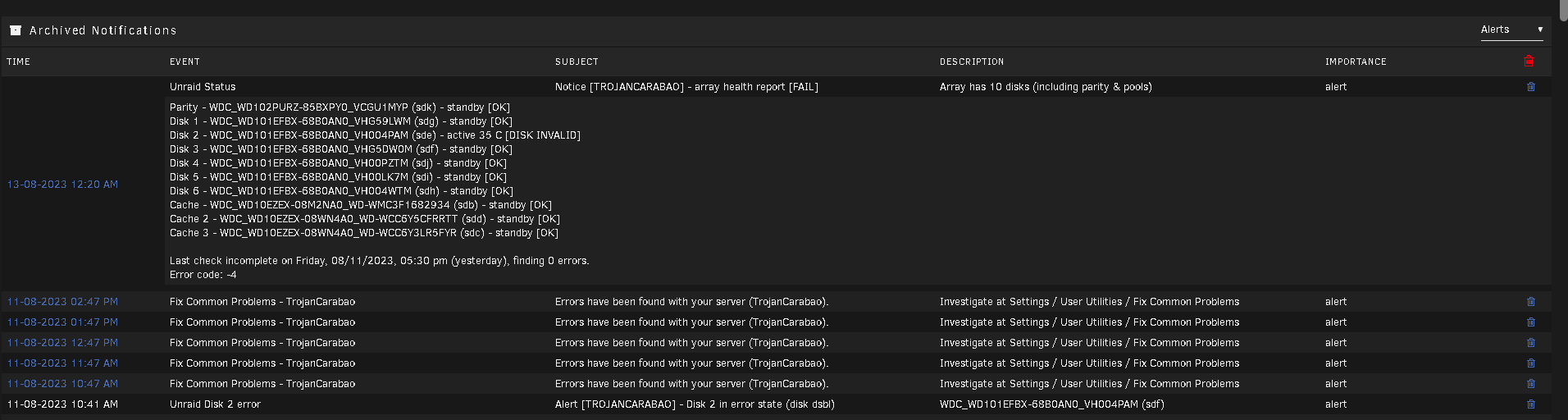

Hi so I bought 2 new HDDs I pre-cleared both, but and after a day of use one of them got an error. I have a feeling it might be because that drive is hooked up to my HBA which I think might be faulty. I set the server to maintenance mode and I'm running an extended test. I'll run XFS Repair after and send both the test and diag here when I'm done.
