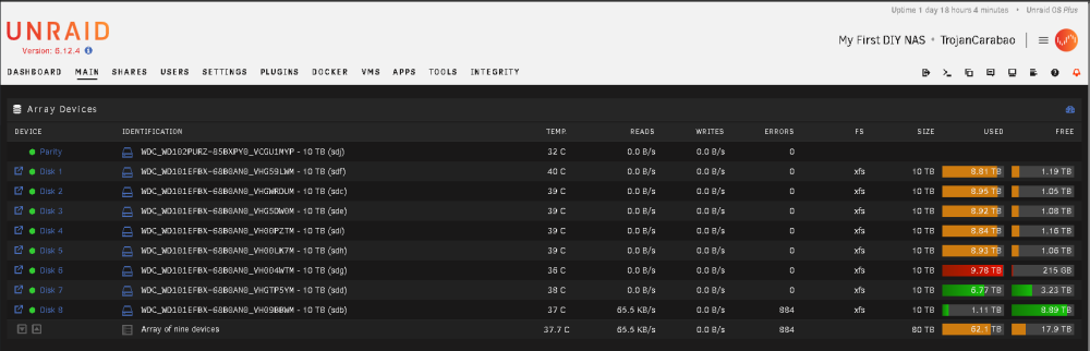

I left the system doing the Unraid Data-Rebuild and went to sleep. When I woke up the next day it seems that halfway (55.8%) through the rebuild it stopped and the new drive had the status "Device Disabled, Content's Emulated". Since this was the status of the  new HDD(68B0AN0_VH004PAM) that I was replacing with the new drive I checked Alerts/Warnings/Notices and found this under warning:
Event - Unraid array errors
Disk 2 - WDC_WD101EFBX-68B0AN0_VH004PAM (sdf) (errors 1024)
Subject - Warning [TROJANCARABAO] -
Description - array has errorsArray has 1 disk with read errors
Importance - warning

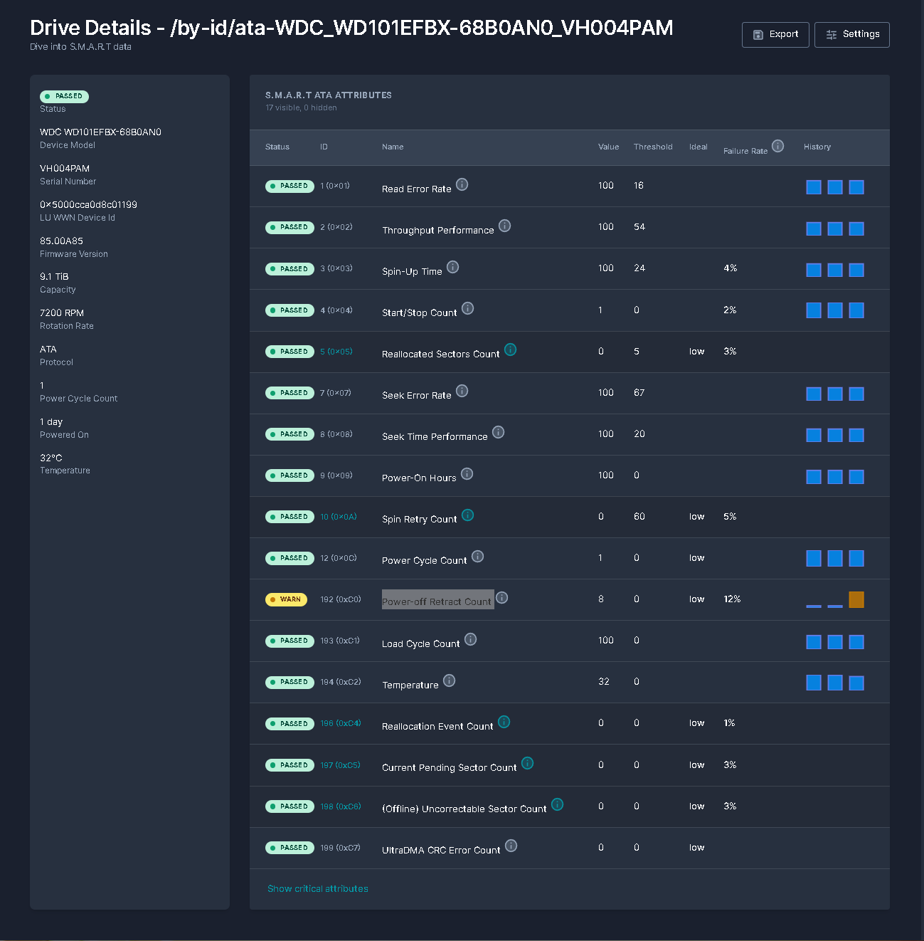

Also I check Scrutiny which I had running and it said that the HDD was throwing this
Power-off Retract Count 12%
I tried checking running as short SMART Self Test on the HDD but it wouldn't start. Since the error was Power-off Retract Count I tried replugging the SATA power (sorry was panicking at this point).

Since I can't do a SMART self test I'll attach my Diagnostics and the screenshot of the drive stats from scrutiny and then just pray someone replies soon.

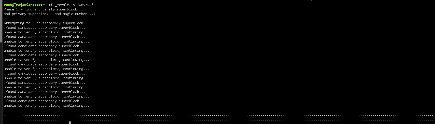

Is this the correct syntax?
xfs_repair -v /dev/sdf
No see the link: check filesystem.

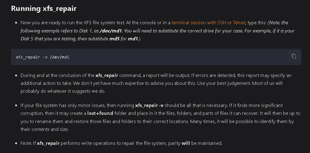

That is on the link.
So it's not possible to substitute it with the sdf at the end of the drive name?image.png.26a57d4ec0990e3954f5e140756306d9.png
Unless I have to us that "md1" system. I have no clue to to look that up in my system.
I tried it but it didn't work. Can you help a brother out?
xfs_repair -v /dev/md2
Can you help me out please?
Edited by Nanuk_
Normally one would run this from the GUI so you do not select the wrong device name by clicking on the drive on the Main tab.
With the 6.12.x releases you now have to include the partition number even with the ‘md’ devices (e.g. /dev/md2p1).    The documentation on running via the CLI needs updating to reflect this.
Sorry if I sound irrate, thanks for the help. I'm just having a monumentally bad month.
Can I ask how I can look up the  partition number even with the ‘md’ devices (e.g. /dev/md2p1)?
It's always p1, mdX refers to disk number, so for example disk 10 would be md10p1

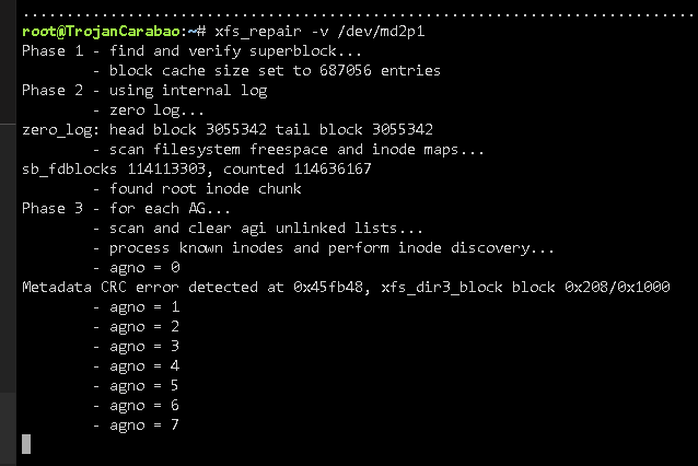

Thank you so much @JorgeB! That worked for me! I ran
xfs_repair -v /dev/md2p1
