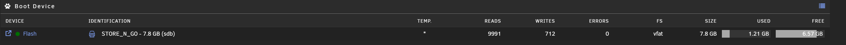

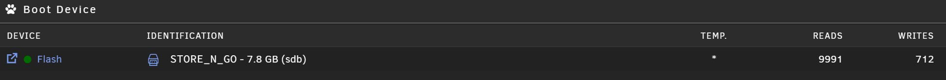

Make sure you are not using the drive for any type of temporary storage.  Look at the count of read/write operations on the flash drive.  This is what mine looks like after being up four days:
'Writes" are normally the critical item you should be concerned about.  A drive that is corrupted by 'reads' is just plain defective.  Writes are what 'destroys' flash drives.

Once the rebuild is finished I'll double check, but I'm reasonably sure it's in a 2.0 port.  My writes look similar to yours though...
But your system has been up only a few hours.  Check those counts after it has been running normally a few days.  You could have a Docker app (or even a VM) using it a 'scratch pad'.
