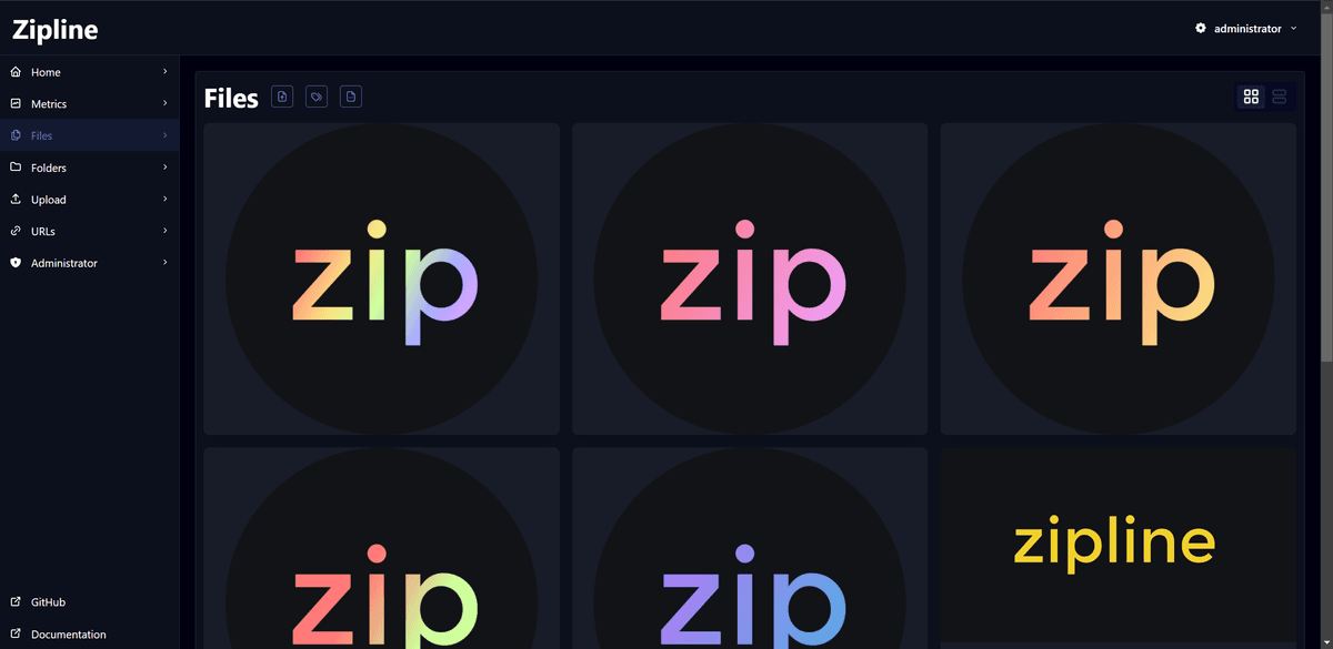

Zipline Features
  • Lightning fast
  • Built with Next.js & React
  • Seamless integration with ShareX/Flameshot
  • Image uploading and compression
  • URL shortening, text snippet & file uploads with code highlighting, image sharing service
  • Token protected uploading with optional password protected uploads
  • URL formats (uuid, dates, random alphanumeric, original name, zws, gfycat -> animals adjectives)
  • Gallery viewer and multiple file format support
  • Fully customizable Discord webhook notifications
  • OAuth2 registration (Discord and GitHub)
  • And much, much more!
Screenshots
Spoiler
