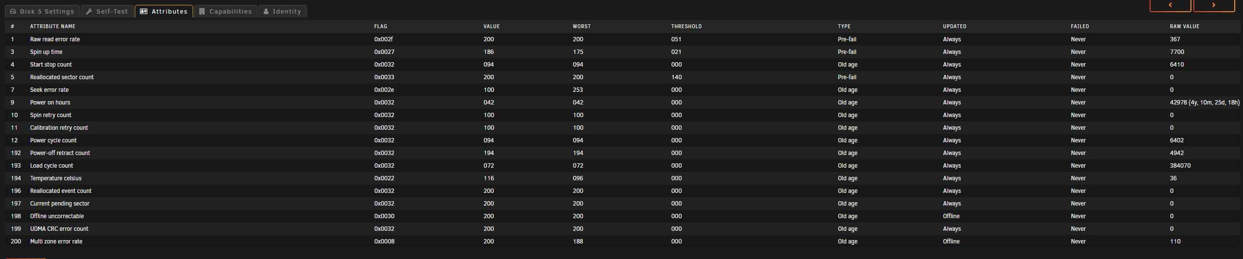

September 1, 20233 yr Author 14 hours ago, itimpi said: No correcting check required if 0 errors . well we came back with errors again.. same disk.. going too try swapping too a different tray if that doesn't do it im assuming bad drive? heres diag just incase but appears too be the same errors poseidon-diagnostics-20230831-2034.zip Edited September 1, 20233 yr by Lassley7
September 1, 20233 yr Community Expert SMART doesn't look good for that disk, you can also run an extended SMART test to try and confirm if it's really bad.
