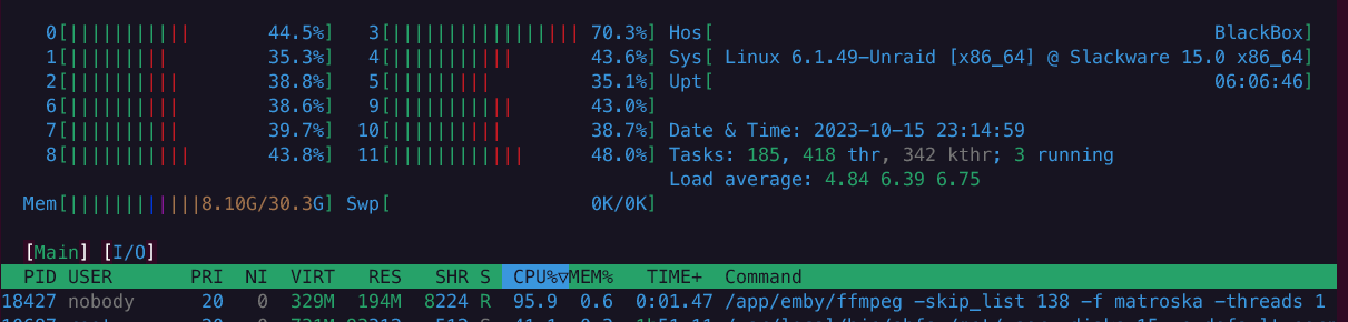

For example I setup everything in htop
But it looks like stored somewhere else.

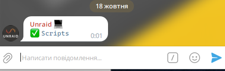

Wrote such script and scheduled "At Startup of Array". Checked - works.
Hope /boot/config/my_custom_scripts/ is ok place.
Will add one more and schedule "At Stopping Array"
