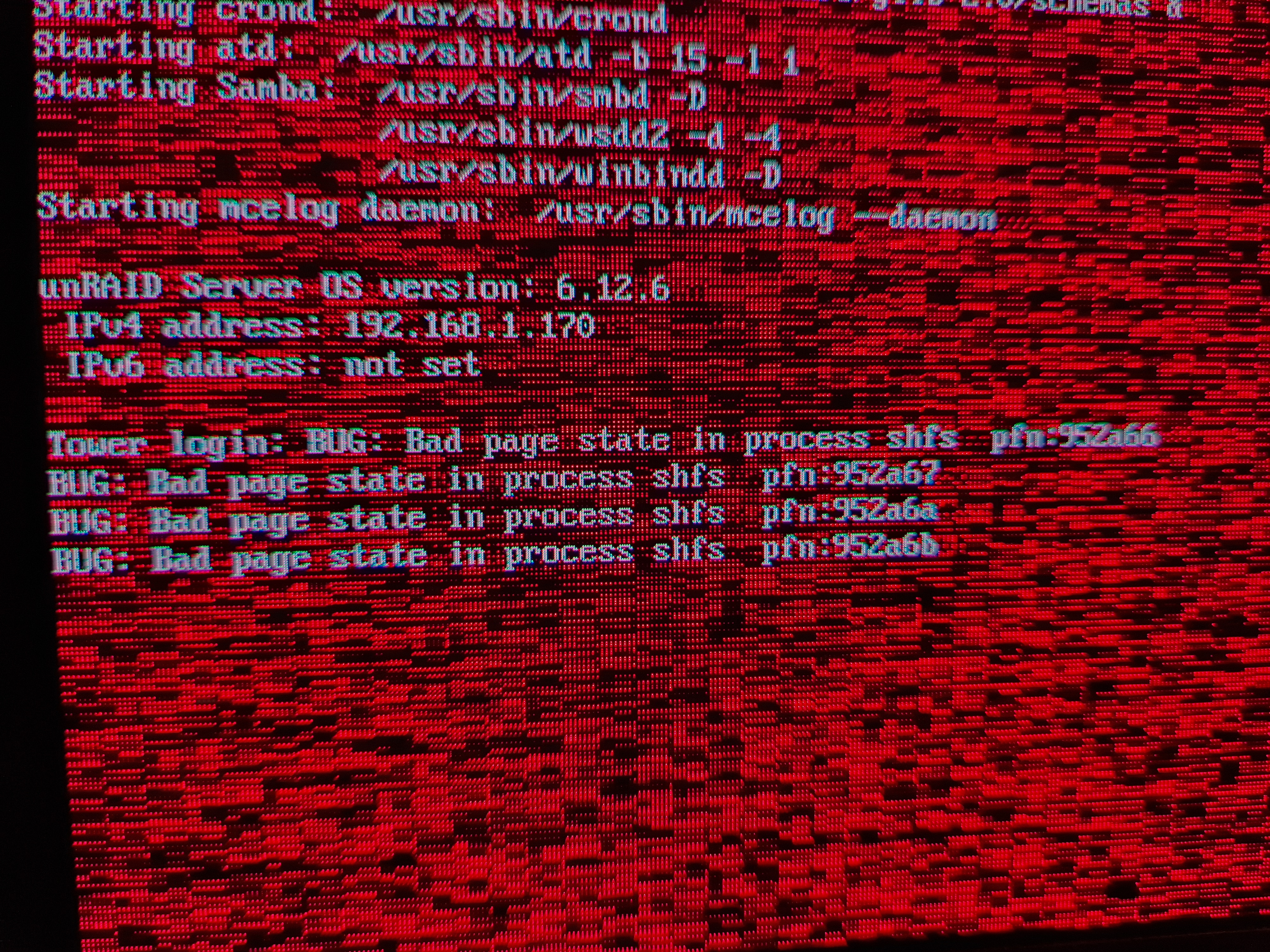

I was about to say things were looking good since I switched qbitorrent to use libtorrentv1 instead of libtorrentv2, but I encountered a crash while doing something else.

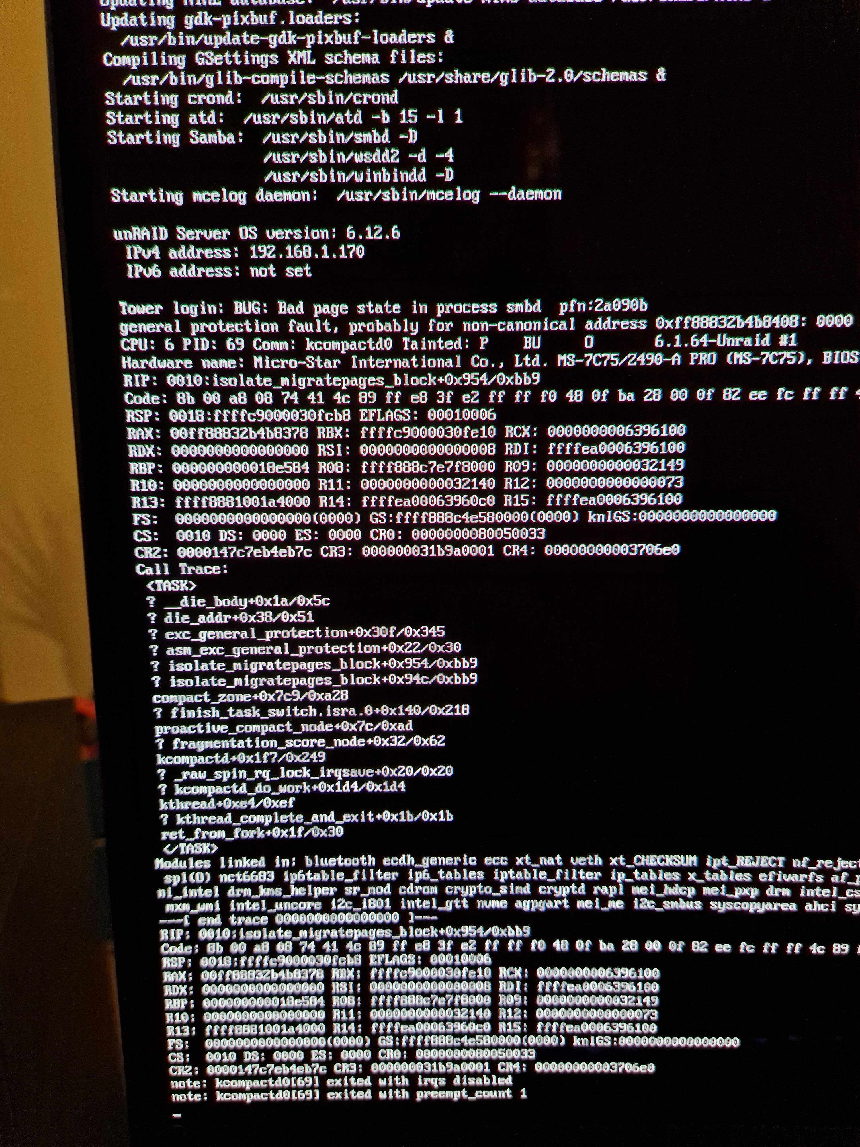

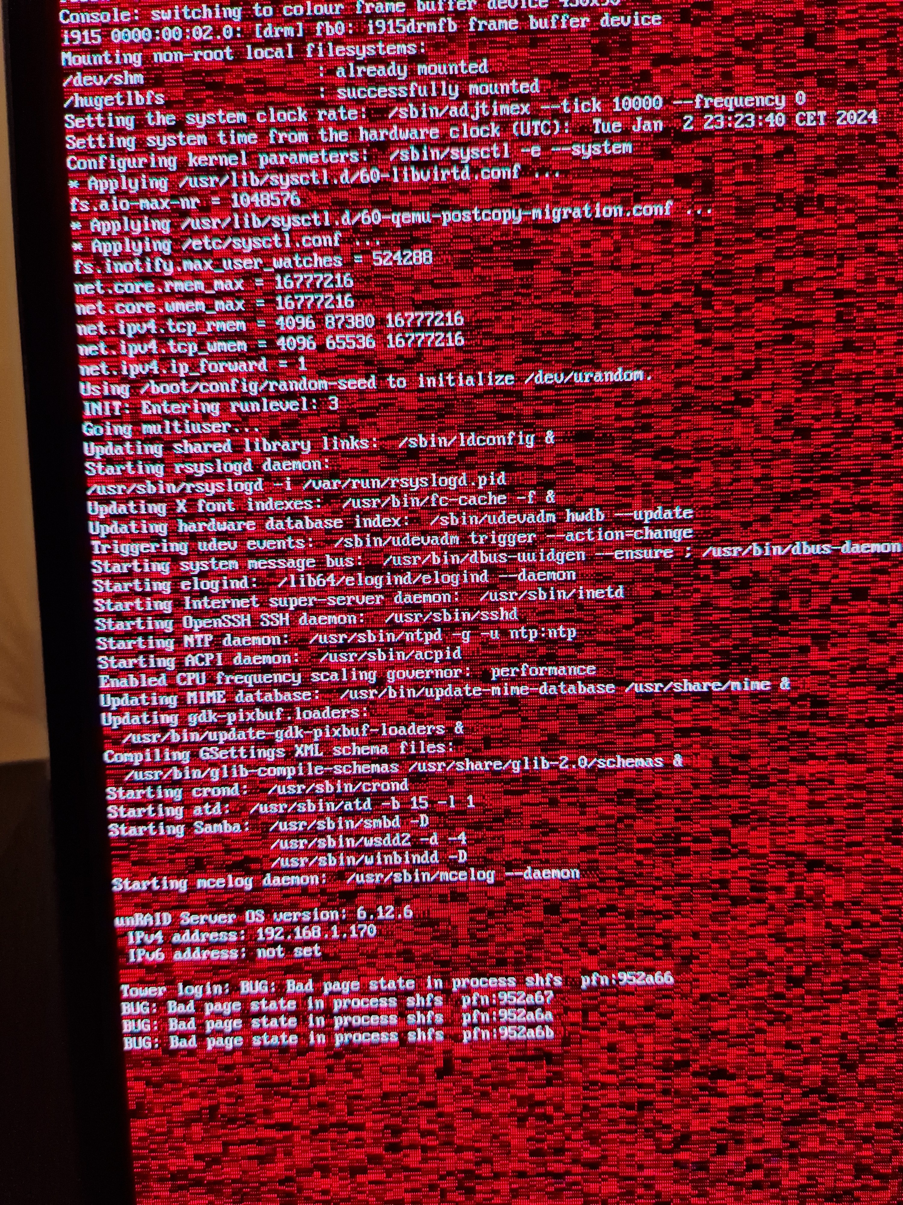

The problem is reproducible 100% of the time. I had attempted to copy over SMB a large (125GB) file from my NVMe-equipped desktop to my NVMe Unraid cache pool; so as to test the SSD's SLC cache limit. However, at some point during the copy process, throughput falls to zero and Unraid crashes in the following seconds.
I haven't included the syslog or diagnostics, because there's no errors. Nothing. Only the console hooked up to the server has info:
Crash 1 starts with:
BUG: Bad page state in process shfs pfn:952a66
Crash 2 starts with:
BUG: Bad page state in process smbd pfn: 2a090b

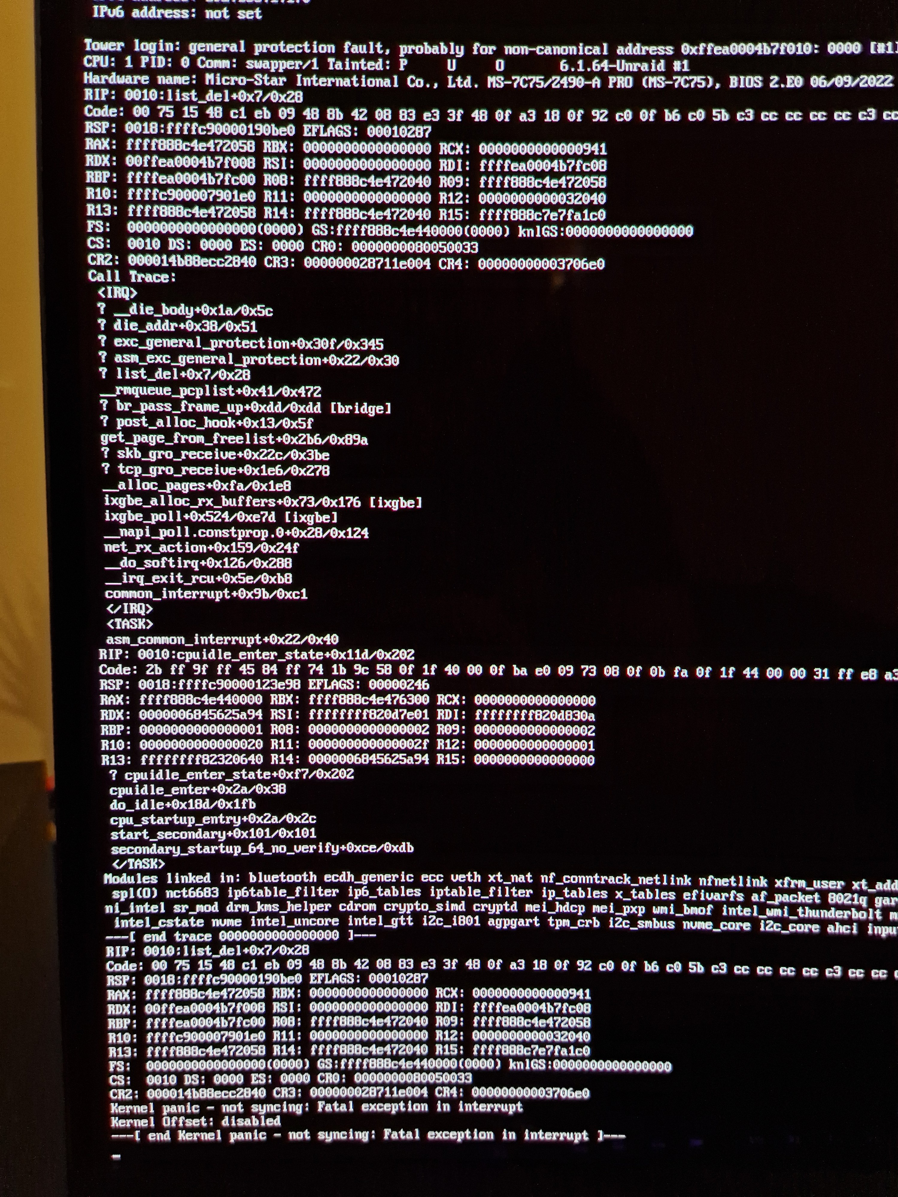

Crash 3 starts with:
general protection fault, probably for non-canonical address
Most crashes end with a kernel panic. Others are an endless loop of trace calls.
What makes me think it is related to the issue I posted here for, is the fact that disabling docker seems solves the issue entirely. I have not been able to reproduce the crash with docker disabled. I can copy the 125GB file over SMB back and forth with no issue, and it fully saturates my 10G network (1,2GB/s).
Yet unlike in my previous comments, the syslog is completely clean. So it can't be the same issue? And what makes the issue reproducible every single time; why is a large file over SMB what triggers the qbitorrent kernel panic? SMART data shows the SSD is only at 20TB written out of a marketed life of 200TB. The few attributes I get seem to indicate all is normal. The Crucial P1 is known as a hot running drive, but unreliable it is not. I will be purchasing another NVMe drive to rule out the hardware side - needed a second drive for parity on the cache pool anyways.
For now I'm just confused. I thought I had narrowed down the issue, but a whole other can of worms is now open. Any help is appreciated.
Never mind, it now crashes even with Docker disabled when sending the test file. I guess it has to be a different issue then.
Gives the same error though:
