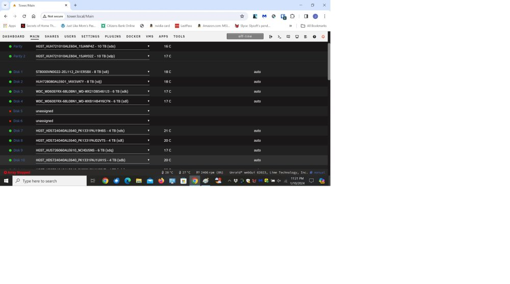

Good News, I think.  I believe I can try the rebuild now.
You can first unassign both new disks, then start the array, to confirm the emulated disks are mounting before rebuilding, they may need a filesystem check, and if they do, better to do it before to make sure it works.
