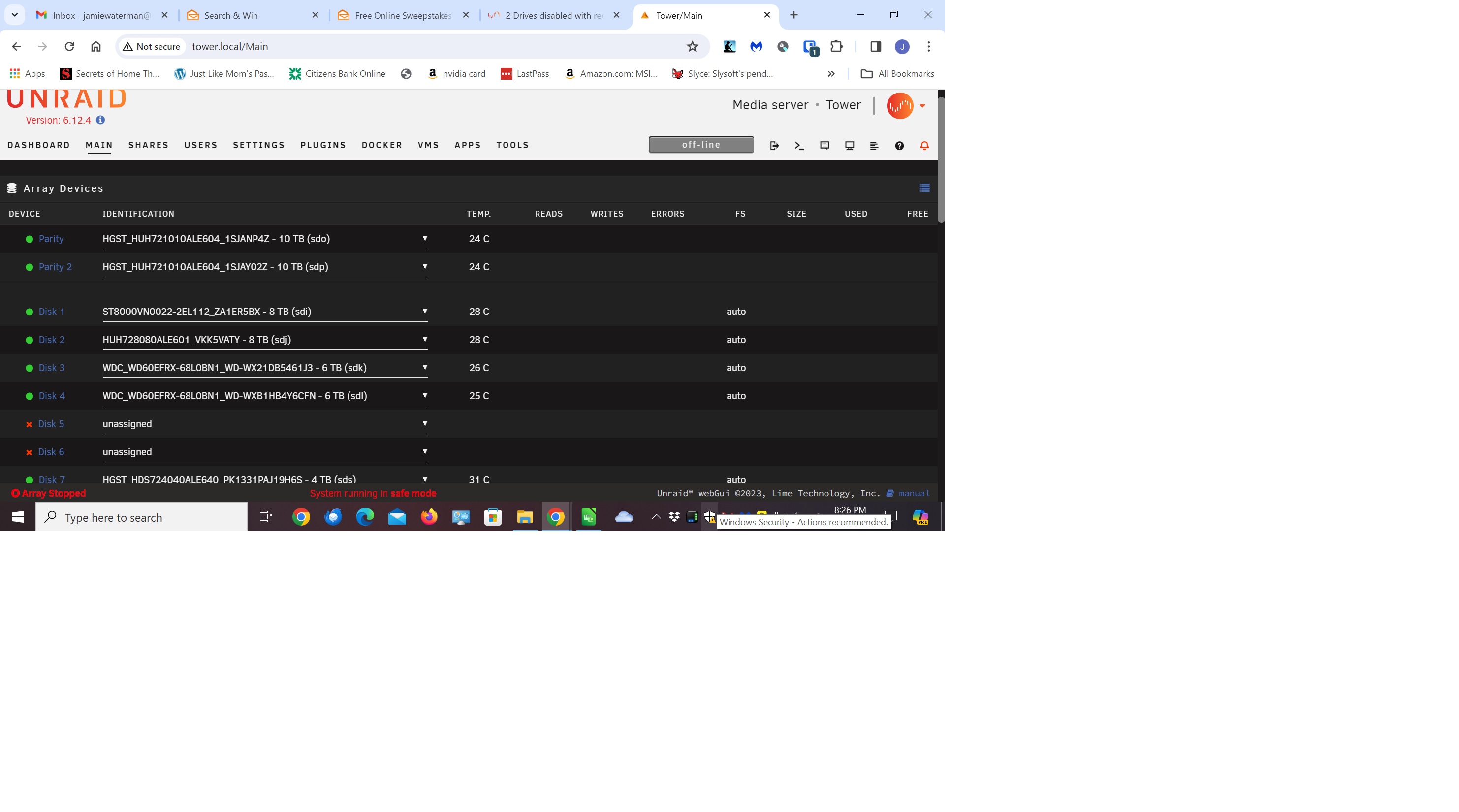

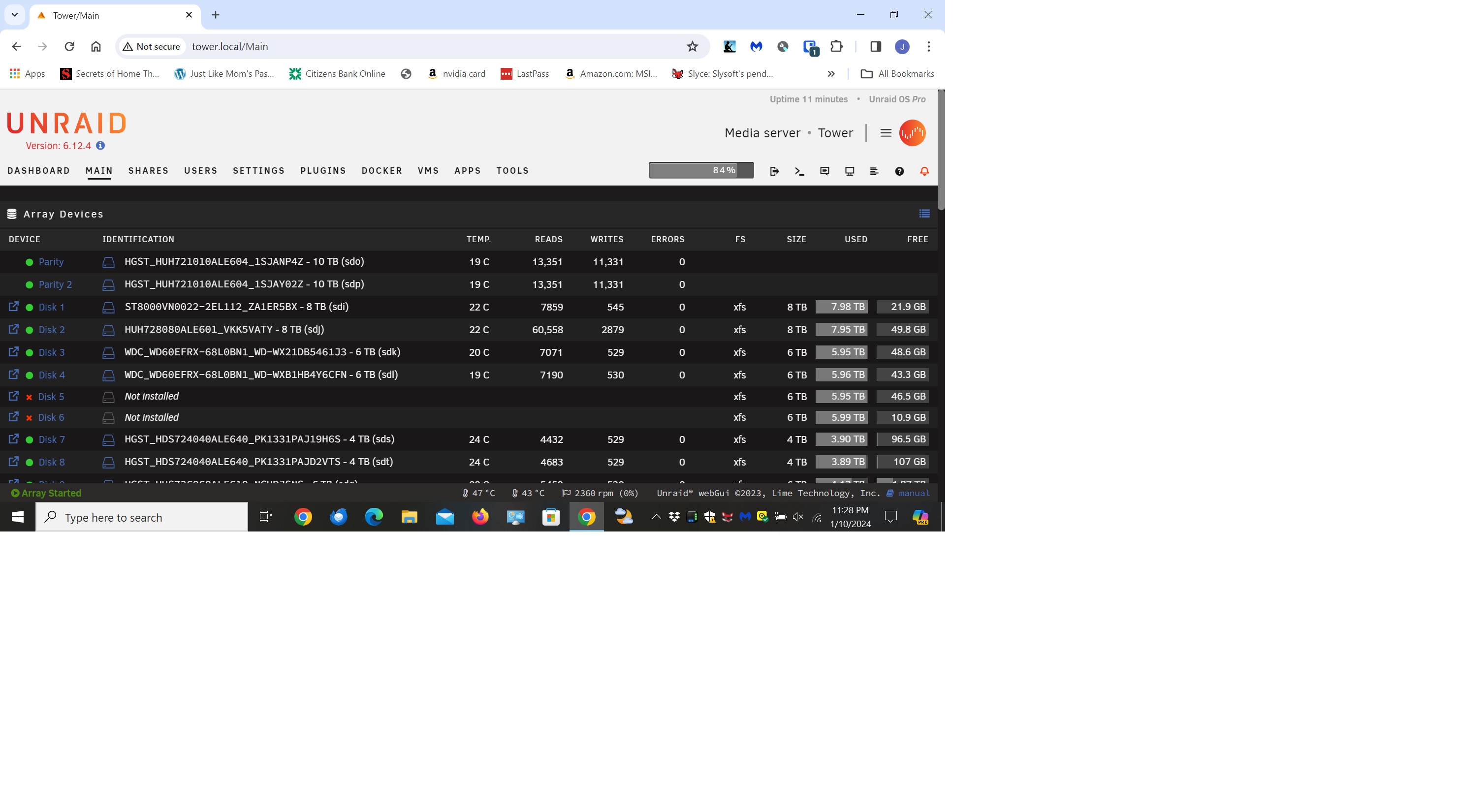

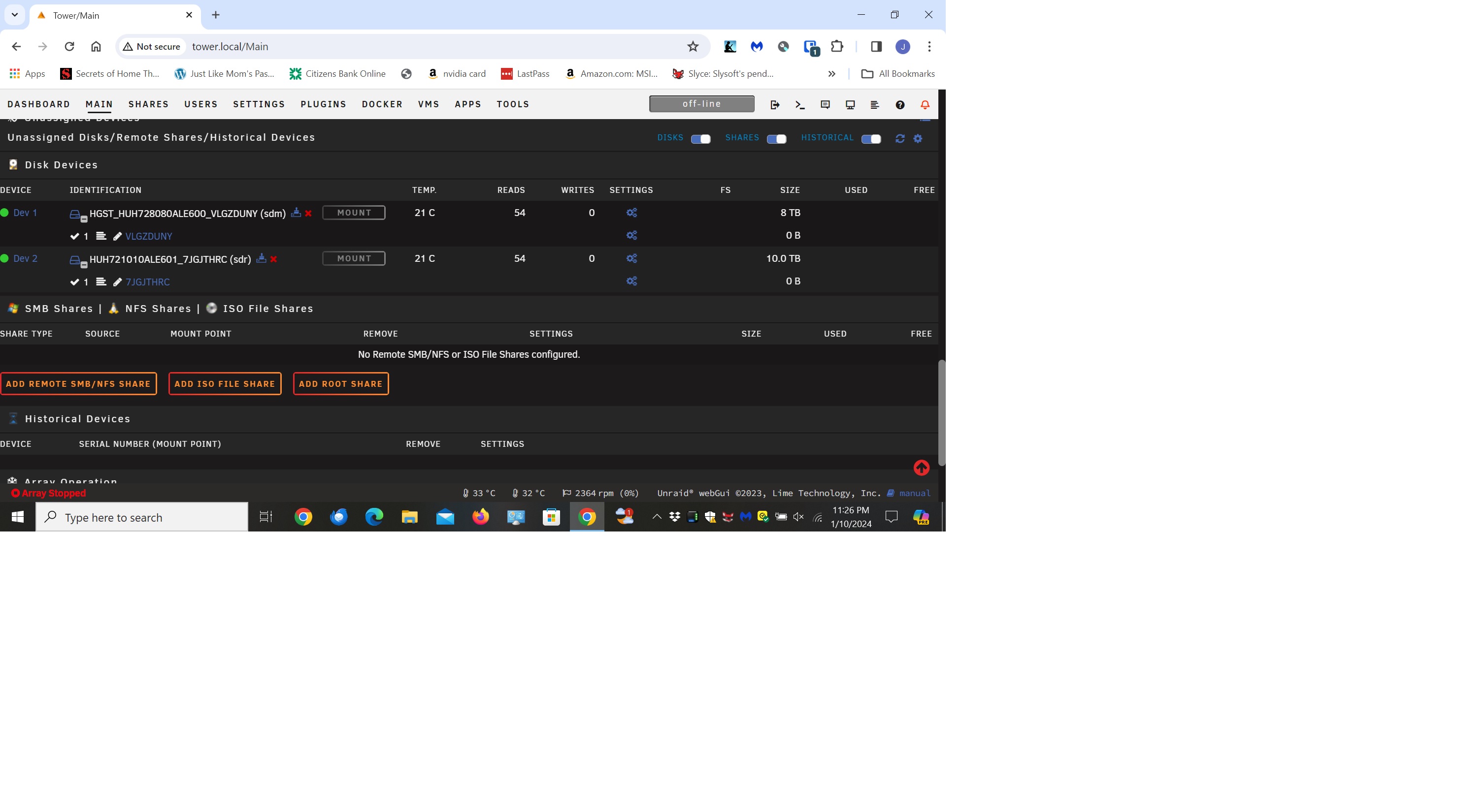

I have two drives that had errors and while I procured two new drives and precleared them, they became disabled and now refuse to be assigned to the new drives that are now in the drive bays where the disabled drives were located. The two new drives have a preclear signature.
When I try to assign the drives, I select the drive in the “unassigned” drop down, the screen refreshes, and the drives remain unassigned.
This started to occur two months ago and I have had my server off and on while I researched the issue and tried to resolve the issue through responses to other forum posts. I have exchanged the SATA cables to see whether that was the issue because I received a udma error before this all started, but it didn’t help. I noticed that the drives show up in the servers BIOS but when I start the unraid array the two drives, 5 & 6, show as “not installed”. The data for the drives still appear when I click on the devices, “drive 5” and “drive 6”. A red x appears beside each drive. I also click on the unassigned devices mount button for each drive but the buttons do nothing.
I am at a lost as to what to do now and I am worried that I will lose the data for the drives. Is there a way I can recover the data from parity and is there any solution for a problem like this situation that I now find myself? I have attached a system log, and diagnostics attached to this post. I also have screenshots of what I see on my unraid server.

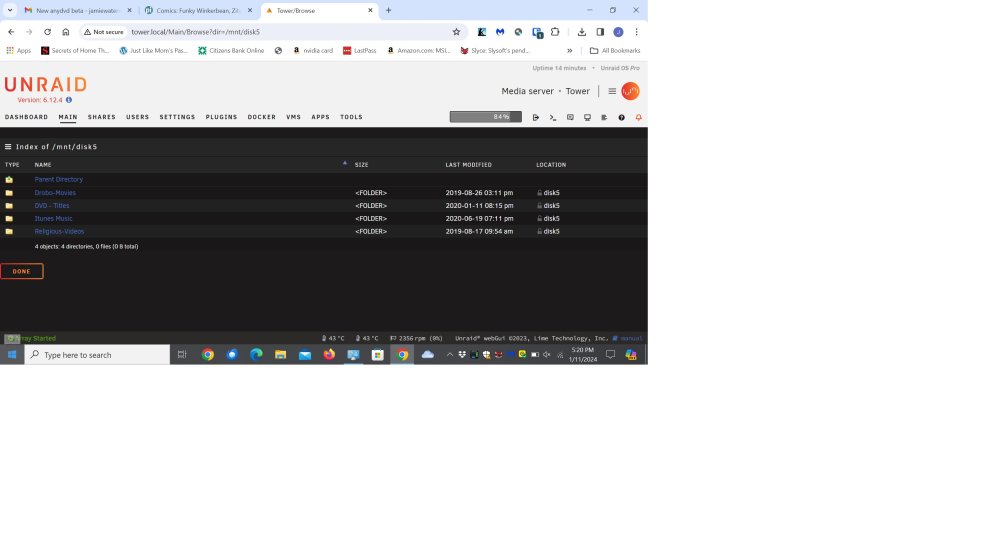

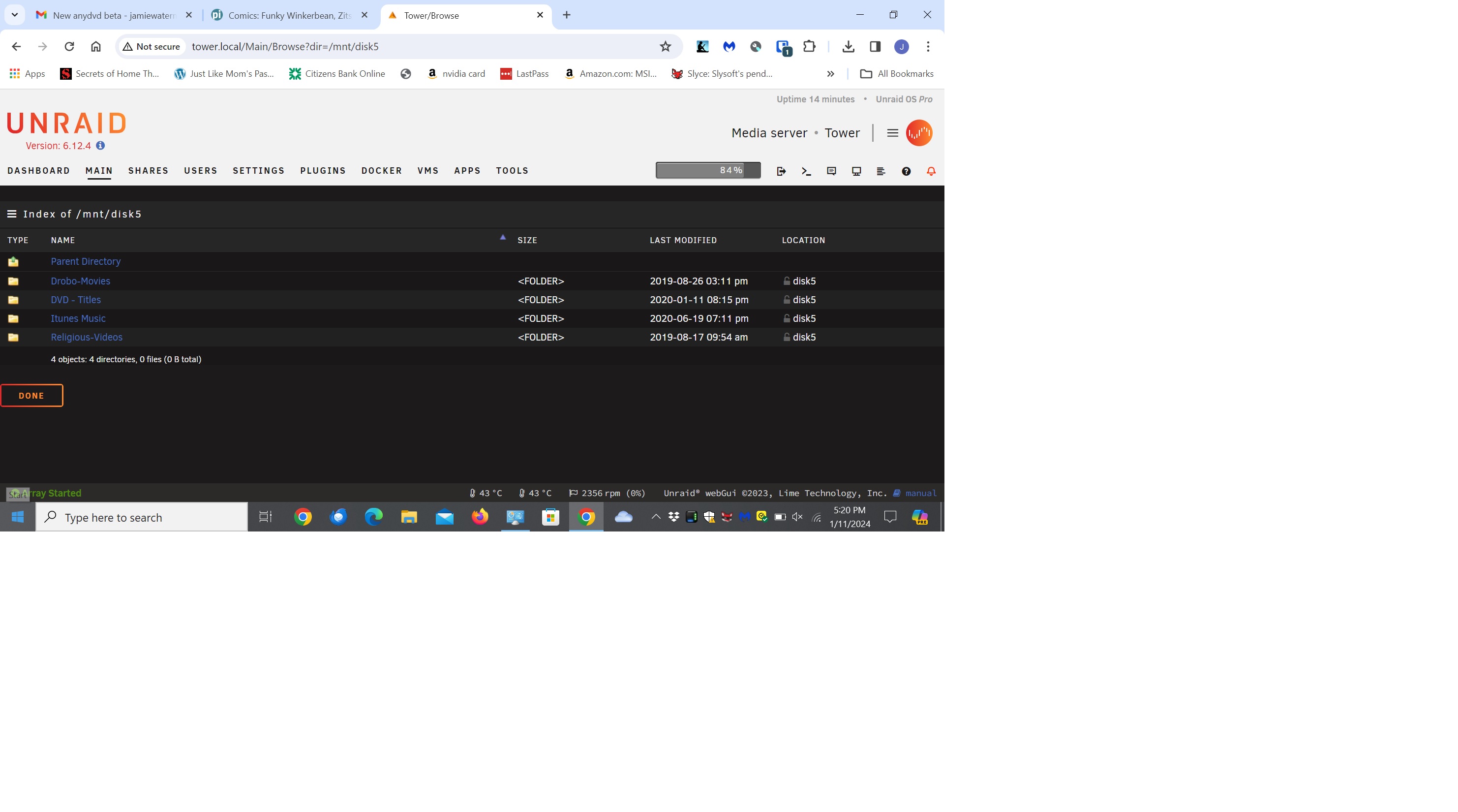

Oh, yes.  You should not have lost any data as you have dual parity.  The data of those two missing disks is actually available as these two disks are being emulated using the parity disks and the remaining data disks. That means you can both read and write data to them!  When the disks are rebuilt, that emulated data will be written onto the new disks.)
Yes., I have tried firefox and chrome.  I will try logging directly into the gui without using a browser.
When I do #5 I assign one of the disks to one in the dropdown and the screen refreshes and the drive I try to assign the dropdown disk to remains unassigned.  I never see a checkbox.
I have a feeling that something is corrupted in the unassigned devices plugin or unraid.  I just can't seem to figure out what happened and how to fix it.  I have replaced drives in the past with no issue.  I have never seen a disabled disk warning before, or have "not installed" message after starting the array.

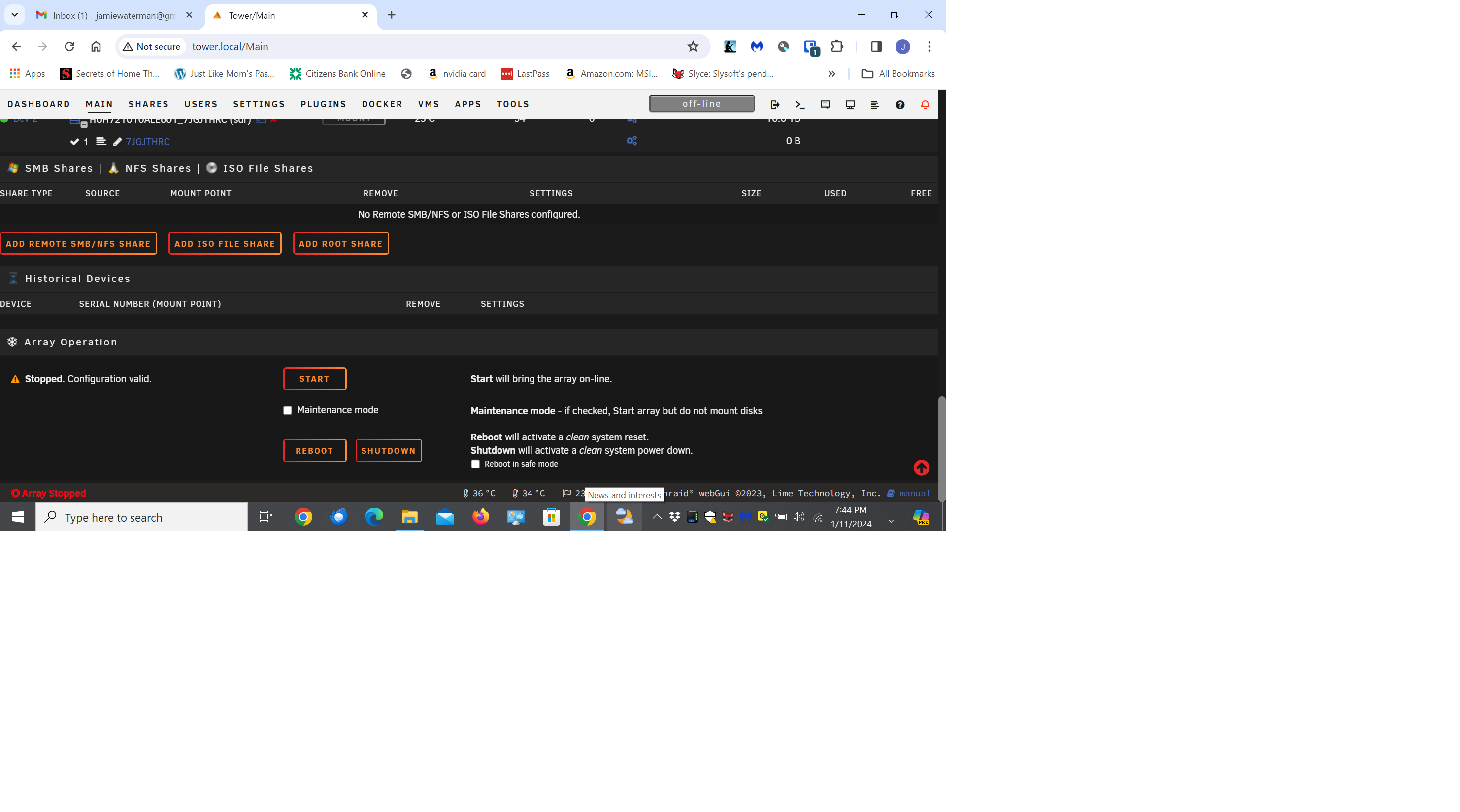

Stop all Dockers and VM's and prevent them from starting automatically.  Reboot the server to the 'Safe Mode' (an option in Unraid's Boot Menu) and see if that works.
FYI,  I tried booting directly into the gui.  Not using the headless browser method from my laptop.  Same results

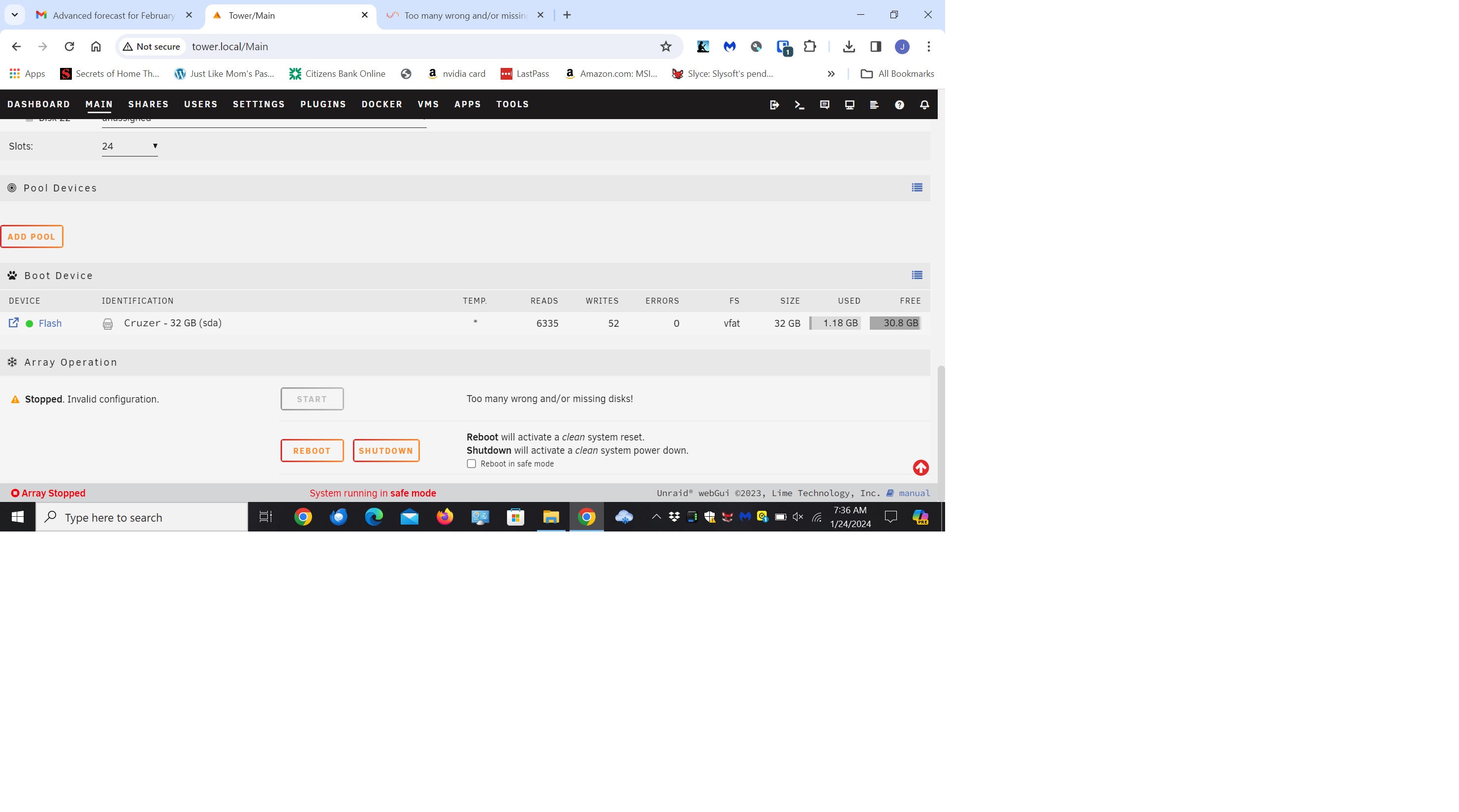

I shutdown my vms and plugins and turned them off so that they do not start on reboot. I clicked the safe mode checkbox and rebooted.  I tried to assign each device but both devices still refreshed and remained unassigned

Missed that, I would try with a new flash drive using a stock install, no key needed, just boot and test if you can assign devices, don't start the array.

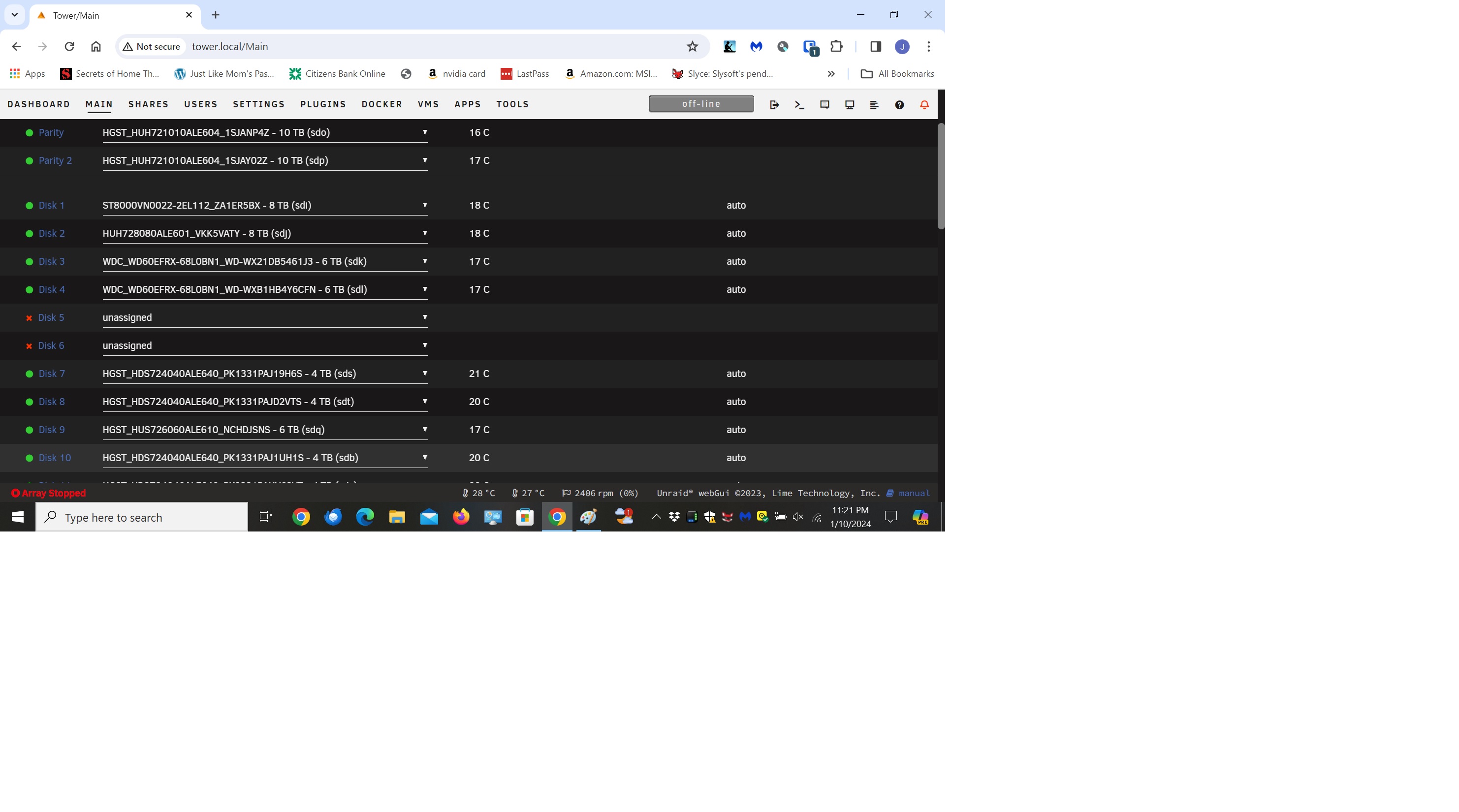

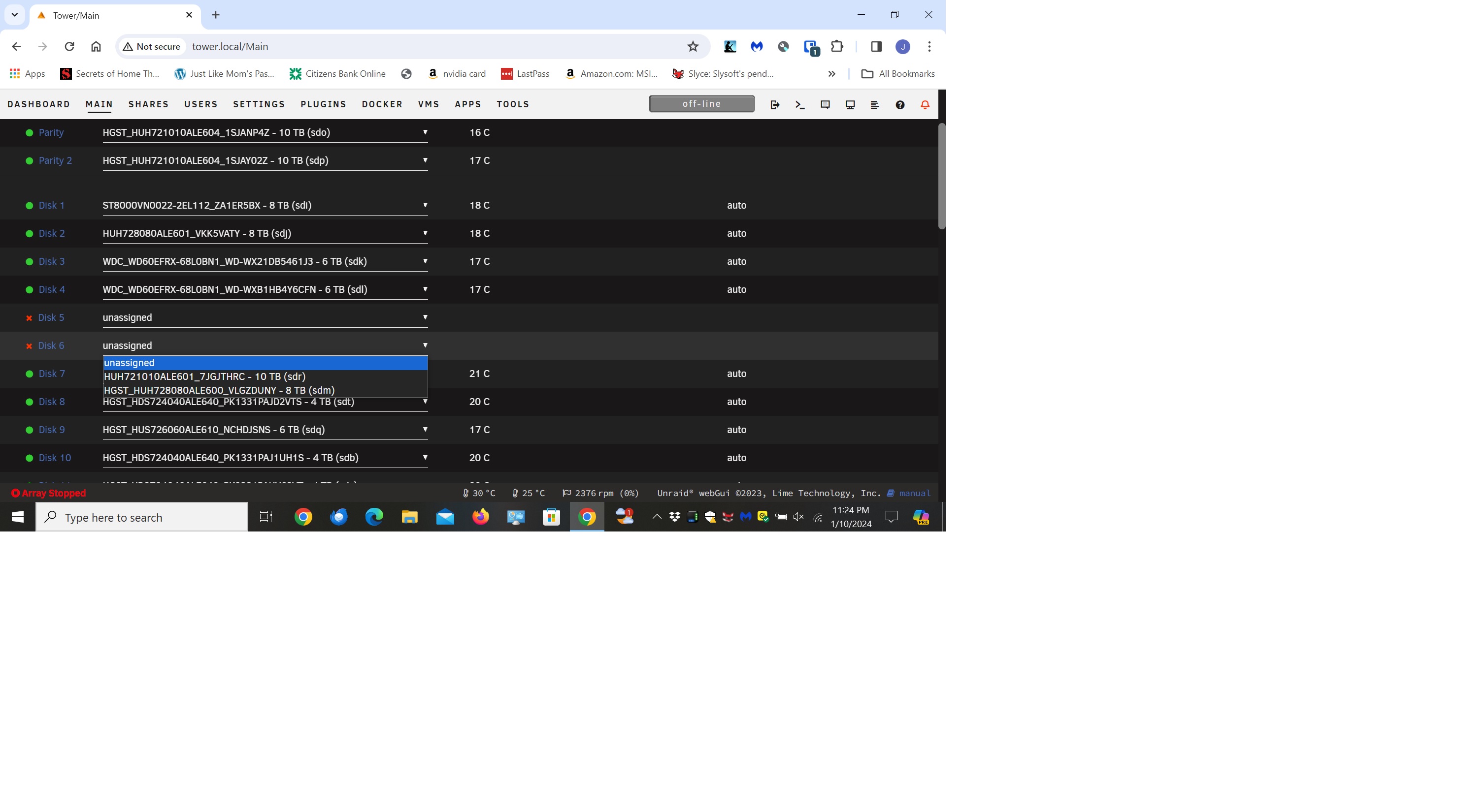

Okay,  I created a stock trial key and booted directly into the gui.  Not headless.  I was able to assign the two drives that I have not been able to assign with the licensed usb stick.   I have done nothing else and I am waiting for more guidance.  I am happy to see some progress.
That suggests something in your /config is causing the issue, you can backup the current flash drive first and then redo it and just restore the bare minimum, like the key, super.dat and the pools folder for the assignments, also copy the docker user templates folder, if all works you can then reconfigure the server or try restoring a few config files at a time from the backup to see if you can find the culprit.

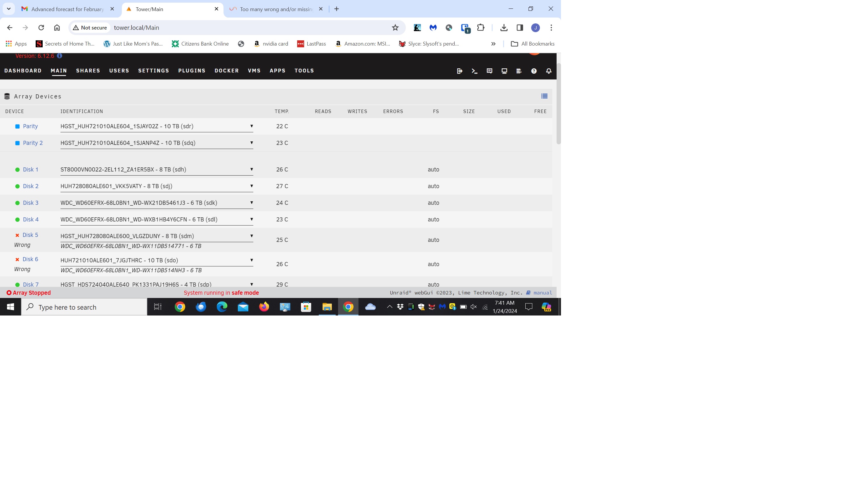

Just an FYI.  My parity drives were on the second card and when I booted up into unraid, my Parity disks were unassigned.  I reassign them to the proper drives.  I also assigned the two replacement drives to drive 5 & 6.  I am now getting a "too many wrong and missing drives" message near the start array button and the array won't start.
Do I just create a new config and accept a loss of data, or am I already screwed anyway?
I attached 2 screenshots of what I see and a diagnostic.
tower-diagnostics-20240124-0748.zip
