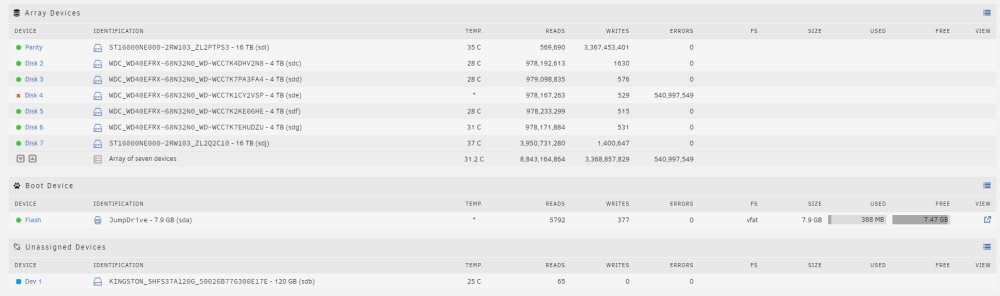

OK. I've plugged the old Disk 4 back in, rebooted, and restarted the array. I did not assign Disk 4 so it still says contents emulated, but I can see the drive as a new device.
I've attached the new diagnostics.
storage-diagnostics-20240126-1728.zip

This disk? SMART looks fine for that one. Since we don't have logs from when it became disabled, just a guess it was a bad connection.
Were you careful with all connections when putting that disk back in? Might want to double check.
You can rebuild disk4 to that same disk.
