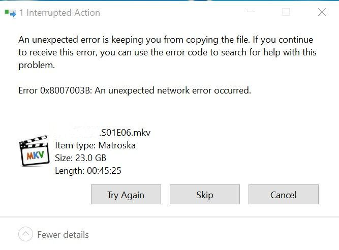

Over the last 2-3 weeks I've noticed an issue transferring larger media files from my Windows PC to UnRAID. I don't use a cache drive yet, so there files can take a while to transfer. However, over the last 2-3 weeks I've had a couple of files (ranging in size from 20-28 GBs) seemingly stop part-way through the transfer, and finally fail the transfer due to timeout. Sometimes I've seen this happen (only for the file transfer to re-commence from where it was stuck after 30-50 seconds).
I had this behavior happen to me once before about 3-4 years ago, and the issue was resolved instantly by replacing the ethernet switch the UnRAID server is directly connected to in the room where the server is kept. However, I must have just been lucky last time. This time I replaced the switch again but it didn't resolve the issue, and I also replaced the ethernet cable running from the UnRAID server to the switch, and the issue still remains.
I'm able to transfer smaller files without any problems, but anything from that 20-26 GB file size is currently having this issue. I don't have a need to copy files larger than 20GB right now, but I'm assuming this may also be subject to this issue.

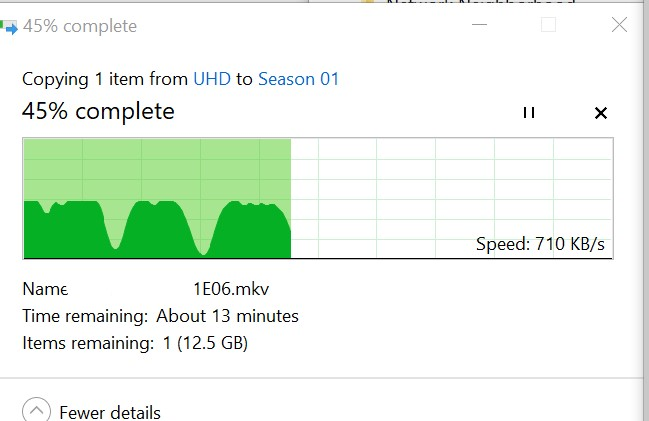

I transferred another file from my PC to the UnRAID server - this time using Windows Explorer. Again, there were several pauses, but the transfer recovered...until a final pause that lasted around 60 seconds, and the transfer failed "unexpected network error". I tried again, and it failed again - different part of the file but same failure reason "unexpected network error".

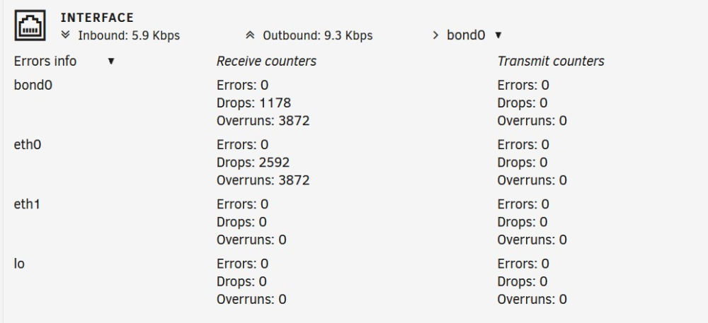

Done. Rebooted UnRAID server and tried a file transfer - still paused several times and recovered, but transfer failed on the last pause.
Something I noticed, and didn't think to mention until now - I have the main UnRAID window up while doing the transfer, and even though the Windows file transfer shows the transfer has paused, for a little while after that I can see the 'Writes' numbers for both Disk1 and the Parity drive continue to increment. Once Windows confirms the transfer has failed, the write numbers continue to increment for a short time, but then they stop incrementing. This may or may not be significant, but thought I should mention it.

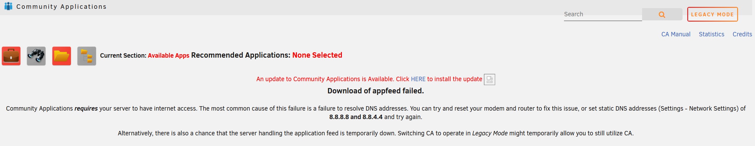

I had to look up how to install plugins, and I see this one is reliant on the Community Applications plugin. I checked on that in the Apps tab, and it looks like there's a problem with the CA plugin retrieving a list of current plugins (see attached screen-shot). In the 'Network Settings' I see the DNS server was set to the same IP address as the IPv4 default gateway - which I thought was correct. I stopped the Docker and VM services, and changed the DNS server values to those suggested (8.8.8.8 and 8.8.4.4), but that didn't seem to do anything, so I changed it back. Also, the screen-shot shows a message saying an update to Community Applications is available, but my current UnRAID version (6.9.2) is too old...which segue-ways nicely to the next point...

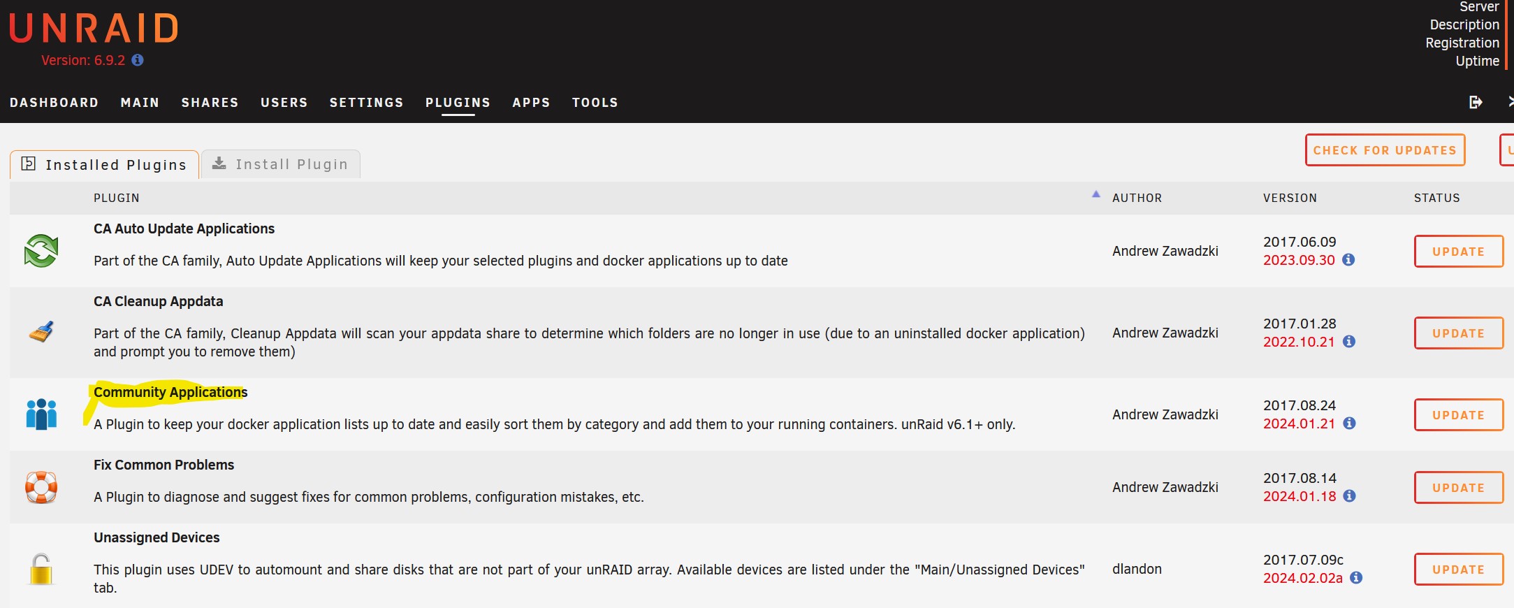

CA is only compatible with 6.12 and later.  It doesn't work on 6.9.X any longer.  I don't know why it says an update is available.
According to my plug-ins tab, I already have Community Applications installed, which may explain the notification. There must have been an earlier version of CA that was compatible with 6.9.2 - it's the only explanation.
QUESTION: So, it sounds to me from what you've said so far, the best way forward is to update the UnRAID OS to the latest stable version as a 'next step'. Is that correct? If so, I'll have to park the file transfer issue, sort out whatever security/access issues that arise, and THEN come back to look at this issue again (IF updating the OS didn't fix the transfer by itself).
Please correct me if I got this wrong.....
You have a copy of CA, but it won't update on 6.9.2.
That is a good plan.

I updated all my installed plugins - including Community Applications
I tried to transfer my larger test file, and it still fails with a pause and a timeout error

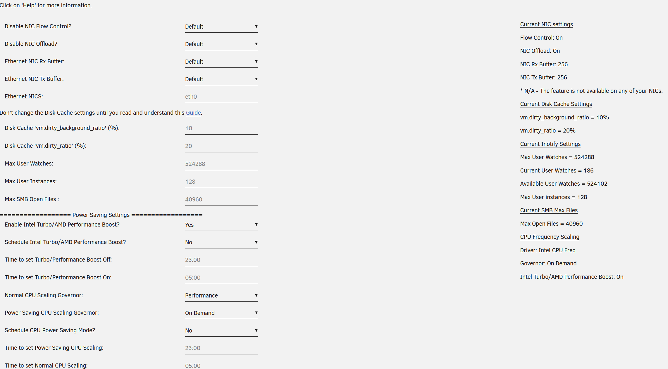

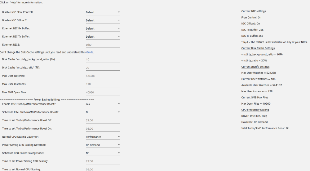

I browsed CA and found the "Tips and Tweaks" plugin, and I installed it
Your original post said to make the recommended adjustments to the NIC and disk buffering settings.  Looking at the output from the plugin - I don't see any "recommended adjustments" per se. There are a list of the relevant settings on the left, and a list of current NIC settings on the right...
I'm not particularly technical - especially in this area. Can you offer a little direction?
Start with these:
And be sure that "Performance" shows for the CPU Governor on the right side.

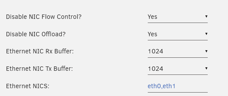

I changed all the settings that needed to be changed as per your instructions above, except for the 'Ethernet NICS' - I'll get to that in a moment.
I applied the changes and tried the file transfer again - still a pause followed by a timeout. That's OK though - I know there are a number of things that need to be tried before we find the culprit for this issue.
OK, so in an earlier post you mentioned setting up a bond and bridge and using both NICs as a solution. Your last post also shows this as a recommended change.
I'm very sorry, but I'm not sure how to do this so can you give some advice? I imagine I'd need to go into the server's motherboard BIOS to enable eth1, and maybe add another network cable from the eth1 NIC port back to the switch (same as eth0)? Please let me know if that's not correct - I've never done this before so any instructions are appreciated.
