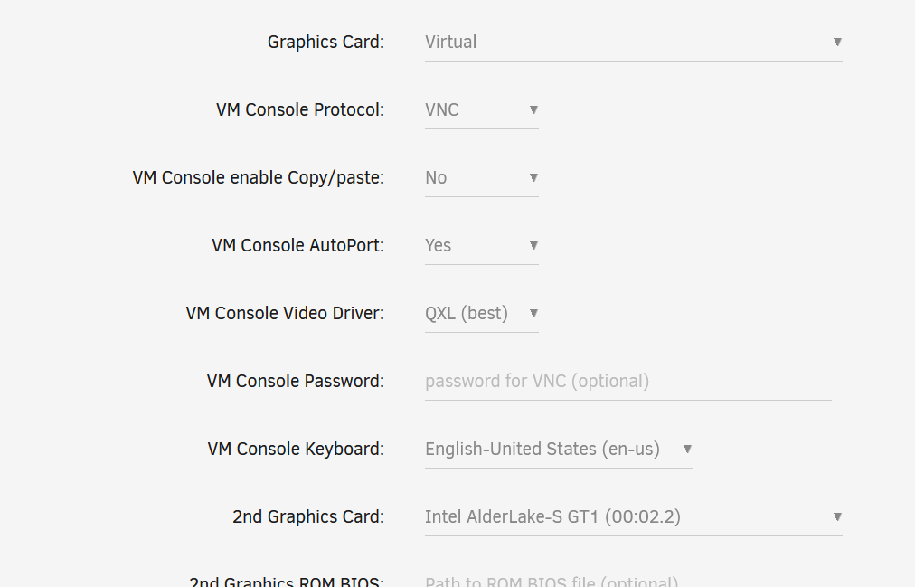

iGPU is configured as second graphics card, to allow VNC to still work properly:

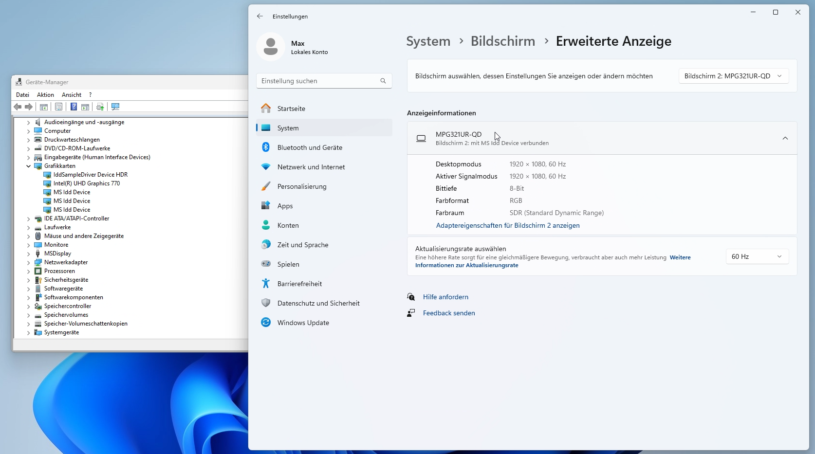

On 2/23/2024 at 1:52 PM, giganode said:
You should also be able to use a real monitor with an hdmi dongle. Still need to verify this though.
I can verify that you can use a physical monitor but you can not use the onboard hdmi/dp ports.
With Intel GVT-g it was possible to use an usb to hdmi adapter. This also works with the new iGPUs, just passtrough the usb device and give it a go..
With my adapter I had to install a driver first, this may not be the case for every adapter.

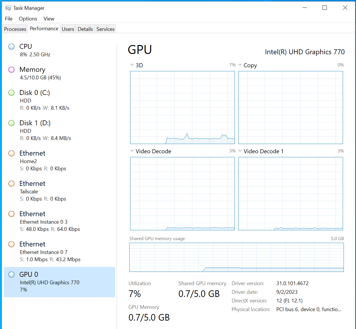

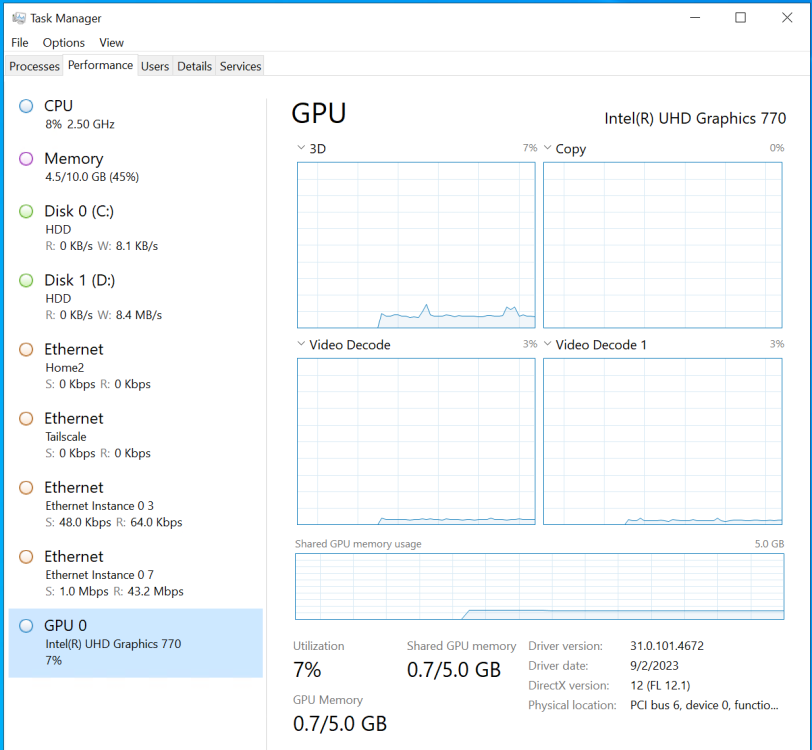

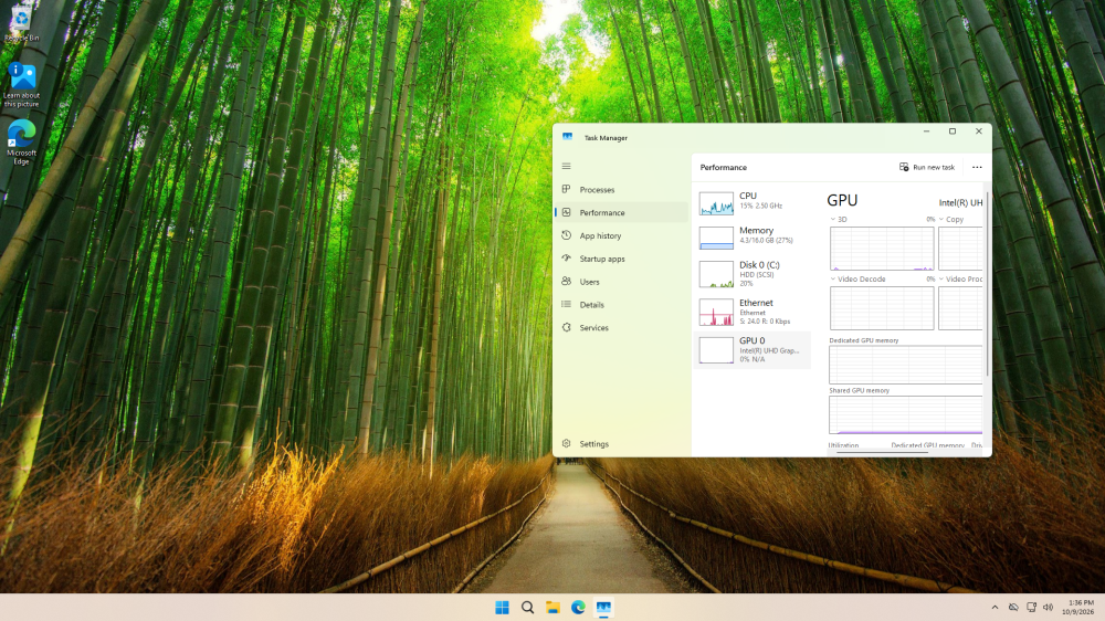

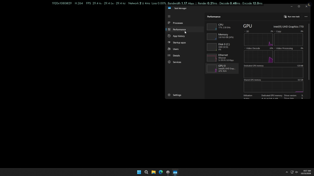

Rocking an i5-12400. I installed the plugin and got the drivers working in my Windows VM. No problems whatsoever.
However, is QSV supposed to work in an SR-IOV setup? It works okay on the host, but in the Windows 10 guest, Handbrake seems to be failing to encode using QSV for an "unknown reason".
Hardware acceleration seems to work perfectly elsewhere. It seems to be just QSV who's messing up. Has anyone had success with QSV?
QuickSync should work. Did you check if device manager reports issues like code 43 or something else?
Sunshine for example uses QuickSync. I can use Sunshine, but handbrake fails on both of my systems, although I know someone with an N100 on which the windows vm can utilize QuickSync in handbrake.

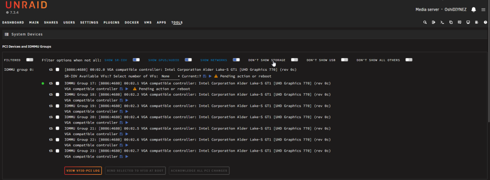

Hi!
With SR-IOV you are able to share the devices resources with VMs. The device is still usable for the host system.
In simple terms, the host and dockers use ..
.. while you passthrough one of these VFs to a VM.
The amount of VFs (Virtual Functions) can be increased if needed and is for example limited to 7 for Intel iGPUs as far as I have seen.

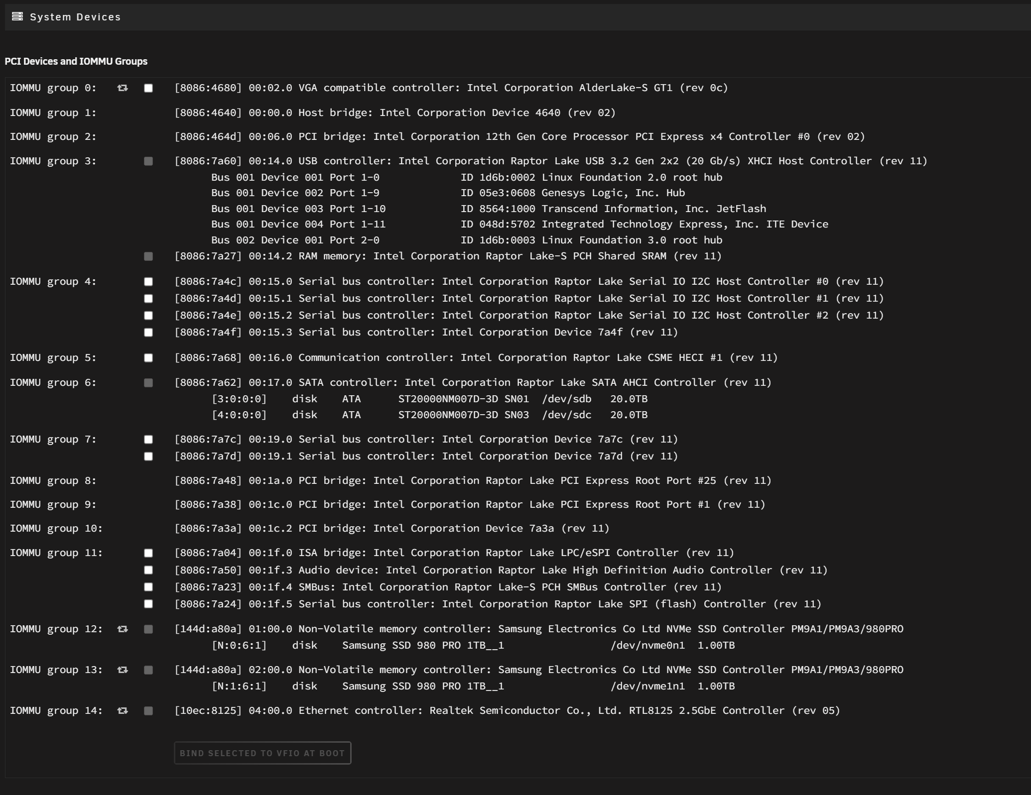

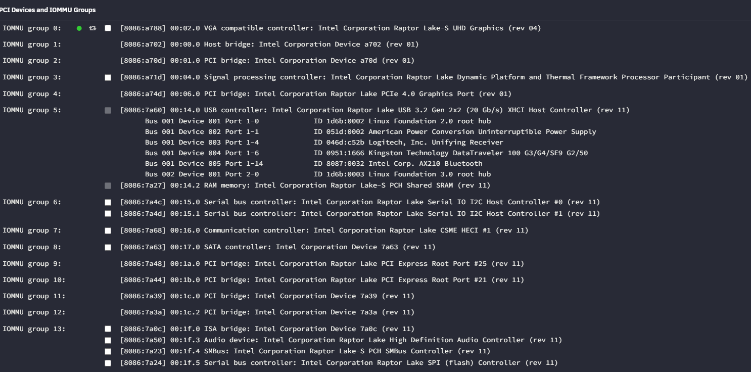

I have a monitor attached to the onboard HDMI port. Perhaps that is the problem ? Should I try an dongle instead ?
41 minutes ago, bucky2076 said:
giga,
Which problem exactly?

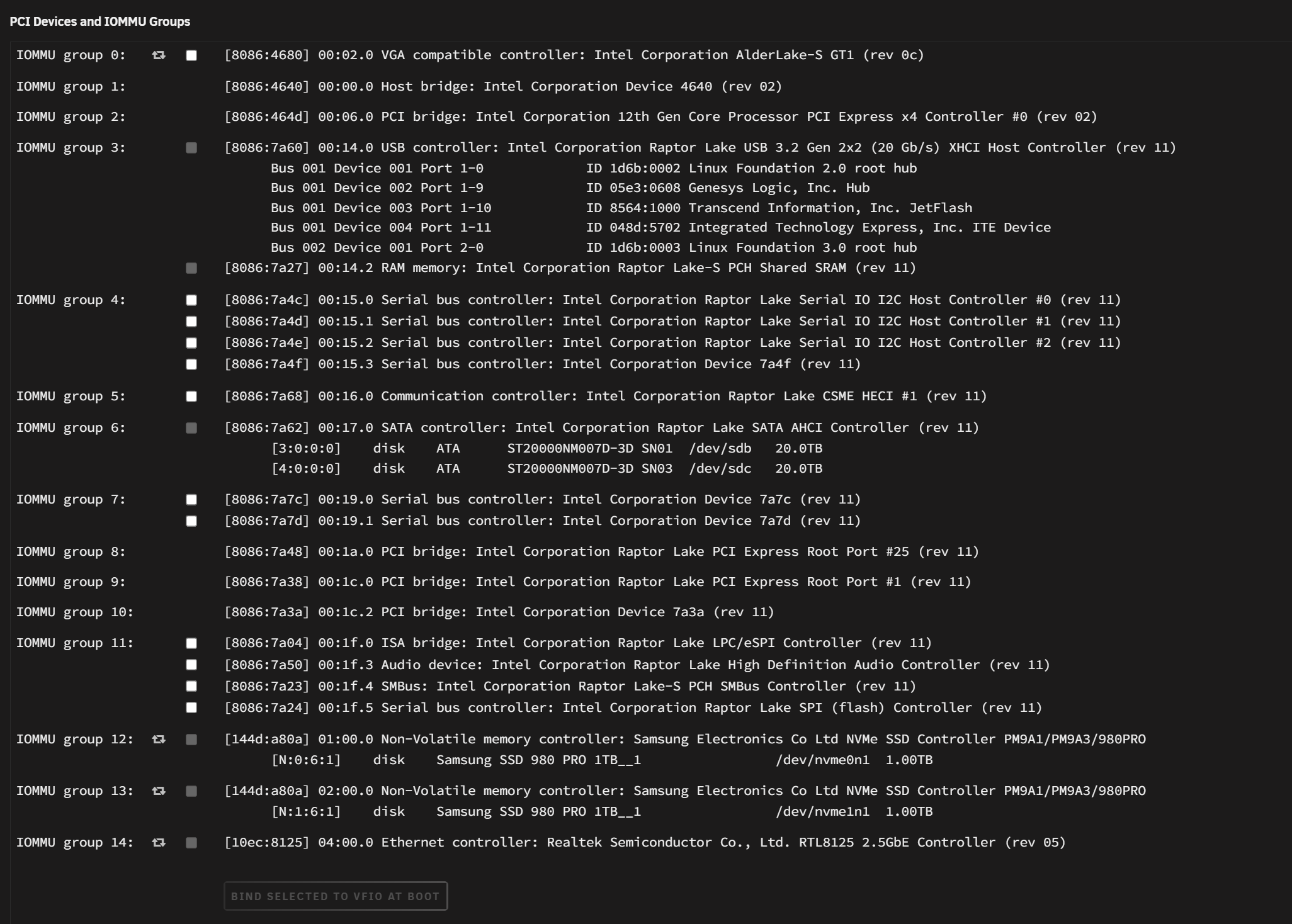

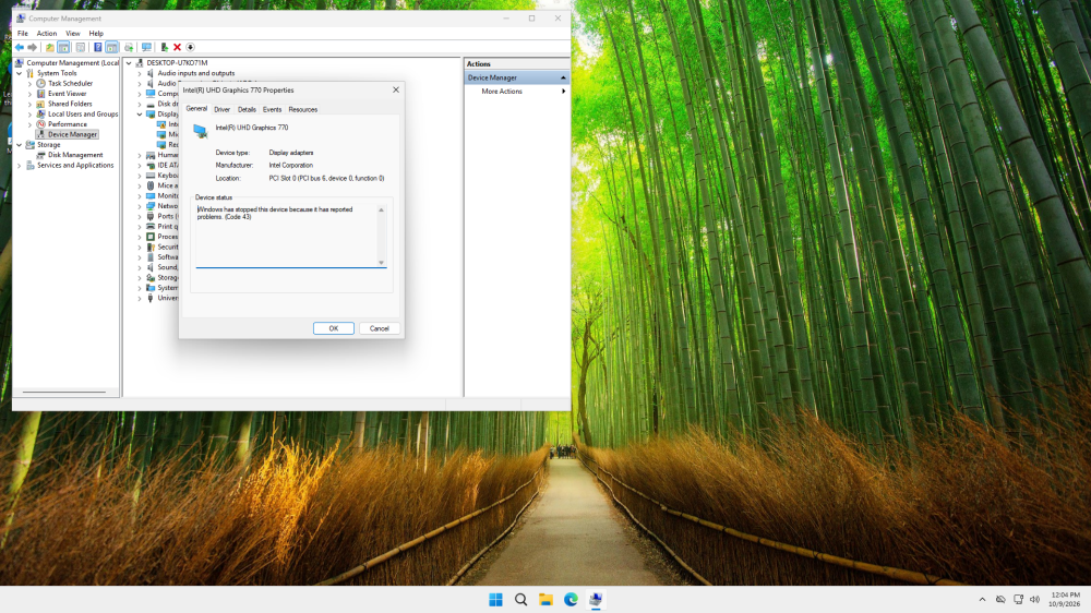

@giganode
What Can be issue - when I passed through igpu - I got error 43 in device manager
My IOMMU, I didn't add others with drives and don't think that is related
12 minutes ago, giganode said:
I don’t see any VF in your list.
Which device did you exactly passtrough?
Raptor Lake IGPU, from Minisforum AR900i
Device ID in VM manager - 02:00:0 without sound card, as it in different group and gives me error
VM is working, just getting error 43, not sure what does it mean overall for performance
Then you are doing it wrong.
You mustn’t passthrough the iGPU itself.
You have to passtrough one of its VFs

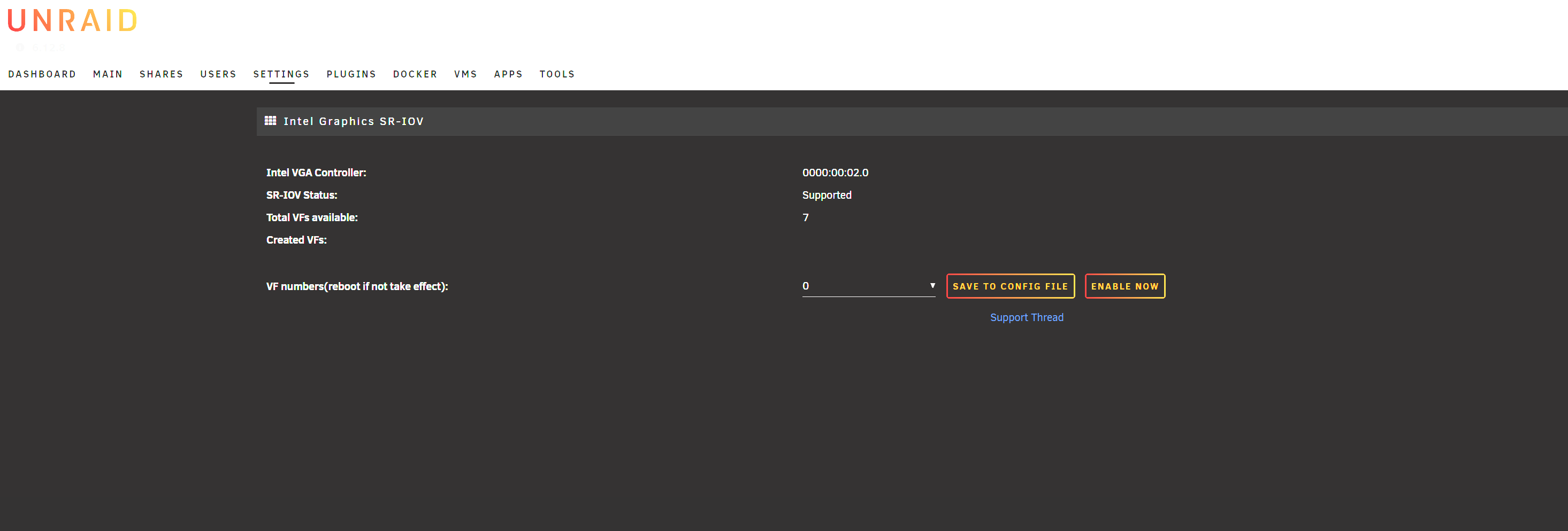

I can't get it to work. I have installed the plugin from giganode and restarted my Unraid.
When I go into the settings, the VFs numbers are not saved, it stays at 0 when i refresh this page. All VM's are Stopped
I have an Intel 13500 and my Unraid Version ist the latest 6.12.8

Please post your Diagnostics.

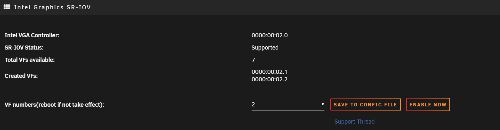

change the value, reboot ... they are created at boot.
you can may take a look at this after you changed the value in the GUI
root@AlsServerII:~# cat /boot/config/plugins/i915-sriov/i915-sriov.cfg
vfnumber=1
root@AlsServerII:~#
 here they are stored, in my case "1" vf is created at boot.
you can also try to nano, edit and boot (bypass the webui)
you may should take a look t the handbrake log what it says, if its really a hardware issue for handbrake or some missing setting for your encode
i can confirm, plugin works nice here (incl. handbrake), thanks @giganode
as soon other hardware encoders work it should also work for handbrake, sample, set a fixed fps for your output or or or ...
vfnumber=1
root@AlsServerII:~#
I have already restarted the host several times, but the value always remains at 0.
I have had a look in the cfg. It says vfnumber=3
But I don't see any changes.
lstation-diagnostics-20240303-1023.zip
Edited by Lunixx
may reduce them to 1 ... but i guess wont help
Feb 29 12:24:05 lstation root: ---Setting VFs to: 4---
Feb 29 12:24:05 lstation kernel: i915 0000:00:02.0: not enough MMIO resources for SR-IOV
Feb 29 12:24:05 lstation kernel: i915 0000:00:02.0: [drm] *ERROR* Failed to enable 4 VFs (-ENOMEM)
Feb 29 12:24:05 lstation root: -------------------------------------------------
Feb 29 12:24:05 lstation root: ---Installation from SR-IOV plugin successful!---
Feb 29 12:24:06 lstation root: plugin: i915-sriov.plg installed
root cause is rather your mainboard ... may try some BIOS lookups, above 4g, uefi, latest bios installed, last try, syslinux startup parameter ...

Mar 11 23:22:14 kernel: i915 0000:00:02.0: Direct firmware load for i915/adlp_dmc.bin failed with error -2
i5-12500H  显示代码43 无法使用。。。
Edited by DearSir
Same problem with my ASROCK N100DC-ITX motherboard + UnRaid 6.12.8. An idea to investigate ?
3 月 11 日 23:22:14 内核:i915 0000:00:02.0:i915/adlp_dmc.bin 的直接固件加载失败,出现错误 -2
 ERYING G660 ITX
BIOS设置为 4G编解码,开起1个虚拟显卡
能够识别,但无法使用。
