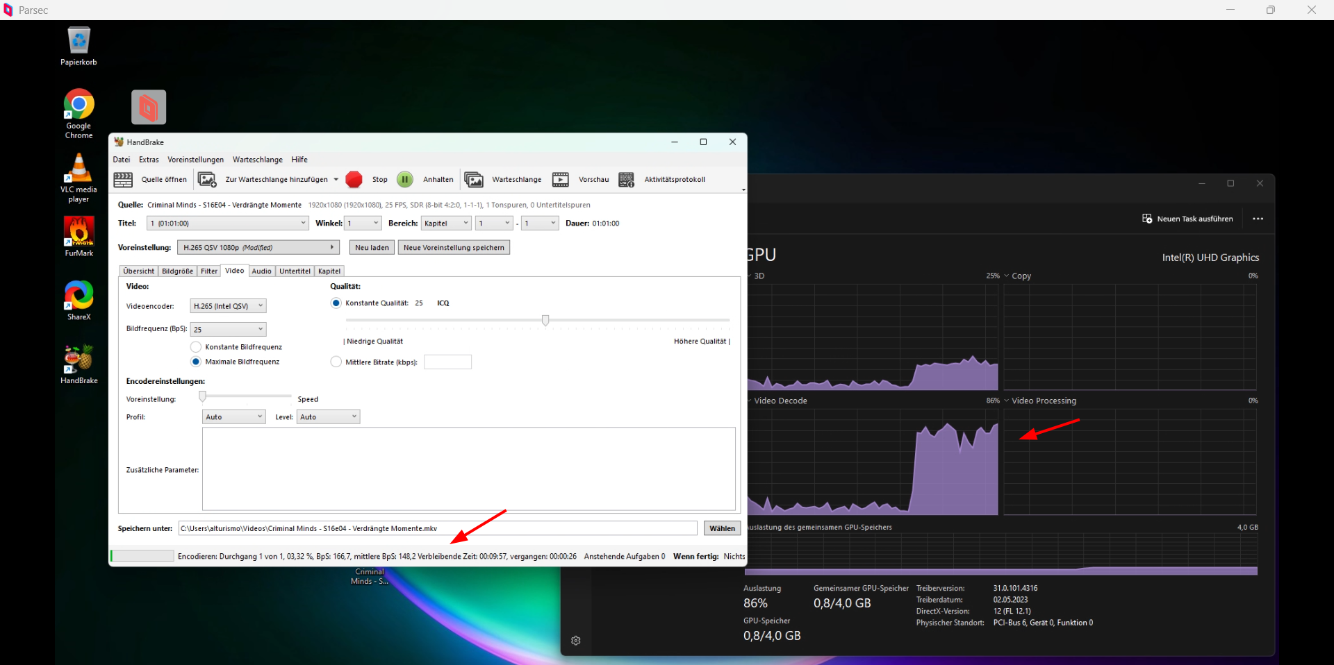

On 3/2/2024 at 1:32 AM, alturismo said:
you may should take a look t the handbrake log what it says, if its really a hardware issue for handbrake or some missing setting for your encode
i can confirm, plugin works nice here (incl. handbrake), thanks @giganode
as soon other hardware encoders work it should also work for handbrake, sample, set a fixed fps for your output or or or ...

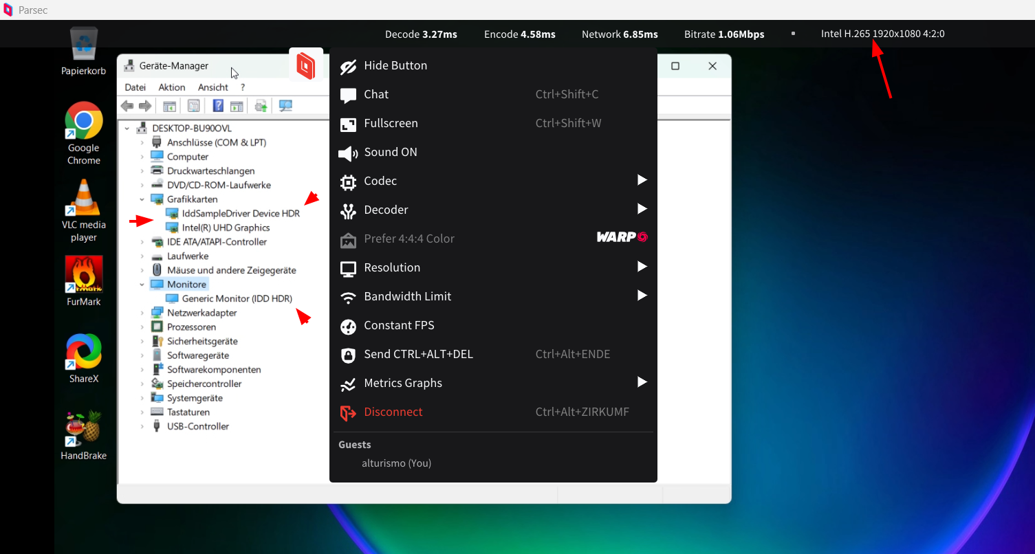

Hello, could you please provide steps for making Parsec working like your screenshot? I tried many times, but not working.
Are you connecting your physical monitor with an usb to hdmi adapter to get Parsec working?
Thanks in advance.
when i remember correctly, nothing special besides installing the one really working intel gpu driver ...
nope ... i tested with a Monitor setup in the beginning when nothing was working properly, but in the end its been the driver ...
so it works without any attached monitors, meanwhile i have a kvm attached which also emulates a moni on the hdmi port, but worked before too ... so thats not the showrunner.

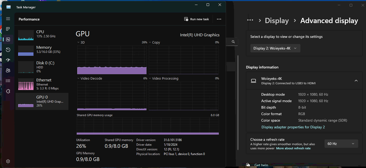

On 2/23/2024 at 7:52 AM, giganode said:
You should also be able to use a real monitor with an hdmi dongle. Still need to verify this though.
I just wanted to confirm that a USB DisplayLink HDMI dongle works with this fork under unRaid 6.12.9.   I use this dongle as recommended in the pre fork thread.
You'll have a vGPU accelerated HDMI port from your VM.   It's sorcery.
Not entirely related to vGPU and sriov is that "Woieyeks-4K" identified "display."   It is really an inline HDMI EDID emulator that you may not need.
Edited by dimes007
Clarification

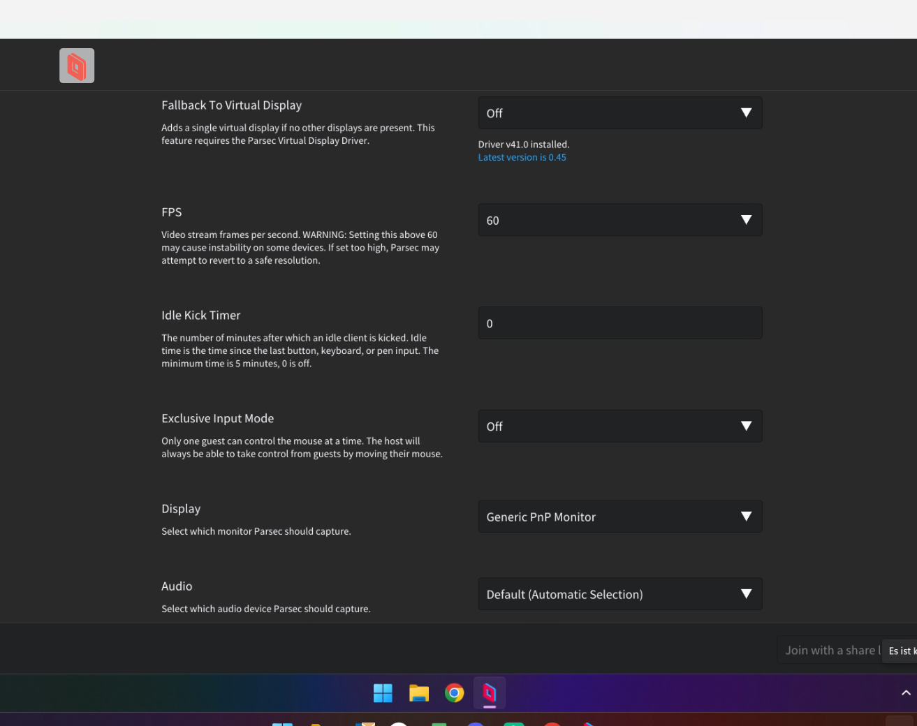

Hey newbie here, I have been trying to get this plugin to work with my i5 12600k, in the VM its detected fine, but I can't connect via Parsec or Moonlight.
If you see the GPU in task manager -> performance tab then SR-IOV is working fine and you may need to ask for support in the Parsec or Moonlight communities.
Maybe that's because I have no actual display for parsec/Moonlight to connect to?
If it needs a real monitor to be connected, it's possible it'd need a dummy HDMI plug. I'm not sure. You could try searching for "headless Moonlight" or "headless Parsec" and see if you find anything. Unfortunately I'm not familiar with this software. Maybe someone else here knows.
here you can try this, i made that for 1 setup and it worked out nice
how have you configured the parsec or moonlight for it to work, i have now created the virtual display
mine just works and where i setup this the same, just installed it and ... all good.
just fired it up to take a look, both work, h264 and 265 as streaming options in parsec, nothing special ...
I found a fix for this, it seems like the intel driver version was the issue
https://github.com/strongtz/i915-sriov-dkms/issues/141
also it works now without the virtual display but i prefer to use the better resolution
Edited by JannikGHG
yep ;)
