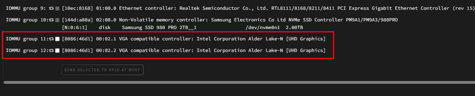

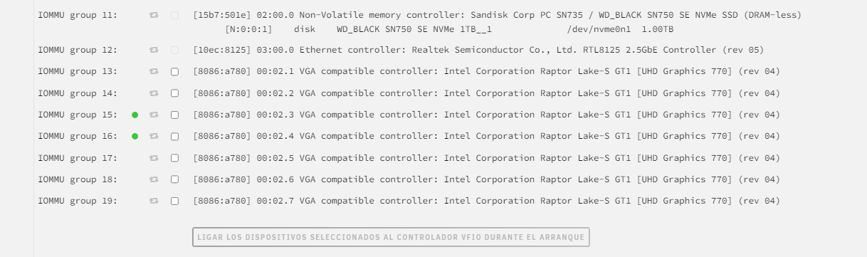

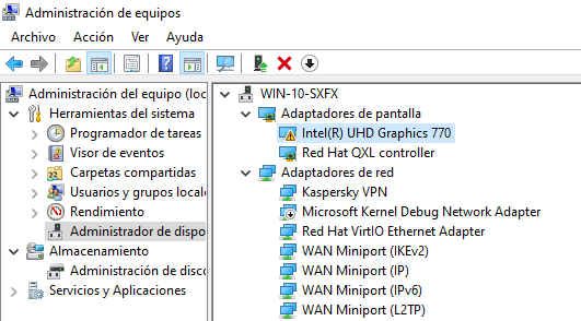

Hi fellow Unraiders, can you help me out with this issue?
On 7/18/2024 at 1:11 PM, AnonStoormTrooper said:
Tienes razón, he reproducido una película HEVC 4k en una VM con una de estas GPU virtuales y el uso de CPU se dispara, mientras que la GPU en el administrador de tareas se queda al 0%. Es cierto que lo detecta, porque he podido instalar los drivers, pero no lo está utilizando.
¿Qué configuración debo realizar? Cuando marqué la casilla: "Vincular dispositivos seleccionados al controlador VFIO en el momento del arranque", lo hice siguiendo una publicación en uno de estos foros de UNRAID. ¿Sería suficiente desvincular eso?
I followed the instructions in this quote, which my colleague @alturismo told me to make an adjustment to, and when I did it, the vGPU no longer appears in Task Manager, and it appears with an error in Device Manager.
Maybe  @ich777 as the plugin developer can help me with the correct configuration to have GPUs in multiple VMs?
When the option "Bind selected devices to the VFIO driver at boot time" was checked the GPU appeared correctly in all these sections, but it didn't seem to be working correctly when playing 4k content.
Many thanks to everyone in advance

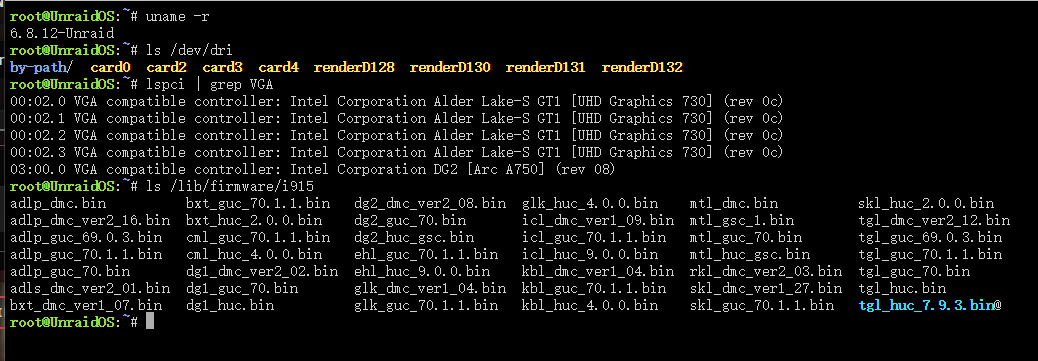

Just like shown in the picture, you can see 5 PCI devices but only 4 drivers. The driver for the A750 (card1) is missing.
Sorry, but I'm not the right person to ask since I don't have any SR-IOV capable hardware.
This is most likely caused because the SR-IOV driver (which this plugin uses) is based on a really old fork from the i915 driver which may not support your A750 right OOB without any additional options to pass over to the i915 module.
However I wouldn't bet on that since you haven't provided any Diagnostics it is really hard to say what's going on.
the vgpu is there, but prolly errors out (code 43) when you look in the details on the igpu in device manager
may also check either this thread or the gihub, there is a recommended driver version (older) to get this error solved and the vgpu fully functional in the VM.
and yes, not using vfio bind is the correct way ... here a sample with 2 vgpus (not bound and working as it should)
this is may not plug & play ...
Please try the following:
1. Use DDU to completely wipe everything relatet to intels gpu driver in your vm and shut it down.
2. Do a full shutdown of your server so a vgpu has not been initialized incorrectly prior to driver installation.
3. Install intels gpu driver on next vm boot.

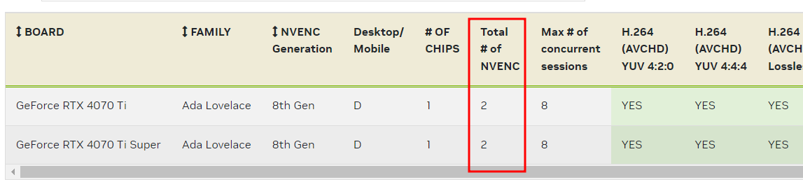

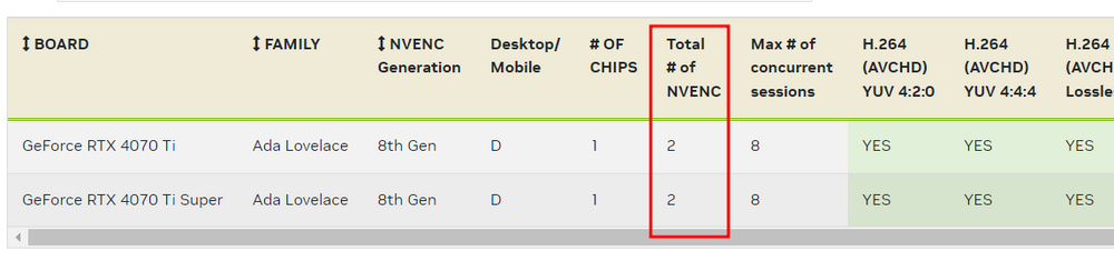

2 minutes ago, nyavana said:
My nvidia GPU will drop frame when streaming Parsec and recording OBS at the same time,
ok, so besides the gaming itself its 2x streaming encoding
thanks for the Info, i d have thought it still shouldnt affect as the 4070 ti S has 2x nvenc's onboard
too bad ...
too bad ...
This is exactly the reason I brought 4070ti super instead of 4070 super, but it seems like nvidia has some driver scheduling issue that despite encoding usage < 80% from task manager, I still get frame pacing issue that creates constant micro stutter.
It happens with my tesla p100 as well, I guess even the latest nvenc are not designed for high framerate multistream encoding.

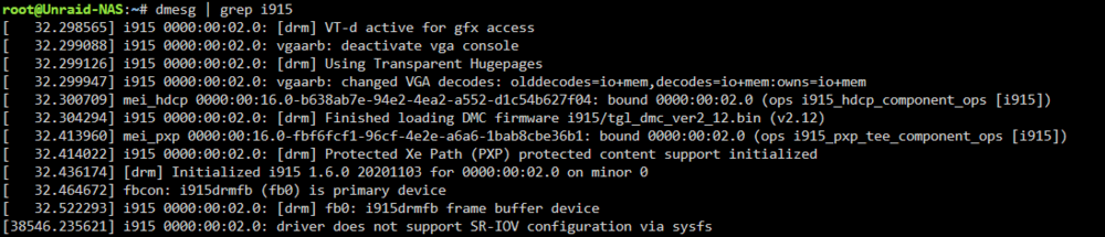

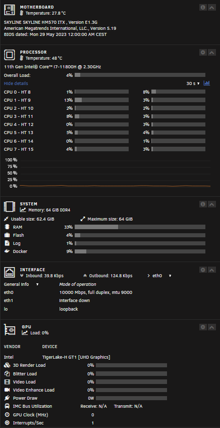

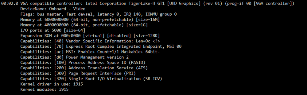

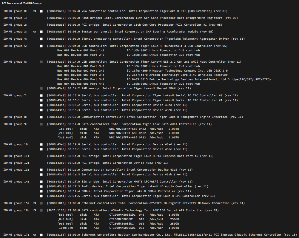

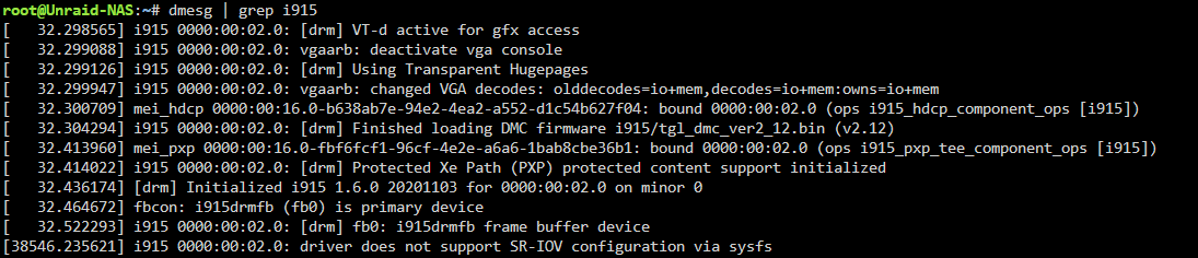

Hi, does anybody have some success with i7-11800H and UHD graphics?
I migrate my Unraid server from i7-7700 on some HP board to a Erying SKYLINE HM570 ITX with i7-11800H (overall performance is outstanding compare to old CPU).
After that Intel-GVT-g plugin stop working because of incompatible processor so I've switch to SR-IOV but now i have an issue when I thy to add VF nothing happened in GUI and after reboot anytime when I click on SR-IOV plugin whole system hang up, Unraid GUI is unresponsive, putty refuse to connect, local console (keyboard an monitor) don't work.
Only thing that I can do is force reset server and then the plugin is missing in my plugin list. I don't see any errors on logs.
In this list: https://www.intel.com/content/www/us/en/support/articles/000093216/graphics/processor-graphics.html I see that Tiger Lake (without "H") processor is not supported nor in GVT-g nor in SR-IOV, i7-11800H is Tiger Lake-H but I cannot find any info which GPU virtualization I should use to have acceleration in my Windows VM's.
Any help? 🥺

Tested in Unraid 6.12.13 stable and 7.0.0-beta.2 in both cases the same issue.
In BIOS all this mumbojumbo magical options like intel VT-d VTX and many else is on.
11th gen CPU's are not supported with sr iov graphics, only networking sr iov ...
so, until 10th gvt-g, 12th up sr-iov, 111th ... bad choice ...
Any help? 🥺
I have this board as well... nothing you can do to make it work
True, when I planed to migrate my homelab servers I focus too much on 3D printed cases and dimensions of components than about hardware quirks, also summer sales on Erying and mobo for 190$ mess with my thinking. ;)  My bad.
Thank You, thats all what I need to hear. Fortunately raw performance of this CPU is more than enough for my VM's so i can live without SR-IOV. Maybe in the future i pick some ITX mobo with 13th gen.
