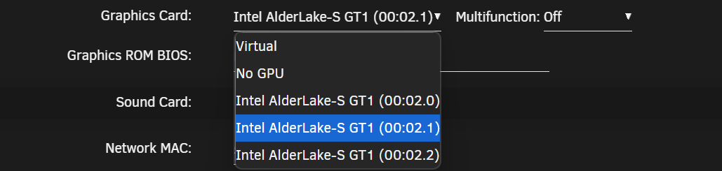

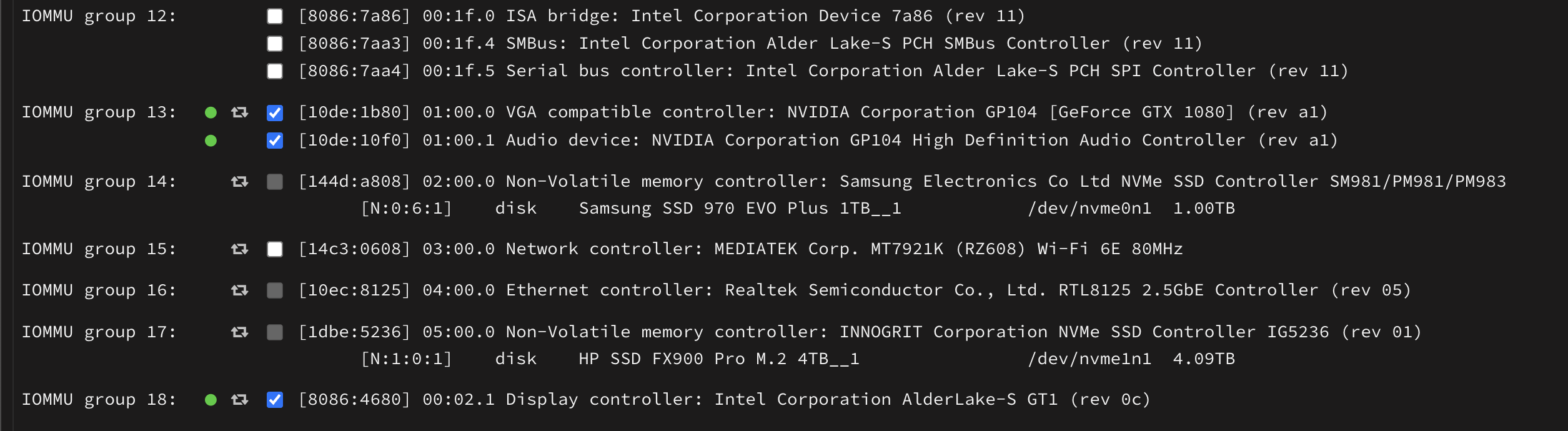

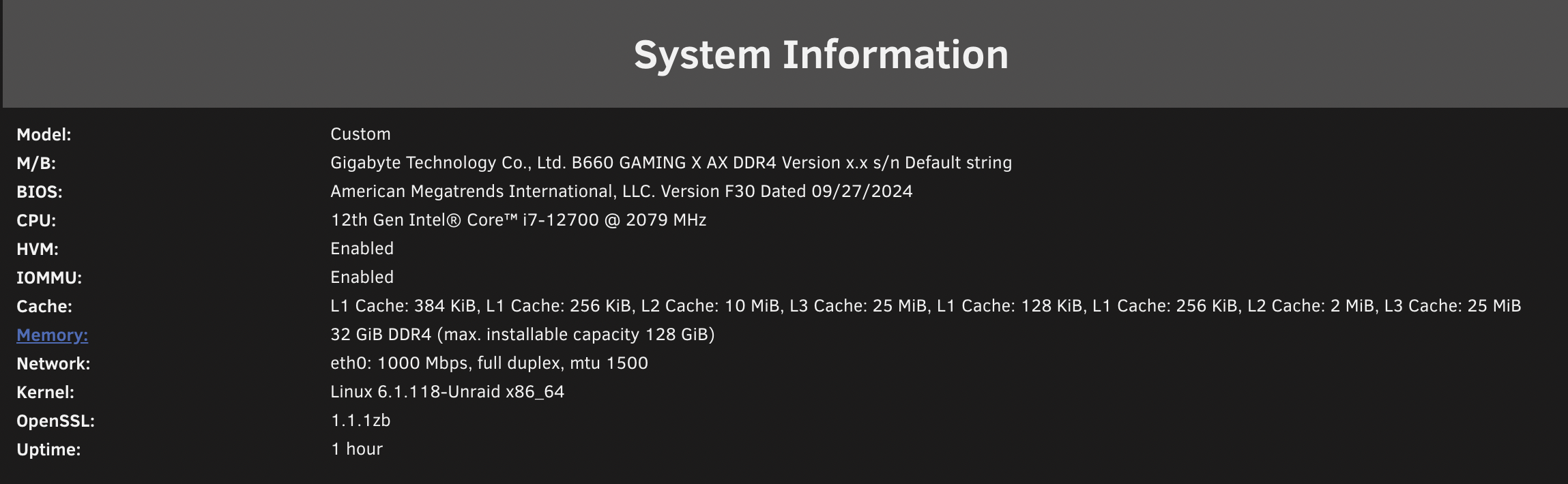

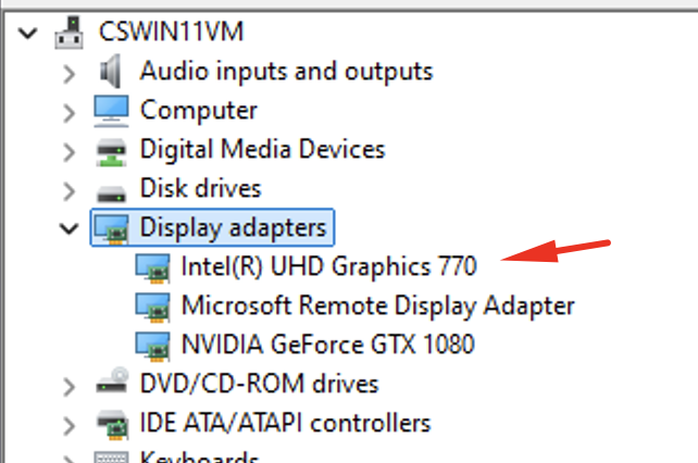

Hello, I successfully have SR-IOV working on my 12th gen Unraid box.  I have the iGPU and a GTX1080 passed through to a Win11 VM and both have drivers loaded properly.  Everything is great except when I reboot, I get this:
Event: VM Autostart disabled
Subject: vfio-pci-errors
Description: VM Autostart disabled due to vfio-bind error
Importance: alert
Please review /var/log/vfio-pci-errors
cat /var/log/vfio-pci-errors
Error: Device 0000:00:02.1 does not exist, unable to bind device
But it's there:
lspci | grep 2.1
00:02.1 Display controller: Intel Corporation AlderLake-S GT1 (rev 0c)
This looks correct:
cat /boot/config/vfio-pci.cfg
BIND=0000:01:00.0|10de:1b80 0000:01:00.1|10de:10f0 0000:00:02.1|8086:4680
I have tried unchecking, and rechecking a box and clicking bind, but doesn't seem to help.  vfio-pci.cfg looks correct to me.
Stumped as to what is causing this error.

Don't bind the iGPU to vfio on boot.
I'm not binding the main device, only the 2.1 sub-device so it can be passed through to the VM.  Not sure I understand your reply...
Okay :)  Also don't bind VFs from the iGPU to vfio.
So how do I get the iGPU to show up in the Win11 VM without binding it?  I'm using the iGPU in Windows for hardware acceleration in Blue Iris.   (working great, just the startup error above)
Sorry if I'm slow, can I still pass through this iGPU sub-device to the VM without binding it?
Edited by cscoppa

Yes, normally you should be able to just select it in the dropdown menu.
Take a look here:
00:02.0 is my IGPU and 00:02.1 & 00:02.1 are my VFs.
short, yes and also recommended todo so
@giganode was faster ;)
Awesome, thanks guys, I'll give this a shot.  Sorry for being dense, I didn't realize it would still show up in the drop-down list in VM manager without being binded first.
EDIT:  That did the trick!  Unbinded, still getting passed through to the VM.  You learn something new every day.
