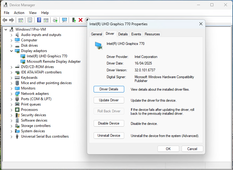

Hey,
so i've had this running for quite a while, but i restarted my VM today and it just stops working, it gives Code 43 and the following in the VM Log:
char device redirected to /dev/pts/3 (label charserial0)
2025-07-22T15:22:50.062308Z qemu-system-x86_64: VFIO_MAP_DMA failed: Invalid argument
2025-07-22T15:22:50.062353Z qemu-system-x86_64: vfio_container_dma_map(0x5606a2d63de0, 0x382800000000, 0x20000000, 0x154100000000) = -2 (No such file or directory)
2025-07-22T15:22:50.140639Z qemu-system-x86_64: VFIO_MAP_DMA failed: Invalid argument
2025-07-22T15:22:50.140658Z qemu-system-x86_64: vfio_container_dma_map(0x5606a2d63de0, 0x382800000000, 0x20000000, 0x154100000000) = -22 (Invalid argument)
2025-07-22T15:22:54.230866Z qemu-system-x86_64: VFIO_MAP_DMA failed: Invalid argument
2025-07-22T15:22:54.230889Z qemu-system-x86_64: vfio_container_dma_map(0x5606a2d63de0, 0x382800000000, 0x20000000, 0x154100000000) = -22 (Invalid argument)
2025-07-22T15:22:54.293984Z qemu-system-x86_64: VFIO_MAP_DMA failed: Invalid argument
2025-07-22T15:22:54.294013Z qemu-system-x86_64: vfio_container_dma_map(0x5606a2d63de0, 0x382800000000, 0x20000000, 0x154100000000) = -22 (Invalid argument)
2025-07-22T15:22:54.443558Z qemu-system-x86_64: VFIO_MAP_DMA failed: Invalid argument
2025-07-22T15:22:54.443582Z qemu-system-x86_64: vfio_container_dma_map(0x5606a2d63de0, 0x382800000000, 0x20000000, 0x154100000000) = -22 (Invalid argument)
2025-07-22T15:22:54.464231Z qemu-system-x86_64: VFIO_MAP_DMA failed: Invalid argument
2025-07-22T15:22:54.464257Z qemu-system-x86_64: vfio_container_dma_map(0x5606a2d63de0, 0x382800000000, 0x20000000, 0x154100000000) = -22 (Invalid argument)
2025-07-22T15:22:58.141018Z qemu-system-x86_64: VFIO_MAP_DMA failed: Invalid argument
2025-07-22T15:22:58.141040Z qemu-system-x86_64: vfio_container_dma_map(0x5606a2d63de0, 0x382800000000, 0x20000000, 0x154100000000) = -22 (Invalid argument)
This issue seem to be common, so i checked all the steps i could find:
  • Reboot of VM
  • Reboot of Server
  • Reassigned VFIO from 3 to 2
  • Tried VFIO booting, but that wasn't recommended and or working
  • Assigned .bin for BIOS
  • Uninstalled plugin > Reboot > Installed plugin
  • Tried making new VM config
  • Tried different versions of Intel drivers > All of them give code 43
I'm quite out of options, anyone else have ideas?

Update,
I made a new VM and if i boot it up, first connect to RDP, delete the code 43 driver, wait 5 minutes then connect with Parsec it's got a working driver. Really strange tho.

On 7/23/2025 at 6:46 AM, Mirano said:
Update,
Not sure this will help, but I have had similar issues.
My CPU is an Intel 14600K, and I have now seen the following issues and "workarounds":
For the "VFIO_MAP_DMA failed: Invalid argument" error in the VM logs => see here for explanation: https://forum.level1techs.com/t/looking-glass-vm-to-vm-not-working/227549/2
But basically you need to add the "maxphysaddr" line in your VM XML config, as following
<topology sockets='1' dies='1' clusters='1' cores='6' threads='2'/>
<cache mode='passthrough'/>
<maxphysaddr mode='passthrough' limit='39'/>
</cpu>
For the driver error code -43 in windows 11 VM, I noticed that it is linked to a specific driver version that was installed by Windows Update, I fixed it by "rolling back" to the previous installed driver that happened to be in fact more recent!
Here the driver that seems to be working for me:
Hope this helps a bit!

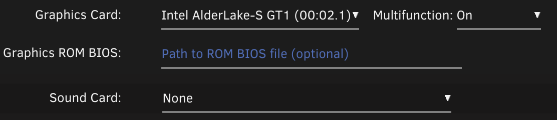

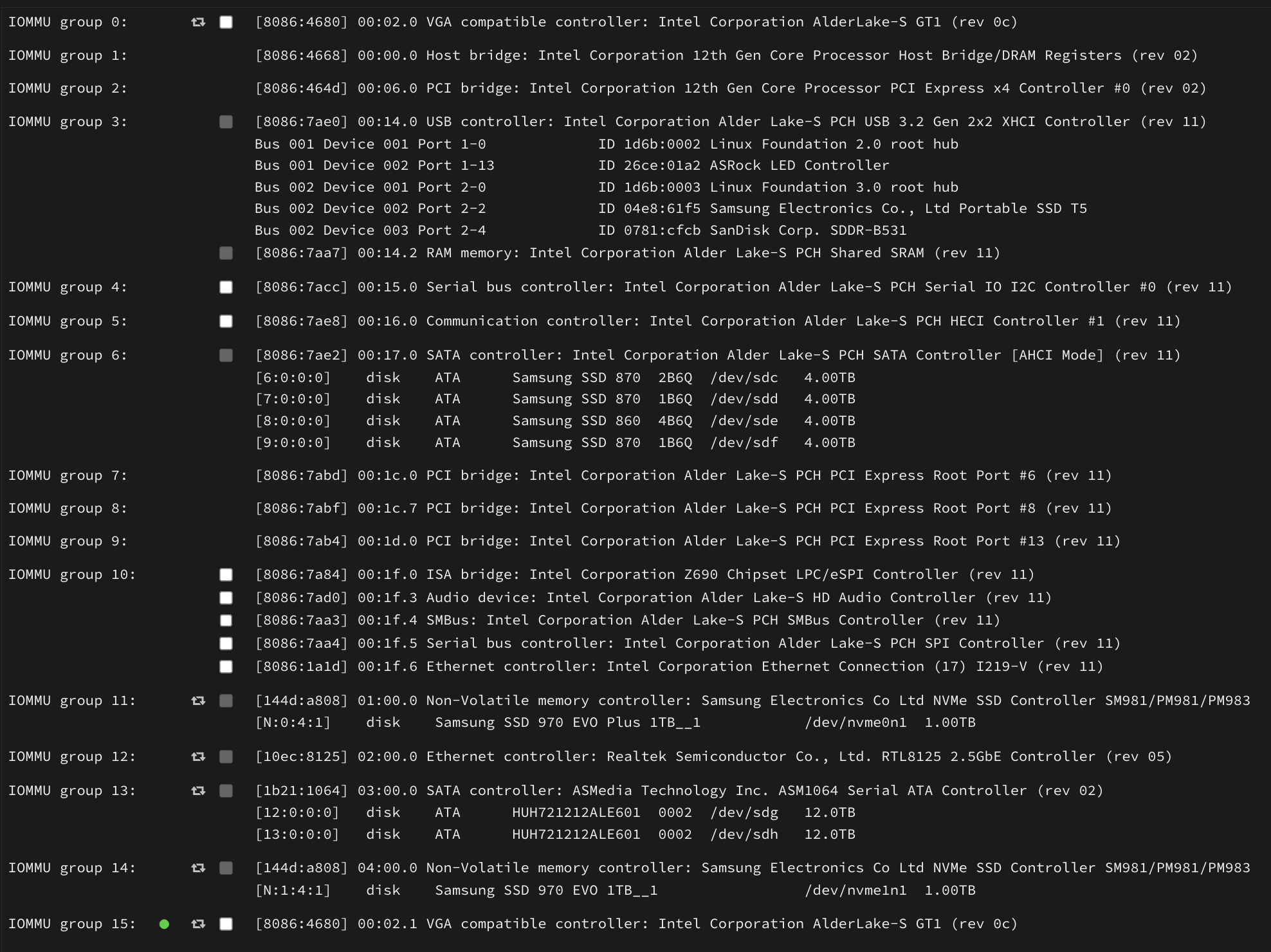

On 3/7/2025 at 10:30 AM, yuzufilm said:
Hi there, new here. I installed intel GPU TOP and then this SR-IOV plugin for my 12700K. I cannot get my VM to see the iGPU/UHD 770. I've installed the default Windows Update Intel display drivers and when I tried using the driver package from Intel's website I get an error saying I don't have any compatible devices. I don't have this issue when I bind the iGPU and fully passthrough it without the SR-IOV plugin and use a dummy HDMI cable - but I'd obviously like to have the VFs so I can do things like encode with Handbrake and have a VM with iGPU capabilities.
Here's my diagnostics and XML and some screenshots. Thank you!
yuzu-nas-diagnostics-20250307-0922.zip xml copy.txt

9 minutes ago, xlucero1 said:
i install the parsec display drivers
i even use the vdd driver (not parsec) but shouldnt matter
https://github.com/VirtualDrivers/Virtual-Display-Driver
installing intel drivers then the iGPU should initialize properly and no more code 43 etc.
afterwards, you can use any tool for remote, depending now what you like and how good it works, personal experience
VNC like TightVNC which makes use of hw acc, lowest quality
RDP, quite ok and usually my favor for fast access, good enough for browsing and office
"Game" Streamers Apps like Parsec, sunshine/moonlight, ... best experience (almost bare metal)
Apps like Teamviewer, Splashtop, Anydesk, Chrome remote, whatever ...
yes, also makes somehow use of hw acc but not compareable to gamestreaming, you are more on RDP Level there ...
in short my steps
1/ setup VM via VNC
2/ install virtual display driver
3/ install a native VNC and/or enable RDP on the mashine
4/ stop VM, assign vgpu as ONLY display, start VM
5/ access your VM via native VNC or RDP
6/ install Intel drivers, check if all is ok (no erros in device manager, driver)
7/ install your remote tool/s and test and compare
20 hours ago, alturismo said:
1/ setup VM via VNC
So if I somehow do not see the igpu in task manager, do you also believe the only way to recover it properly is to recreate the VM as I have mentioned there in image 2? I have tried a bunch of other stuff, including following your steps, but I cannot download the iGPU drivers, since the iGPU is not even being recognized. The only way it was recognized is when i recreated it again.
Thank you very much for your awesome response earlier. that was helpful and helped clarify for the process for setting up VM!
thats clear, no vgpu in VM, no driver, no fun ;)
if you "loose" the vgpu and you need to recreate it ... the issue is pretty sure either
some missconfiguration
hardware doesnt like sr-iov
most common errors, vfio bind, extra syslinux entries, ... this plugin should be
1/ installed
2/ choose how many vgpu are wanted (i always use 2)
thats it, from here on as mentioned above, i never had a missed vgpu afterwards, yes, in the beginning i had some code 43 issues inside the VM iGPU drivers, but with a virtual display and as only gpu in VM, never since then.
