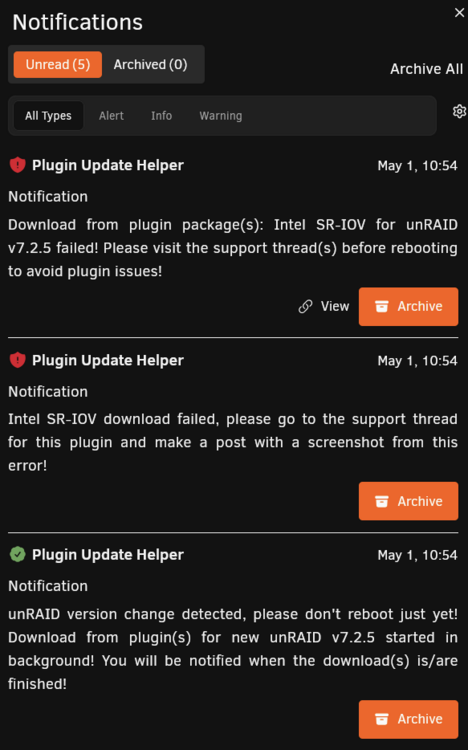

Same here...
I also updated to 7.2.5 and the sriov plugin is nowhere to be found.
A win vm fails to start due to a pci error.
The rc1 prior to this update was fine...

I can confirm, that an uninstall, reboot and a re-install worked for me too.
As i tried a re-install yesterday, the installation failed with errors. However as i read the post of bucky2780 today, i tried again and tadaa.. the installation was successful.

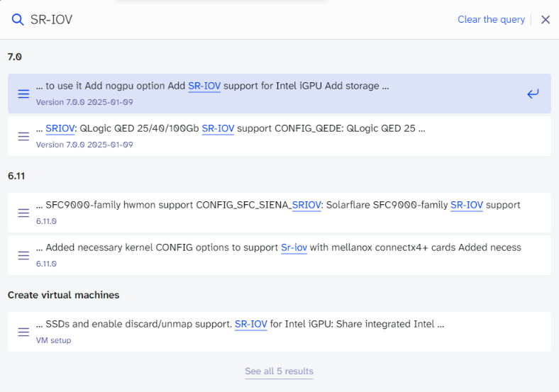

I spent hours trying to understand whats needed.
Different hardware, different unraid versions, different drivers, different plugins. Some posts in this forum, some posts in reddit, some issue discussions in github!
Documentation 3 months ago when I was trying to understand how to set up Ultra 7 265k was incomplete.
Those are the results for SR-IOV today. Only changelogs.
https://docs.unraid.net/

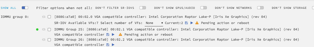

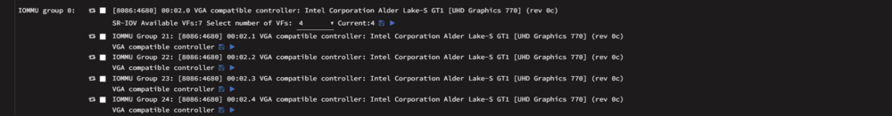

Why are these settings located under "PCI Devices and IOMMU Groups"? What is the difference? In which scenarios should I modify the settings under "PCI Devices and IOMMU Groups" versus "Intel Graphics SR-IOV"? Or does it make no difference where I make the change?
IOMMU is what allows PCIe passthrough. The IOMMU section in Unraid allows you to bind an IOMMU group to one virtual function (VF), to pass it through to a VM.
SR-IOV is what allows one physical device to be split into multiple VFs instead of just one. This is so it can be passed through to multiple VMs, or used on both the host system and one or more VMs. The most common use cases are for GPUs (like with this plugin) and for Ethernet adapters.
