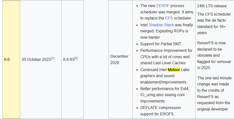

42 minutes ago, J05u said:
yeah, I understand about arc, I was thinking that igpu on core ultra can be splitted for plex, and arc cards I wanted to use with Tdarr, but In the end in gpu top gpu is in the list, in gpu top  -l, not, I don't understand latest intel generation :(
New CPUs will need the XE driver which is replacing i915. Not in current kernels. Needs > 6.8 when it was first added but would need to be min 6.12 I think for stable.
Thank you, so it means igpu not working for unraid?
Or just sr iov?
not yet as the kernel doesnt support it yet as supposed to ...
you dont need sr iov for plex anyhow ... no vgpu's needed therefore while using dockers, sr iov vgpu's would be something for using it in a VM and not in a docker ...
Or just sr iov?
as stated above, not yet as the driver is not ready / there ... in the kernel (xe driver), and once it will be ready for the new core cpu's igpu's ... then sr iov would prolly need some updates too and we will see if its coming or not.
in sum, your CPU is yet not supported by the kernel version Unraid is running on for sr-iov and about general usage i cant tell, for my knowledge it should already be supported on v7 rc1 as it uses kernel 6.6 which already should also support core cpu igpu's
