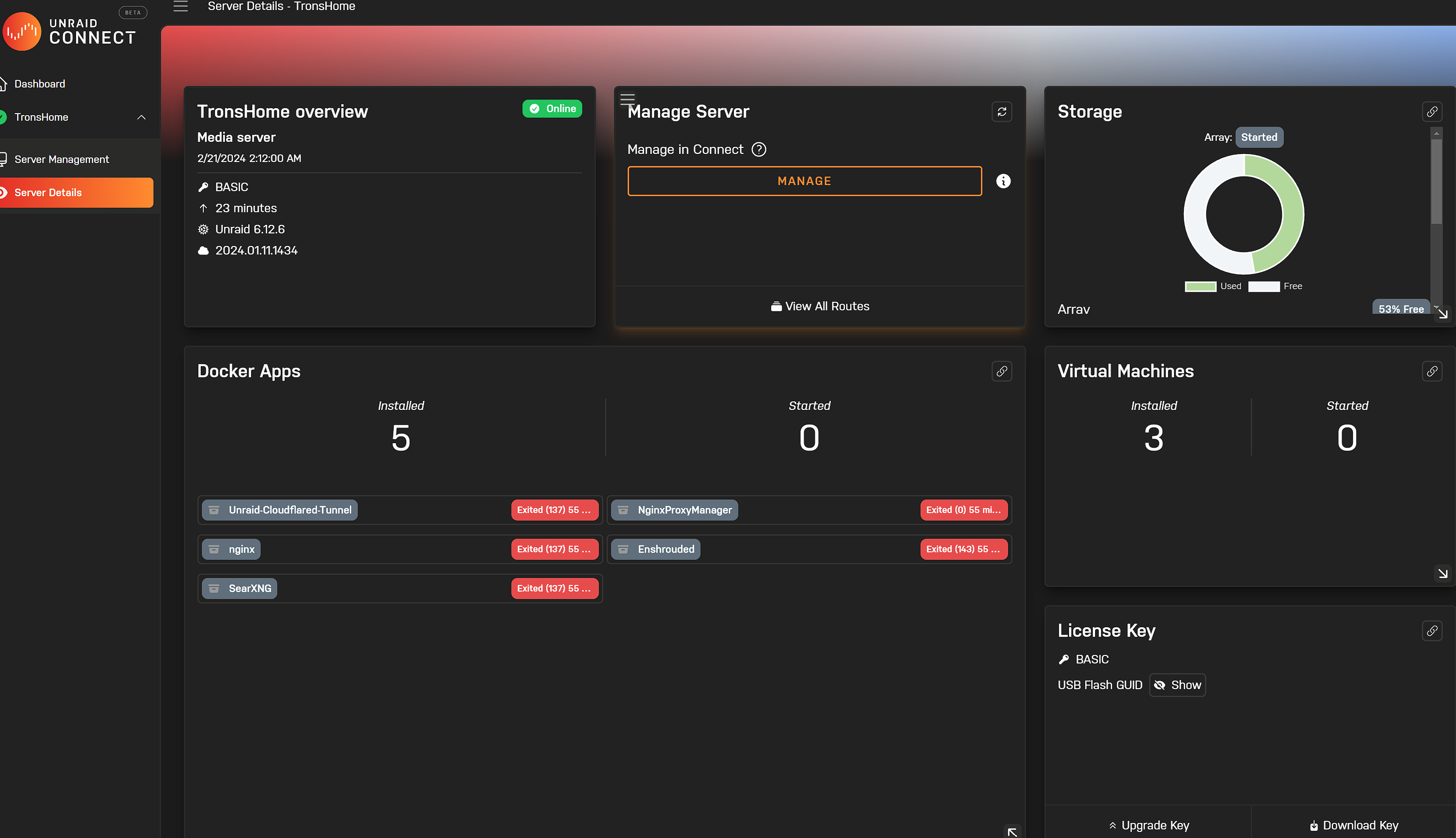

this day i came to my mashine it was again that all dockerts were down and I would like to get help  to read and understand what happend.
I addet the Diagnostics.

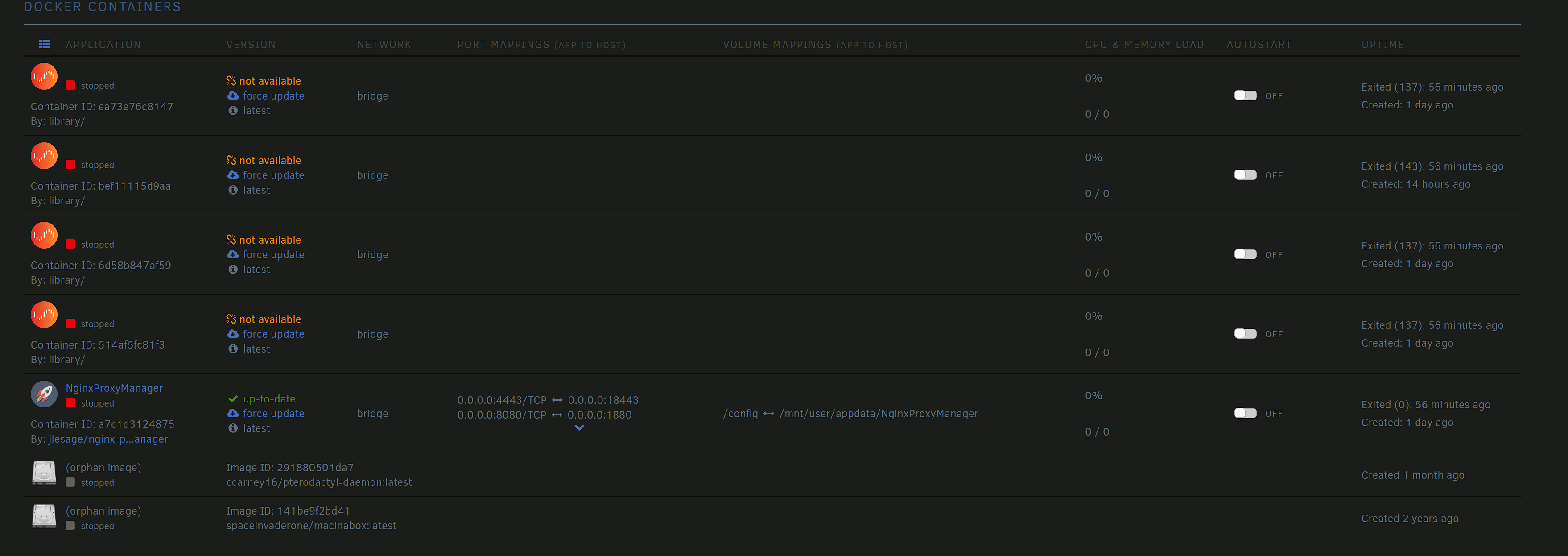

i see now in connect tha failure no 137
after google serach i found on a forum how to fix code 137 (Exit Code 137 errors happen when a container or pod was terminated due to high memory usage. Your container or Kubernetes pod will be stopped to prevent the excessive memory consumption from affecting your host’s reliability.)

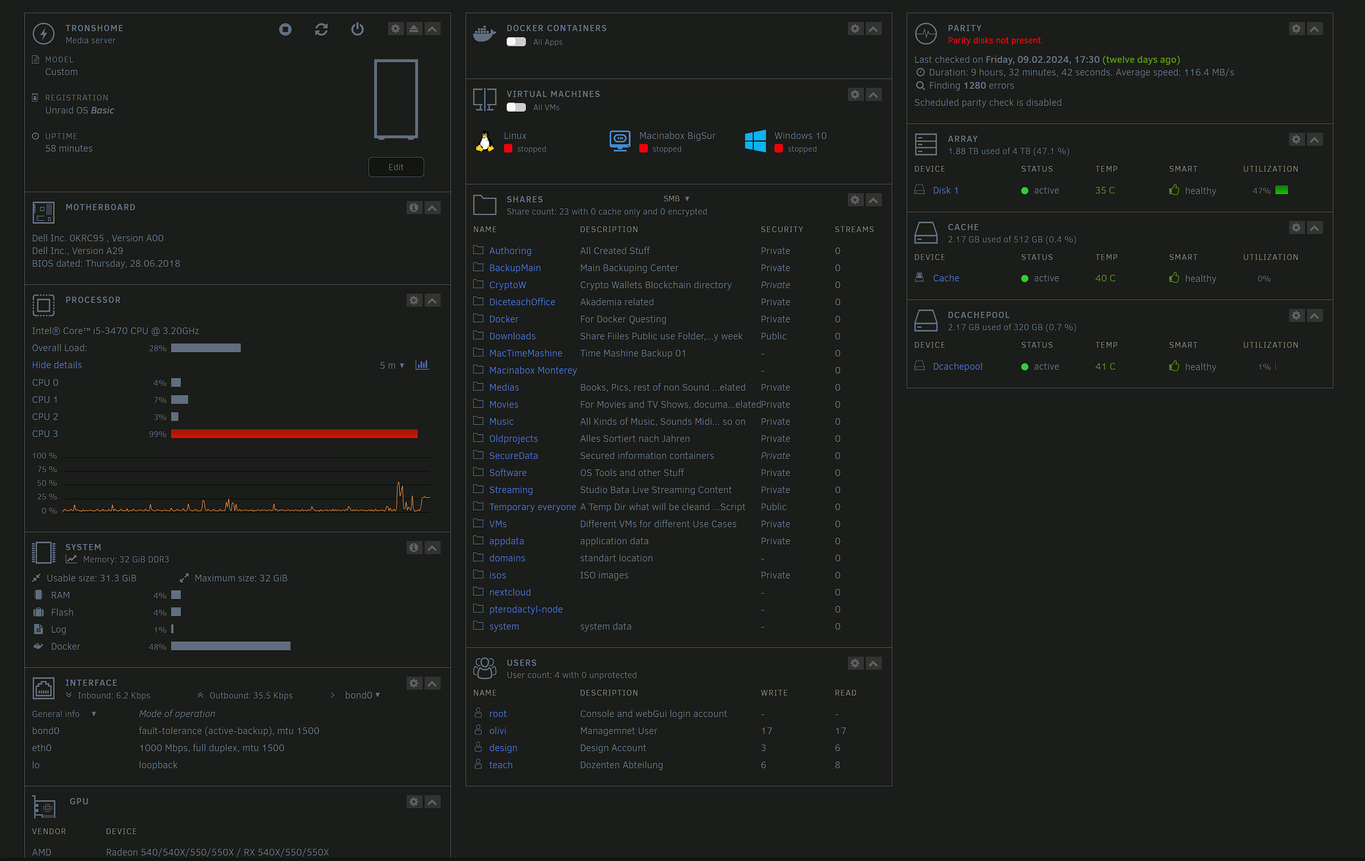

Sometimes when i log in my Unraid i dont see any shares any VMs and no Docker until few seconds and then they start to appear.
I think you are l;opoking teh wrong failuer yesterday night was 20.Feb on 21 Feb here in Europe so it sould be on that date the failure that appeared

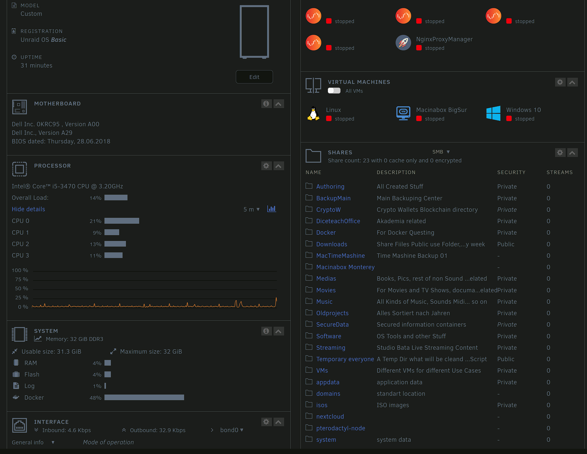

Also i dont understand why docker uses so mutch Memory in my server even now when all dockers dont work
If you have anything configured to use /mnt/cache, then since the cache drive has not mounted this would be writing to RAM rather than persistent storage (and thus lost after a reboot).

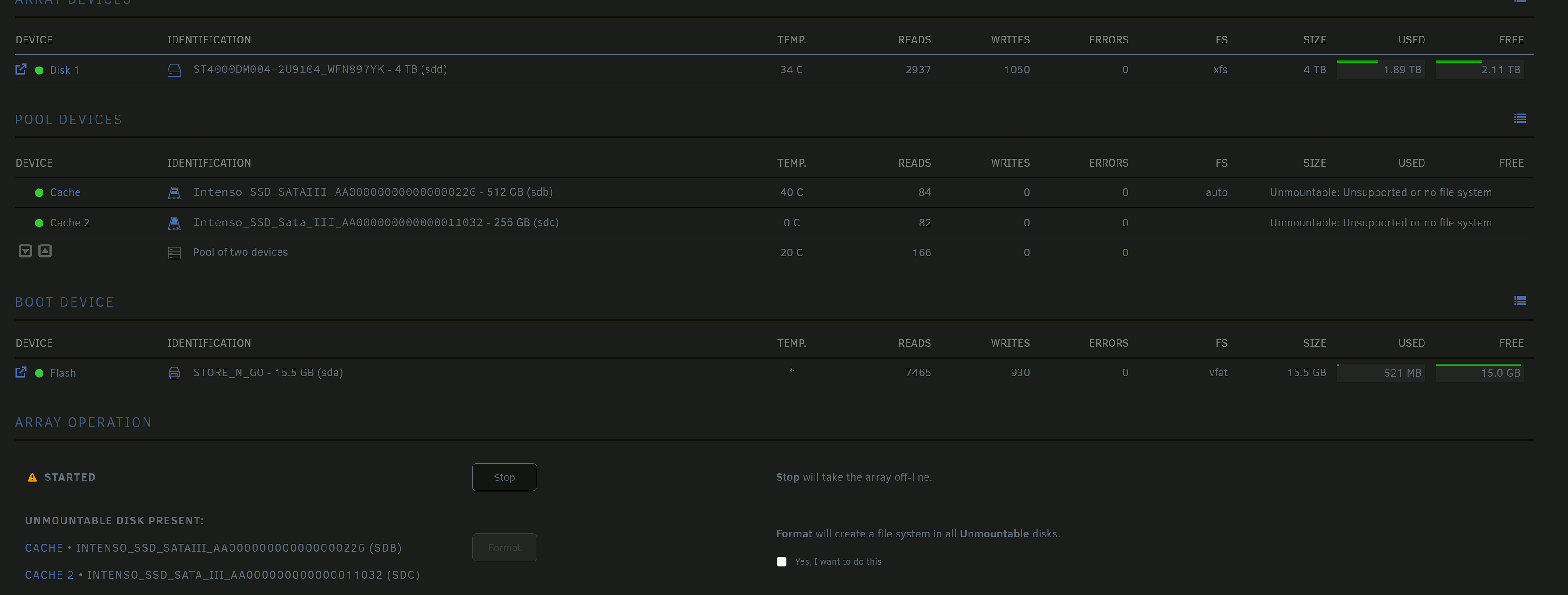

I thought as cahs they are allways not mountable so my cache drives were not formatted in teh beginning or what dfid i do wrong that they are unmountable?

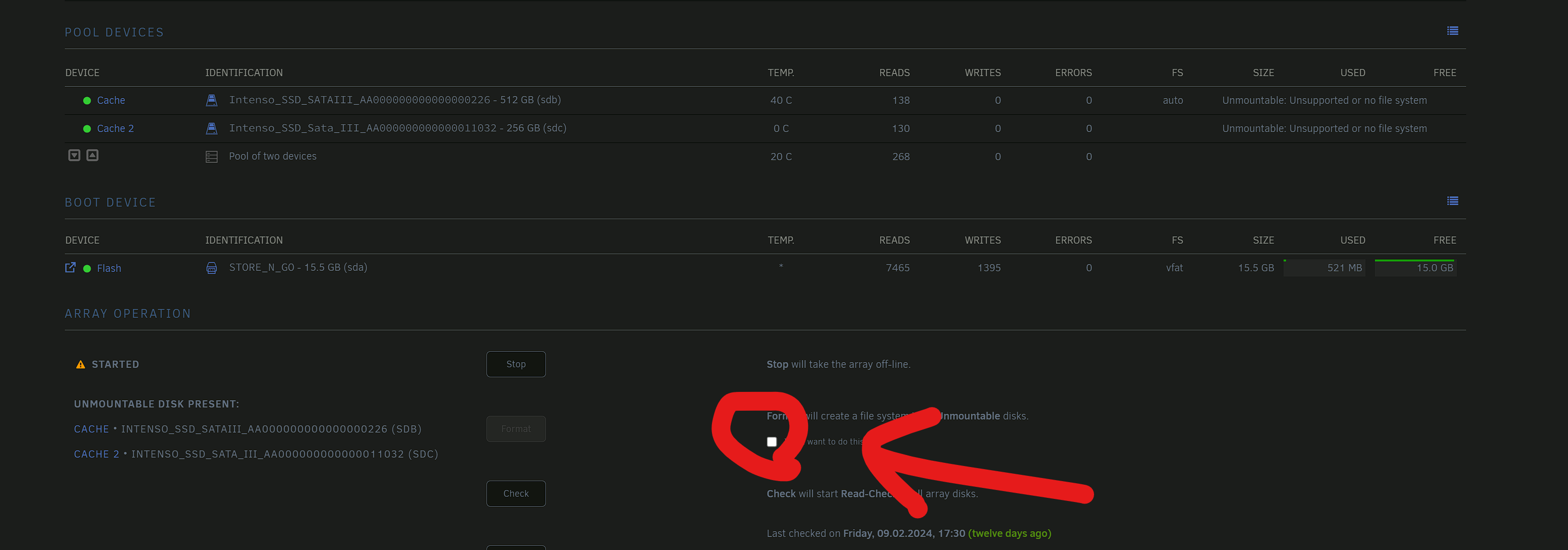

Is my configuration ok?
So if i understadn right i have to format the cache drives (SSDs) i got as Pool so they can work Proper.
If i Format with this choise it will only format the SSDs and not tha HDD with the Files on it ?
When i Start the formatting process do i have to choose a special file system to work as cache propper?
Yes they need formatting.     Unraid shows which drives will be formatted when you select this option so you should always check that is just the drives you expect.   In your screenshot it shows the two SSDs will be formatted.

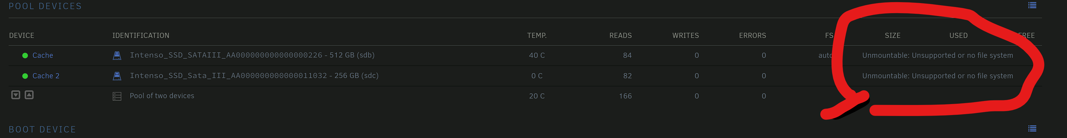

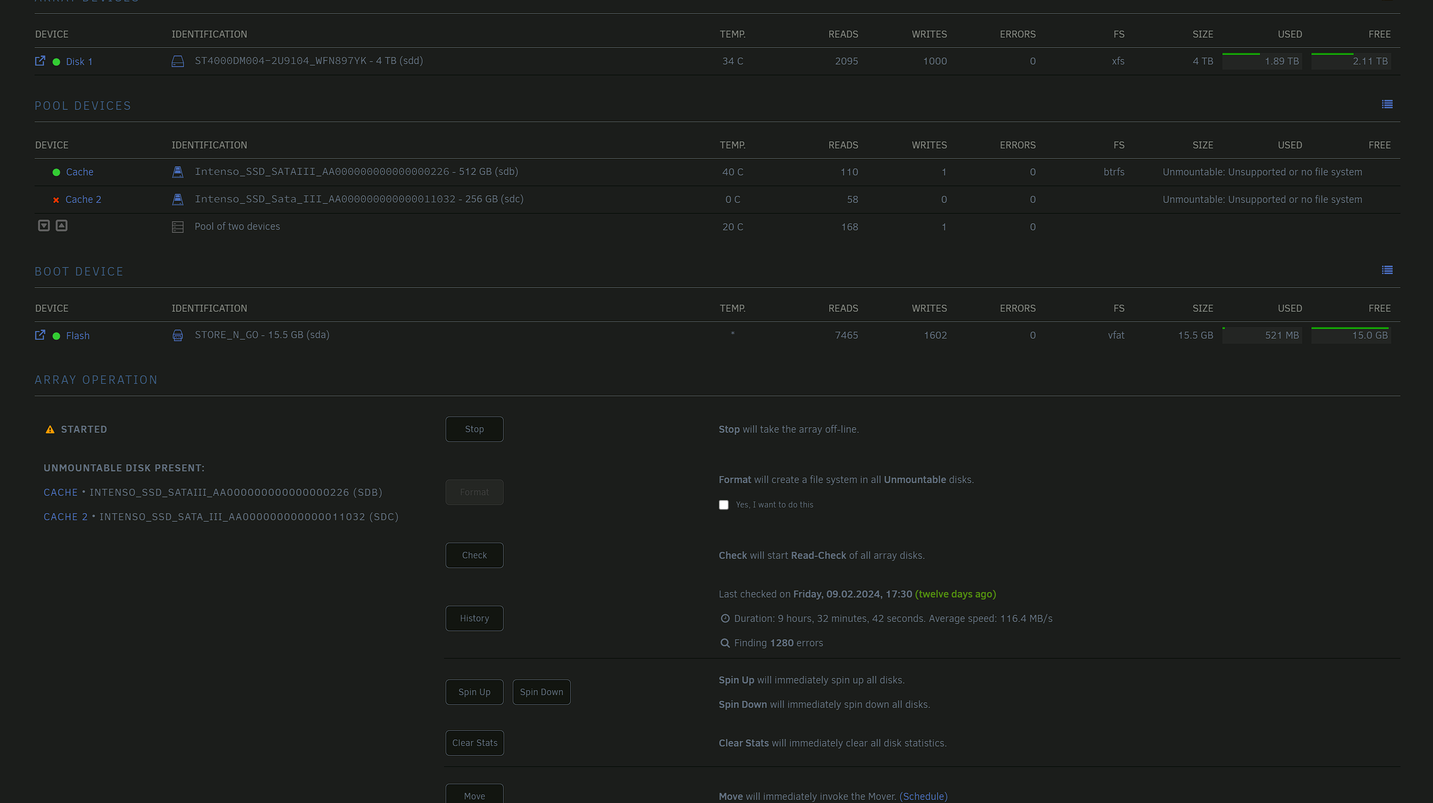

Ok after first formatting it looks like this
first got a file systrem but it doint format both and both are not useabel still
after second formating it keeps same picture

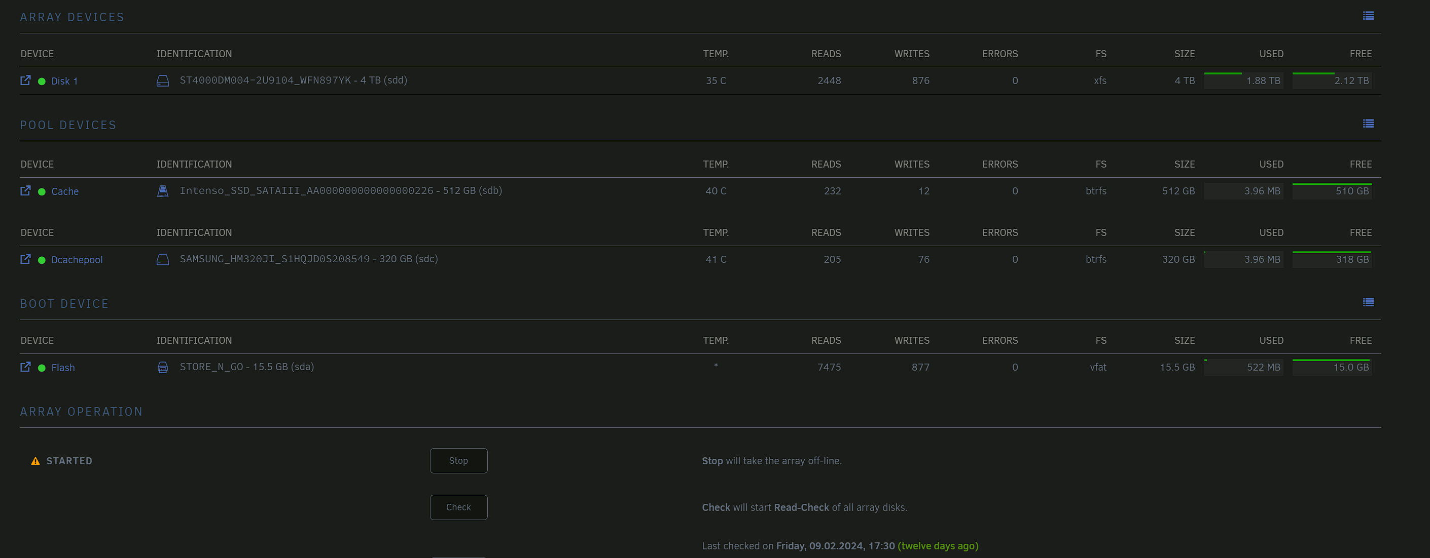

Ok i changed the one SSD that seemed to have errors and splited every ssd in a own cache pool
Now i need only to find out how to move docker on to cache again so it does not use Ram
i would liek to have docker on this 300Gig ssd and the VMs on the 500Gig SDD
