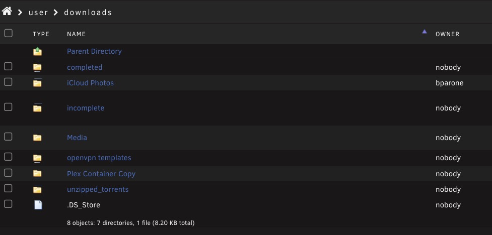

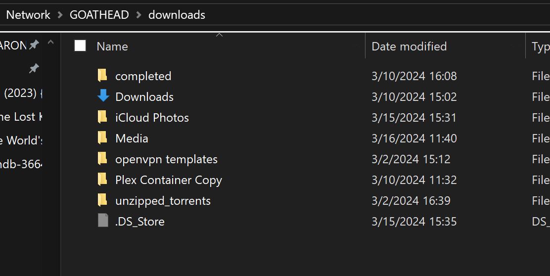

So check this out.  Below you can see 2 views of the same share, one being viewed in Unraid GUi and the other in Explorer over SMB.  The 'Downloads' folder is visible in SMB, but not in Unraid.  How can this be explained?  The share is public and all permissions are set to RW.  There must be a bug here.
