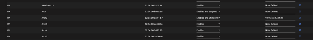

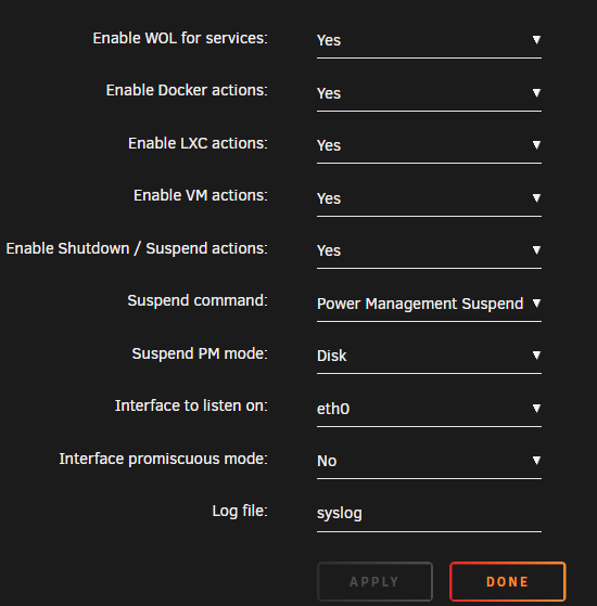

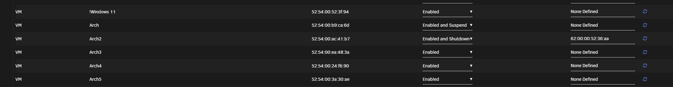

Have you enabled in the settings and then set the vm from enabled to the shutdown enabled option?
Yes, in the settings, I have enabled Yes on the "Enable Shutdown / Suspend Action".  Do I need to copy the "Suspend Command" setting as well? I didn't do that part.
No if using shutdown. But also goto tools->Wol 4 services and set the shutdown option against the vm. Will only be enabled by default. Needs to. be set to enabled and shutdown.

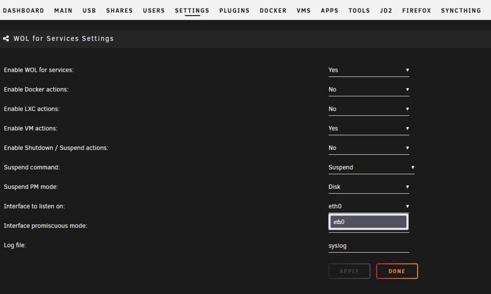

The plugin works as it should. I am almost only connected to my server via VPN, so the question is whether the plugin could be extended so that it can listen to other interfaces?
Like wireguard (wg0), for example.
Would it be possible to simply adjust the wol.cfg to achieve this?
The service probably needs to be restarted via the CLI?
3 minutes ago, Orkopaede said:
Thank you very much for your work.
So you want to have both wg0 and eth0 for example?
Not necessarily, but if there was a choice, it would make things even more convenient. For my specific case, wg0 or, more precisely, wg1 would be enough.
