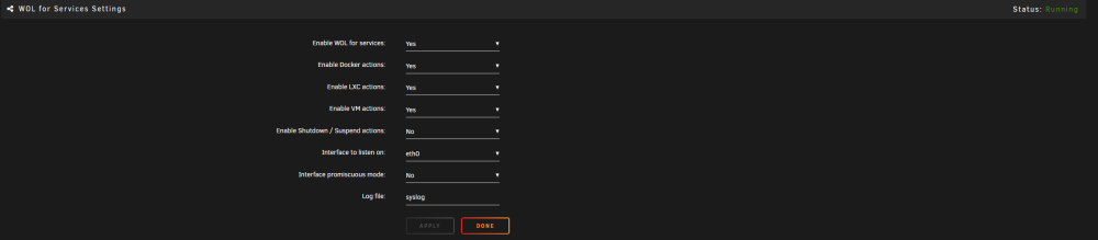

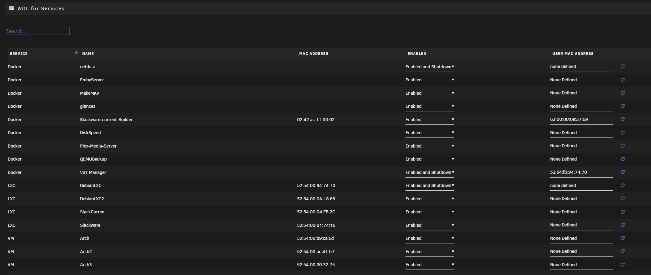

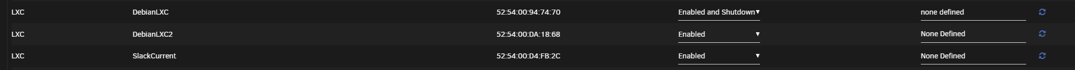

Two pages are created, first is the settings.
Within the settings you can specify which servers are enabled. The interface name needs to be a physical NIC. By default shutdown actions are disabled.
The second page is in tools. It allows you to specify the actions allowed. To be able to start dockers you need to have a user defined mac address as one is not assigned until the docker starts and changes.

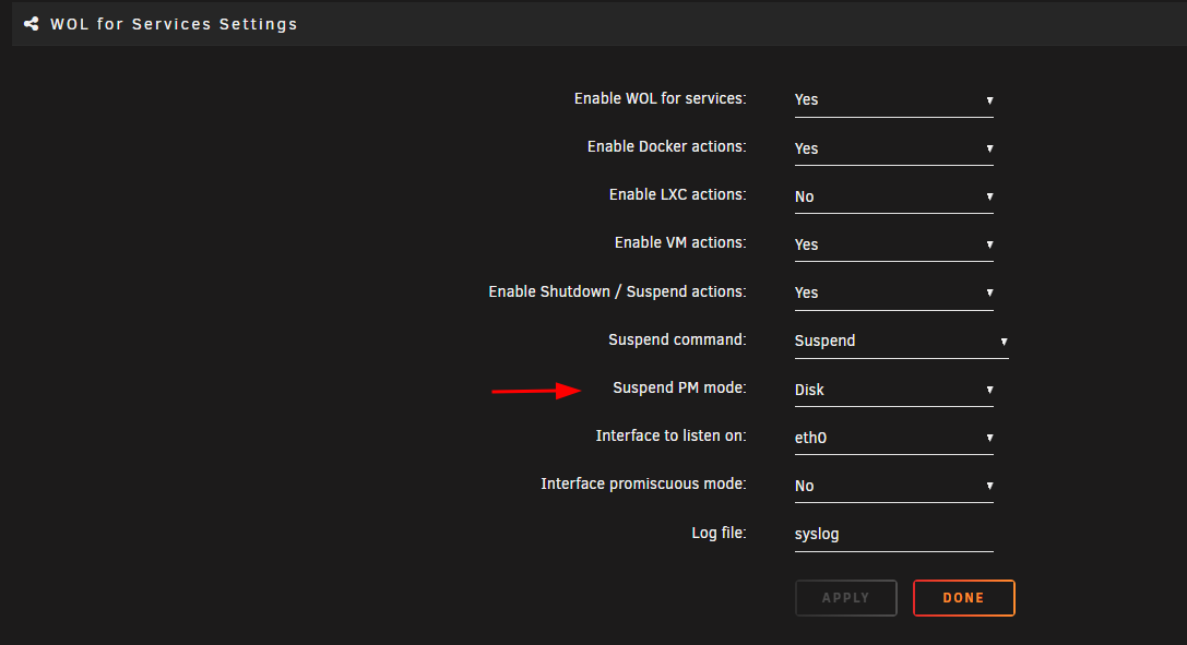

Give 2024.04.16 a try.
Suspend command is the virsh option either suspend or dompmsuspend(Power Management) and mode of mem or disk.

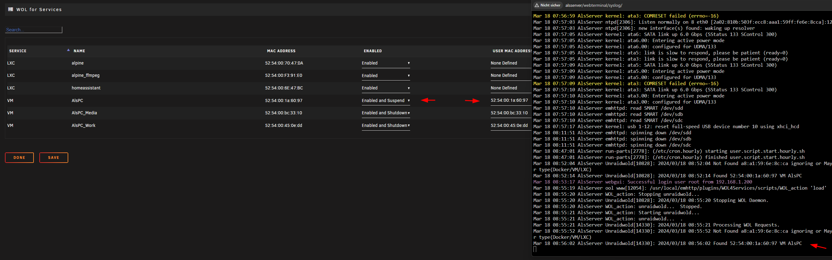

ok, tested here, no result at all on suspend, shutdown is working
here the syslog, triggered at 7.38 suspend, only info is "found ..." at 7.41 its triggered with shutdown and working as expected"
Apr 18 07:38:30 AlsServer Unraidwold[26302]: 2024/04/18 07:38:30 Found 52:54:00:1a:60:97 VM AlsPC
### this was with suspend, nothing else came into the syslog ...
Apr 18 07:41:04 AlsServer Unraidwold[26302]: 2024/04/18 07:41:04 Found 52:54:00:1a:60:97 VM AlsPC
Apr 18 07:41:15 AlsServer kernel: usb 1-12: reset full-speed USB device number 10 using xhci_hcd
Apr 18 07:41:15 AlsServer kernel: input: Logitech USB Receiver as /devices/pci0000:00/0000:00:14.0/usb1/1-12/1-12:1.0/0003:046D:C52B.00BD/input/input304
Apr 18 07:41:15 AlsServer kernel: hid-generic 0003:046D:C52B.00BD: input,hidraw1: USB HID v1.11 Keyboard [Logitech USB Receiver] on usb-0000:00:14.0-12/input0
Apr 18 07:41:15 AlsServer kernel: input: Logitech USB Receiver Mouse as /devices/pci0000:00/0000:00:14.0/usb1/1-12/1-12:1.1/0003:046D:C52B.00BE/input/input305
Apr 18 07:41:15 AlsServer kernel: input: Logitech USB Receiver Consumer Control as /devices/pci0000:00/0000:00:14.0/usb1/1-12/1-12:1.1/0003:046D:C52B.00BE/input/input306
Apr 18 07:41:15 AlsServer kernel: input: Logitech USB Receiver System Control as /devices/pci0000:00/0000:00:14.0/usb1/1-12/1-12:1.1/0003:046D:C52B.00BE/input/input307
Apr 18 07:41:15 AlsServer kernel: hid-generic 0003:046D:C52B.00BE: input,hiddev96,hidraw2: USB HID v1.11 Mouse [Logitech USB Receiver] on usb-0000:00:14.0-12/input1
Apr 18 07:41:15 AlsServer kernel: hid-generic 0003:046D:C52B.00BF: hiddev97,hidraw3: USB HID v1.11 Device [Logitech USB Receiver] on usb-0000:00:14.0-12/input2
Apr 18 07:41:16 AlsServer usb_manager: Info: rc.usb_manager  vm_action AlsPC stopped end -
Apr 18 07:41:16 AlsServer usb_manager: Info: rc.usb_manager VM Shutdown 001/010 vm: AlsPC
Apr 18 07:41:16 AlsServer kernel: vfio-pci 0000:05:00.0: vgaarb: VGA decodes changed: olddecodes=io+mem,decodes=io+mem:owns=none
Apr 18 07:41:16 AlsServer kernel: nvidia 0000:05:00.0: vgaarb: VGA decodes changed: olddecodes=io+mem,decodes=none:owns=none
Apr 18 07:41:41 AlsServer ool www[18465]: Successful logout user root from 192.168.1.130
Apr 18 07:41:49 AlsServer monitor_nchan: Stop running nchan processes

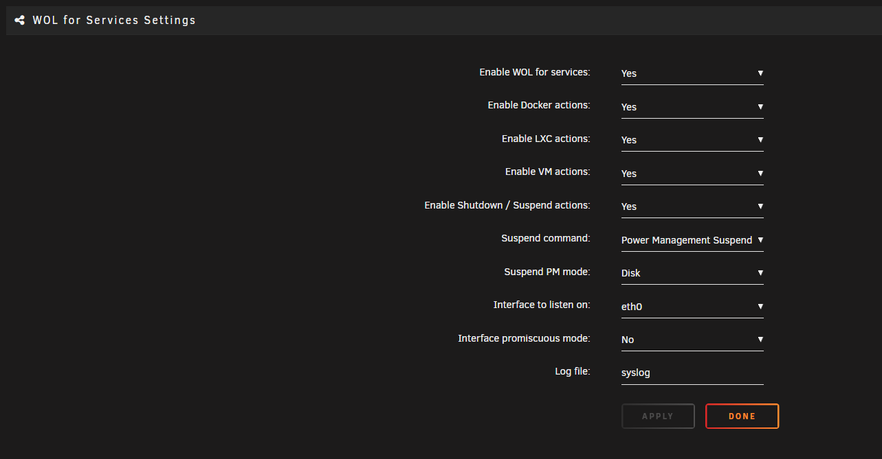

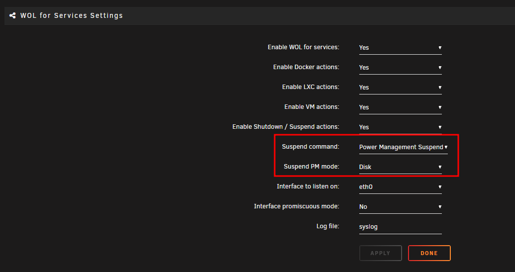

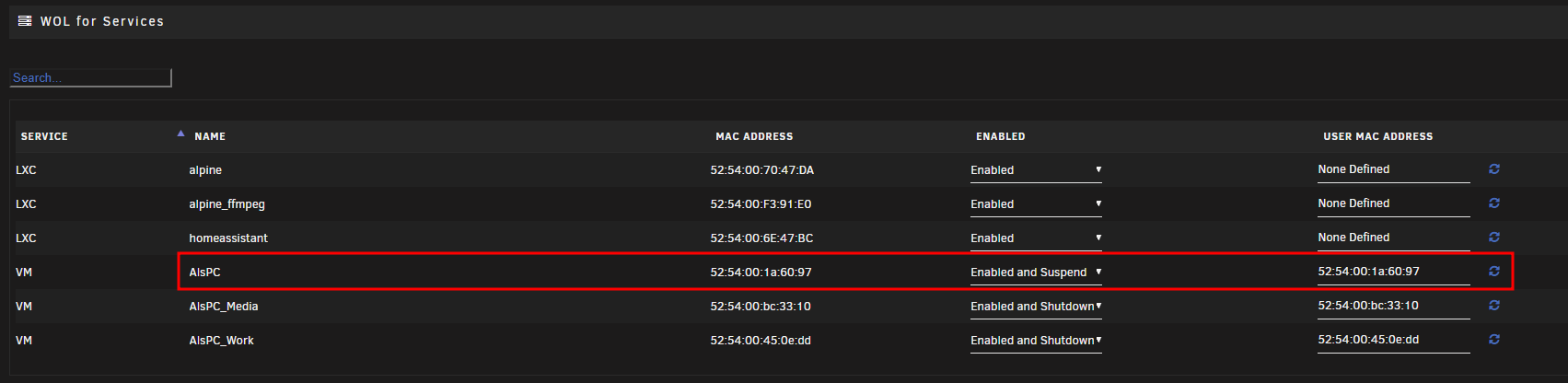

Did you change the option in settings to use Power Management Suspend? defaults to Pause. i.e. Suspend.
You can use this run manually. arg is the MAC if power suspend is enabled you should get the message below.
root@computenode:/tmp/lynis# /usr/local/emhttp/plugins/WOL4Services/include/WOLrun.php "XX:XX:XX:XX:XX:XX:XX"
Found XX:XX:XX:XX:XX:XX:XX VM Debian Suspend disk Domain 'Debian' successfully suspended
which option do you mean ?
i ll test it now manually ;)

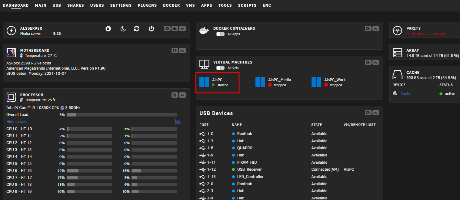

ok, current state on the VM Mashine is
root@AlsServer:~# /usr/local/emhttp/plugins/WOL4Services/include/WOLrun.php "52:54:00:1a:60:97"
Found 52:54:00:1a:60:97 VM AlsPC Suspend disk Domain 'AlsPC' successfully suspended
root@AlsServer:~#
so this worked out as it should ;)

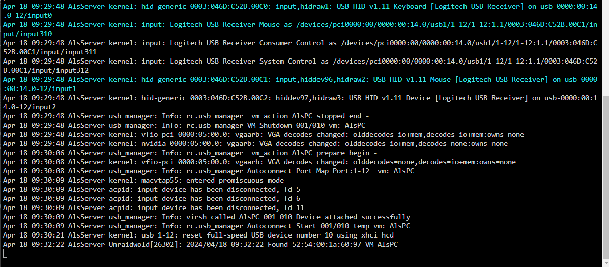

now i try to send a wol ...
i started the VM again, and send a wol request, my expectation, it should also suspend now, but after this log message ... nothing happens
so, manually triggereing the php call works, but triggered by wol it doesnt
root@AlsServer:~#
Have you tried disabling and then re enable service
of course ;)
