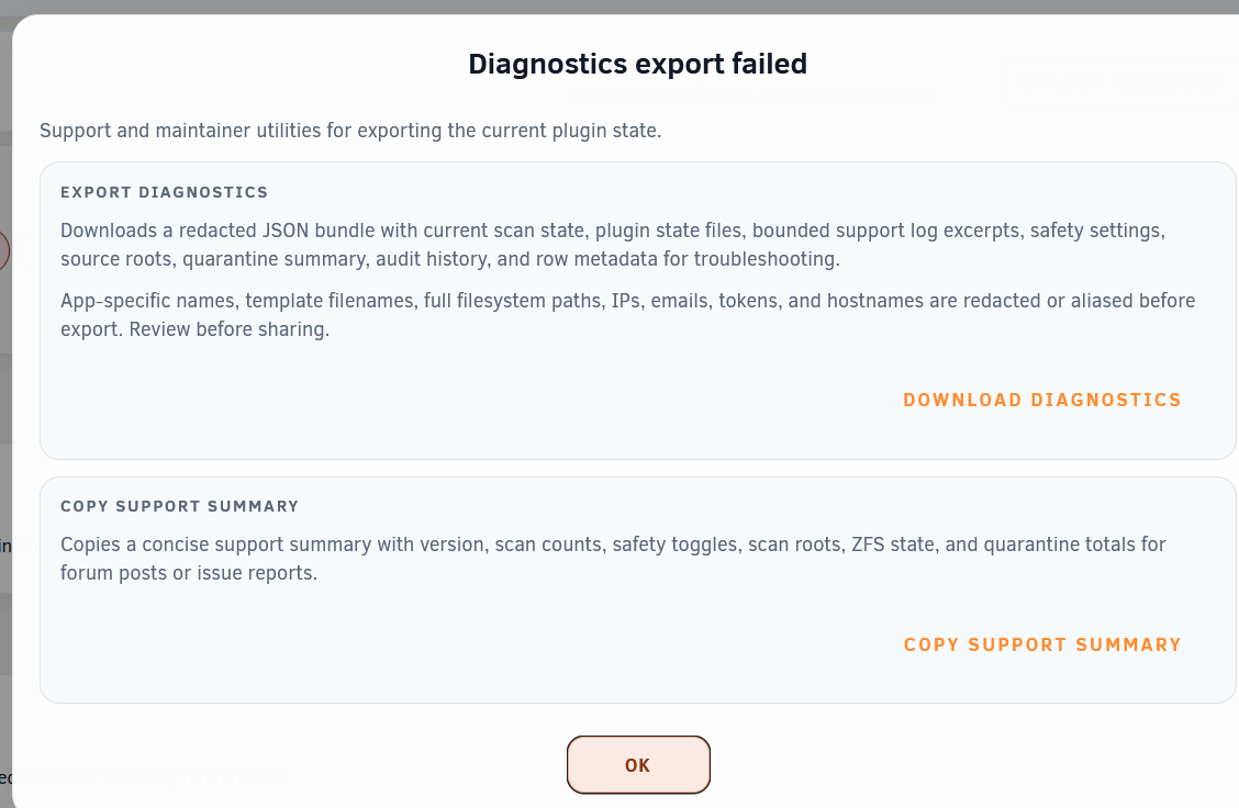

  2. Appdata Cleanup Plus support summary Version: 2026.05.04.07 Docker: running Rows: detected=4 ready=4 review=0 locked=0 ignored=0 Selection: 0 selected Safety: outside-share=off permanent-delete=off zfs-delete=off Sources: roots=1 mappings=0 ZFS: backed=0 mapped-share=0 Quarantine: count=0 size=0 B Scan roots: - /mnt/user/appdata I get quarantine failed and also export diagnostics failed.
  3. seeing same issue.

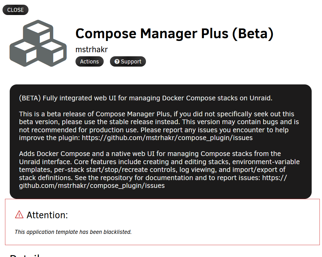

  4. I had to remove the official version. Then install the beta and then everything is back okay for me.
  5. Seeing the same issue. Also lots acces to al my stacks? Tried reinstalling but that does not seem to do the trick: Still seeing my files at /boot/config/plugins/compose.manager ...
