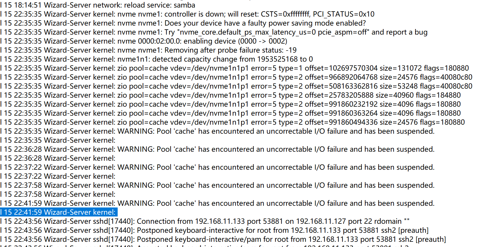

Does your device have a faulty power saving mode enabled? (NVME issues)

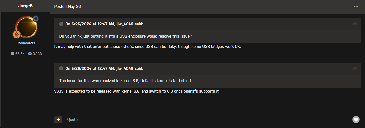

I'v read the post again, it seems the author didn't precisely located the bug. He just updated his linux kernel version from 6.8 (for unraid 6.12.10, linux 6.1.79) to 6.9 and the problem disappeared. I really doubt that the problem is caused by kernel bug and it will be fixed in unraid7.0 :-( By the way, i decided to unplug the 980pro until the final solution comes out. Fortunately the optane 900p aic still works well.
Encounterd similar problem, my hardware is maxsun w680 motherboard+intel 13500+samsung 980pro 1tb. " nvme_core.default_ps_max_latency_us=0 pcie_aspm=off " works well for 4 months on unraid 6.12.10, and it crashed several minutes age. Seems there's nothing i can do except waiting for unraid7 with newer linux kernel?
