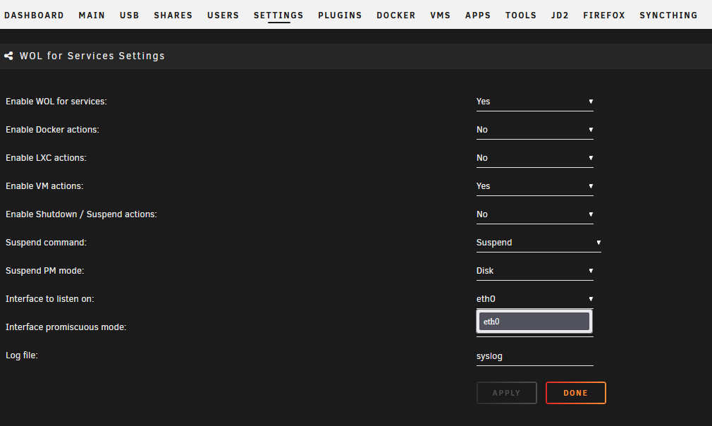

Not necessarily, but if there was a choice, it would make things even more convenient. For my specific case, wg0 or, more precisely, wg1 would be enough.
Does not wg0 show as an available interface in the settings page?
  • Replies 66
  • Views 17.8k
  • Open terminal.   cd /boot/extra if does not exist mkdir /boot/extra then cd to it. Once it is downloaded into extra will be loaded each reboot   root@computenode:/boot/extra# wget
  • Unraid uses the php api. I can look at managed save as a option which is hibernate to disk   libvirt_domain_suspend libvirt_domain_suspend($res) [Since version 0.4.1(-1)] Func
  • Hi I did a quick test on my test server. I dont use HA except for testing this is what i have added to my yaml.   wake_on_lan: switch: - platform: wake_on_lan mac: 52:54:00:DA:18:68
Unfortunately not, I have two active tunnels, could that be a problem?
You can update the value in wol.cfg and then do
/usr/local/emhttp/plugins/WOL4Services/scripts/WOL_action load
Which will restart the process with new interface. Will look to add more interfaces in the gui.
Great, it worked on the first try. Thank you very much for your help!

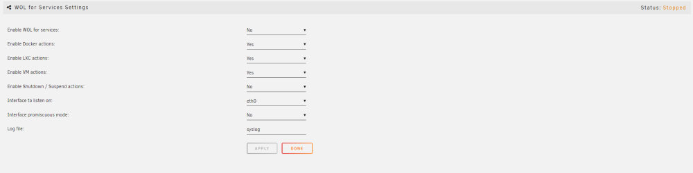

Not sure what's wrong, but is simply does not work at all.
First of all, I installed it in APPS.
It has: Status:Stopped
I've sent WOL both to the VM and eth0 which is configured as listening. Not working.
If the services is enabled should saying running.
what is the output of
cat /var/log/syslog | grep -i wol

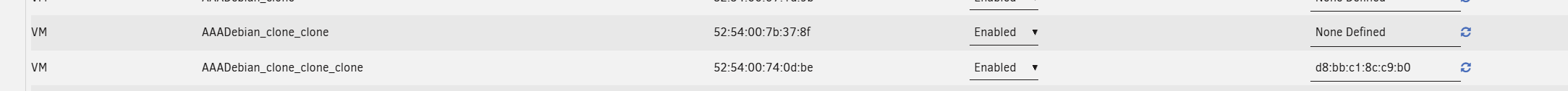

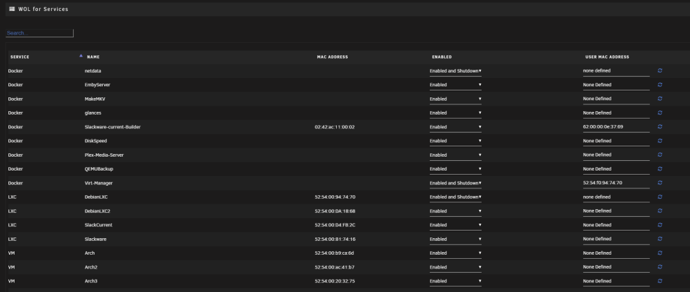

On 3/9/2024 at 9:23 AM, SimonF said:
This was a function being developed for the next release but was decided best to be a plugin to start with to allow better interations for changes. Currently this is a beta release.
the is an existing plugin called virtwold this expands on it to include dockers and LXC.
I am in the process to complete changes to make it work fully under 6.12 but currently the search function and help text don't work or don't exist.
Two pages are created, first is the settings.
Within the settings you can specify which servers are enabled. The interface name needs to be a physical NIC. By default shutdown actions are disabled.
The second page is in tools. It allows you to specify the actions allowed. To be able to start dockers you need to have a user defined mac address as one is not assigned until the docker starts and changes.
Awesome, it works great. Thanks, Simon!
