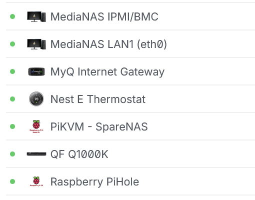

Identical on both PCs. The connected devices table from the UniFi router shows the following from all connected devices:
MediaNAS has two connections; MediaNAS LAN1 is IP address 192.168.1.10 (the Unraid server) of course, the other connection, as the name says is the IPMI LAN and has IP address 192.168.1.12
Whoa! This is a big issue. You can't have two computers with the same name and below is the AI take on restrictions:
I would suspect that the only the characters up to the first space (a DISALLOWED character) are being used for the computer name. Everything after that is ignored! So yes, you can get there via the IP address but \\server_name has 50% chance of failing! (I suspect one of these is the management port for the server's motherboard.)
OH . One more thing, The eight bit is masked. so Windows sees MediaNAS the same name as medianas as is MEDIANAS. I just tried this and it is still as trues as it was in DOS-3.2! Everything is still treated as through it is all caps. (Which is how DOS-3.2 stored file names as you may remember.)
Correct.
I'll try changing the name and report back. It's just a name alias in UnifFi Network. This is not an actual computer name in Windows to which I can see the above quoted rules applying.
Still baffled why there were no problems up until four days ago and is still works fine on other PCs.

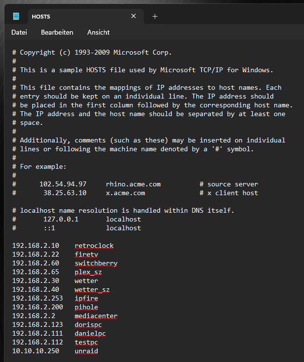

4 hours ago, Hoopster said:
The problem remains. I can now consistently connect to Unraid GUI/shares via IP address, but, not by server name.
Have you set an entry to the File "HOSTS" under Windows?
This is necessary to reach unraid over the name...
Edited by Zonediver
As mentioned above, I did modify hosts and that worked for a while in browser only. Several minutes later, the host became unreachable by name in URL and I had to return to IP address. Still stuck at IP address in browser and file explorer as the only way reliably connect to Unraid server or shares on this PC only.
When i use FireFox and put in "unraid/Main", Google comes up - so its not working for me too.
I use always the IP of my server.
So whats the purpose of using names, if the IP is working?
Also at my explorer - i use only the IP of my server - but i have two NICs, so i have to use the IP and nothing else...

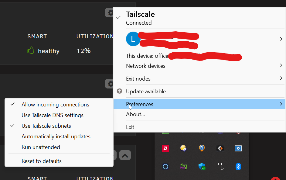

At long last I have identified the source of the problem and fixed it. I can't believe I did not spot this sooner.
Was it a big deal that I could only access the server and shares via IP address and not server name? No; however, I don't like unsolved mysteries and when this started happening four days ago and only on one machine, I had to figure it out!
  • I opened a command prompt and pinged the server by IP address. Success.
  • I pinged the server by name (medianas) and discovered that the reply was coming from the Tailscale network name for the PC on ts.net
  • I checked Tailscale settings on the PC and discovered that it was still connected and was using Tailscale DNS which appends the Tailscale name to the server name
  • I disabled Use Tailscale DNS settings (of course, I also could have just disconnected from Tailscale)
Now I can access the Unraid GUI and Unraid shares by server name in browser, Windows File Explorer and my third-party file explorer (Directory Opus). Of course, IP address continues to work without issue.
The two PCs from which I had no access problems are not connected to the Tailscale network so it was never an issue for them. I have no idea what changed four days ago on this PC as it was working before and it has been months since I did anything with Tailscale on this or any other PC.
