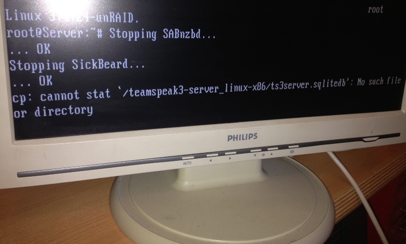

edit: OK, I know what the problem is now: The database is not storred when teamspeak is stoped together with the array. BUT: When I select Enable - No and the script stops the server it is storred correctly....
Maybe here is something that can help you to solve the problem: A screenshot from the actual console when the array is stoped:
I think I have found the error, I shall patch and upload tonight

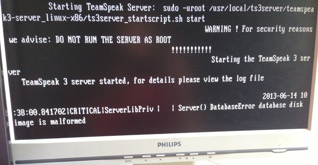

I also got an error with your latest plg file. There seems to be something wrong with the database image. I attached a picture of what happens at system start.
The web interface says teamspeak is running but i cannot connect. I even deleted the settings and tried to reinstall but it wont give me the token, cant read the log file or something...
