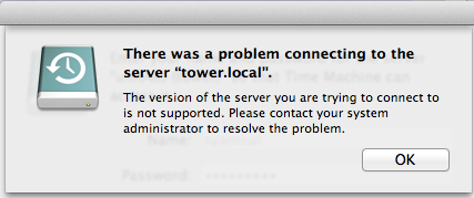

Time Machine was working fine for me until two weeks ago... now when I try to backup, Time Machine gives me the following error...What is wrong and how do I fix it?
There was a problem connecting to the server “Tower.local”.
The version of the server you are trying to connect to is not supported. Please contact your system administrator to resolve the problem.
I am using OSX 10.7.3 on an early 2011 Macbook Pro...

I am also getting the same problem as jpark31 and I get this on all 3 of my Macs, running OS X 10.7.3.
Can anyone advise? :'(

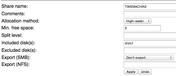

I agree too. I tried restoring an entire volume using the "Recovery HD" volume (press "Alt" when start iMac) from OS X Lion 10.7.3 and selecting "restore from Time Machine". No luck  :(
I saw the message "There was a problem connecting to the server “Tower.local”. The version of the server you are trying to connect to is not supported. Please contact your system administrator to resolve the problem." (login is guest with blank password).
I turned off sharing the Time Machine folder on unRAID, like on the picture "Disable_SMB_share", then restarted unRAID. No luck.
I stopped the samba and nfsd daemons on unRAID via telnet by commands:
/etc/rc.d/rc.samba stop
/etc/rc.d/rc.nfsd stop
No luck  :(
I hope that my experiences will help fix the "entire volume restoring" trouble.
Excuse me for my english.
