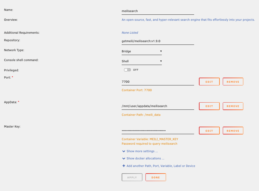

Hey there,
today I had set up hoarder and everything works except meilisearch.
If I'm giving meilisearch a fixed IP it won't start (shuts down immediately), I can't connect to it, and in the docker dashboard there isn't shown the IP I assigned.
But when I'm set the network type to host it shows the IP on the dashboard, but I can't connect too.
I can't see any of the logs because it immediately shots down after starting.
Do you guys know, what I'm doing wrong?

1 hour ago, Jaeggrono said:
Hey there,
Thanks and best regards!
In your Unraid terminal, type `docker logs meilisearch` and then paste the logs. That will give us more an idea of what is going on.

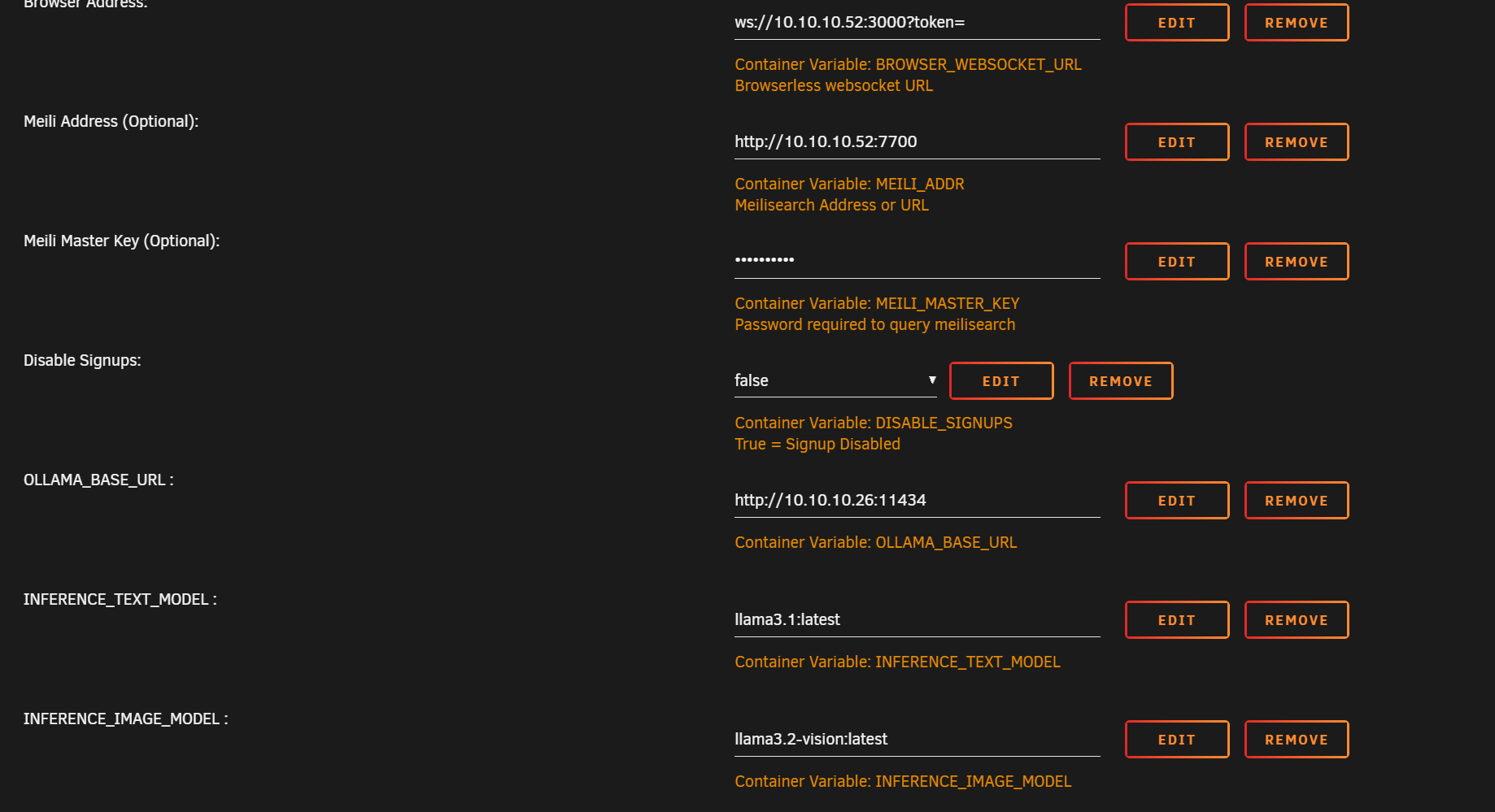

HI,
I can't seem to connect to Ollama with the new version of the app. I get the following error:
(Use `node --trace-deprecation ...` to show where the warning was created)
s [TRPCError]: No inference client configured
    at /app/apps/web/.next/server/chunks/1479.js:1:31491

I can connect to Ollama through VSCode on another machine on the network so I think that is unlikely to be the problem.
Also attached my configuration for the container. Any points appreciated!!
Edited by Ascari
Generally that error is caused by a misconfigured variable, although I cant see anything at first glance. Are you able to ping the Ollama instance from inside the Hoarder container?
I think that was it. I re-added all the Ollama related variables to the config and it started working. Thanks!

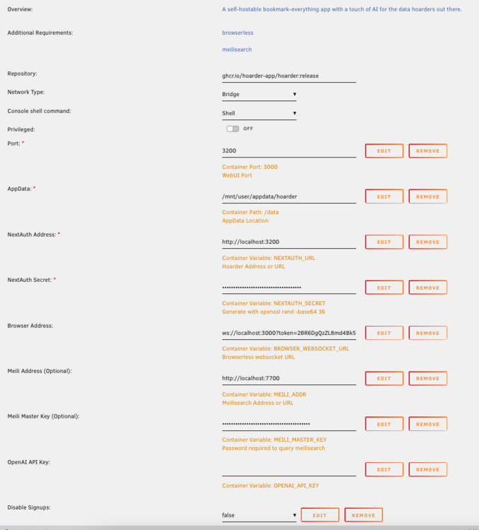

3 minutes ago, tvmainia said:
hi and thank you for making this tool available in Unraid.
I can't get it working. Today was my first time to try it.
Links do not get processed, when i go to search bar, i get, "Something went wrong."
Any ideas where I went wrong?
Thank you.
Could you please share screenshots of both your Hoarder and Meilsearch configs?
yes, of course! Thank you!
initially I had something on port 3000, uninstalled it. The hoarder gui works fine on ip:3200.
When I attempt to add links, they do not get processed
Great, thanks for those. Since you are on the bridge network, change both the Meiliseach and Browserless address from `localhost` to your Unraid machine's local IP address. Leave NextAuth as is.
PROGRESS! Links are being processed now.
Search still doesn't work.
