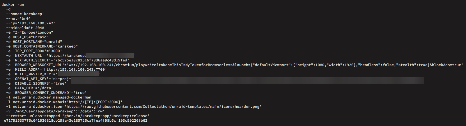

I have move to the browserless v2 image, but I think the only issue is the karakeep url for the browserless connection.

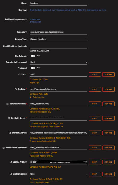

here is my Karakeep setup

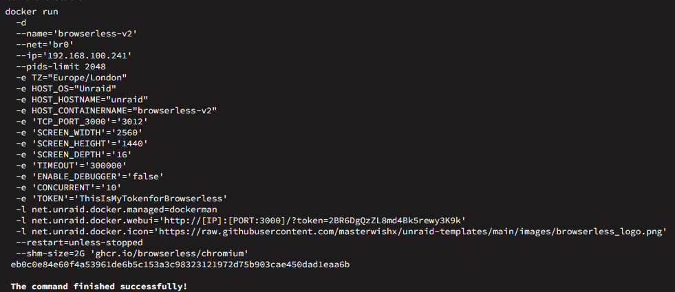

and here is my Browserless-v2 setup

Hi @Slothy2406
You need to add the port on the BROWSER_WEBSOCKET_URL - i.e. ws://[IP]:[PORT]/chromium/playwright?token=[TOKEN]
I'm not sure on your IP setup, but it will likely be port 3000 or 3012, so ws://192.168.100.241:3000/chromium/playwright?.....
You also have a typo later on in that URL - its playwright, not playwrite
Edited by traynier
