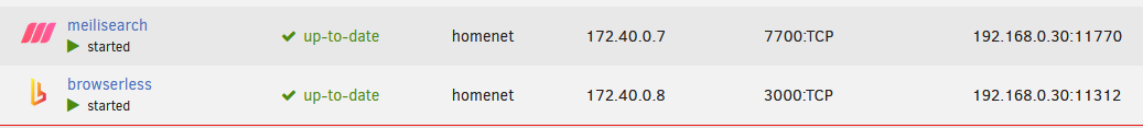

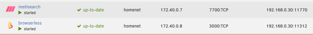

I'm setting Karakeep for my family, since Pocket is closing down, and I'm having a hell of a time getting browserless to work.
2025-05-24T10:48:34.992Z info: [Crawler] Connecting to existing browser websocket address: ws://browserless:11312?token=ORckYQ3AW06NpAw
2025-05-24T10:48:34.994Z error: [Crawler][2016] Crawling job failed: [object Object]
I set browserless-v2 and changed the name (removed -v2) and the port to an arbitrary one since 3000 was already used and token matches, so I don't know why it's not crawling correctly.
Edit: Changing it to IP:PORT instead of the name of the container made it start working. Why wouldn't the container name work? We'll never know... I suspect my docker is cursed. 🥲
I'm not sure why that is the case. I'm using the docker name as well in a custom network and it works as expected.
I'd understand them not working if they weren't in the same network, but they are... I've had issues with docker networks before so I'll blame it on that.
