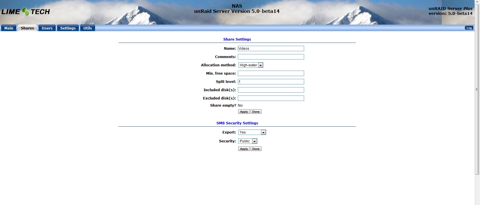

Maybe its because of my share settings? I even tried without Switch between Client and Server... same shit.
Please check my settings, maybe you find something useful.
Best regards,
Gery

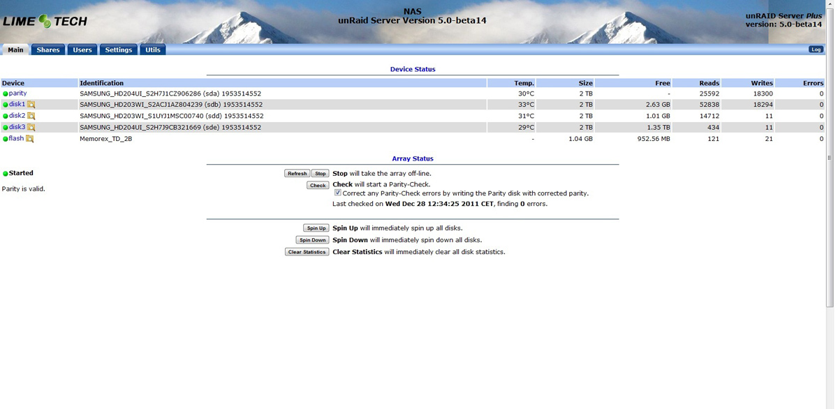

Here is a pic of my free space. As you can see... on disk 3 i have plenty of space left.
Best regards,
Gery

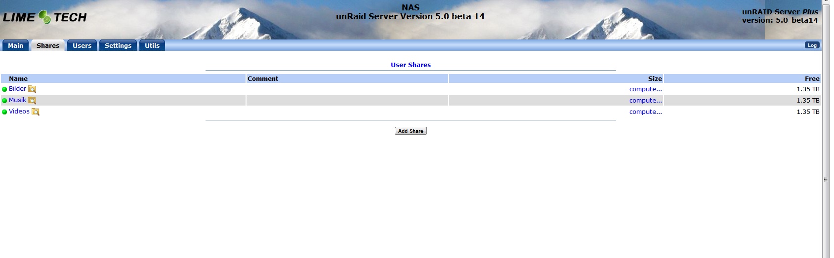

And here are my shares.

The only thing i can think of is that unraid tries to copy to disk1, and there is not enough space left.
When i leave the "included disks" field empty, unraid should use all disks, right? Another question is, what will happen to my Video files which are already on disk1 when i set "excluded disks" disk1???

how much ram do u have installed?
your split level & directory structure and other parms can affect which disk data is written to.
during the copy, watch the disk activity (unmenu-> disk performance, for example) to see where the data is going.
hope this helps,
steve
Hooray!
Thanks to everyone. It was my fault, the correct split level for my file structure was 2, i set it to 1 and unraid tried to copy to disk 1, where is not enough disk space left.
Thanks, thanks, thanks!!!
